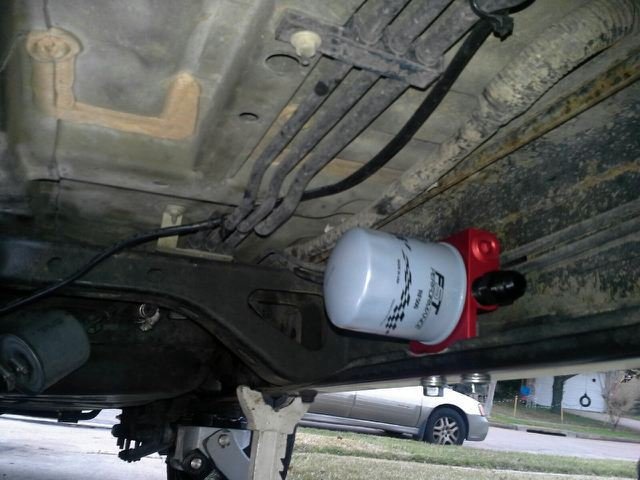

    I went big dog and did the Aeromotive 340 Stealth pump rated for e85 and ditched that garbage inline filter that comes with the kit for a 100 micron Canister filter with a replaceable element.

    Where did you mount the filter?

    Frame rail I'm assuming.

    I actually like it being out of the tank.

    Probably something along these lines.
