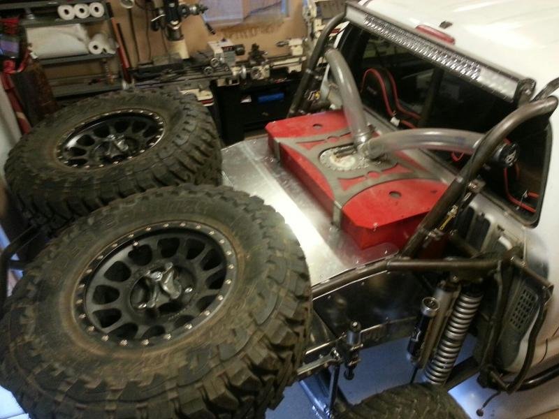

    fuel cell has been in for awhile. I have a 32g Jaz cell mounted directly behind the cab retrofitted with the OEM pump assembly. This was before we ran the fuel lines and venting

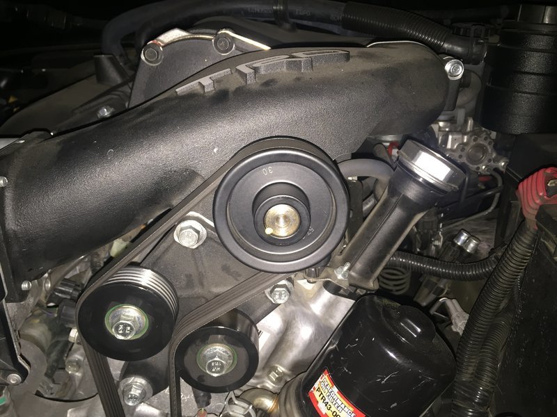

    Put a dab of thread locker on the new pulley today, looks pretty factory to me. Washed and waxed while I was at it.

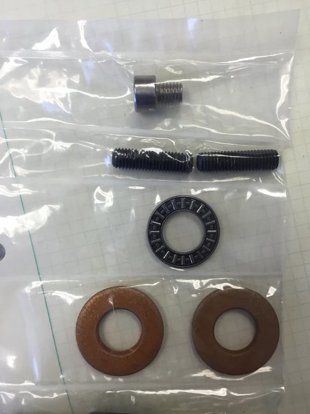

    Got my pulley today! So I'm reading the instructions. Did the rest of you have the engine cold before installing? I was going to drive to my buddy's house so he could assist.
    Also, install institutions reference a 8x1.25x20mm I got the install kit and I don't see this item.

    What about the 8x1.25x20mm socket headed cap screw referenced in step 3? Is that the small screw in the top of the package? I wouldn't have called that "socket headed", but I'm sure I don't know the right word.

    That's definitely a Socket Head Cap Screw (SHCS).
