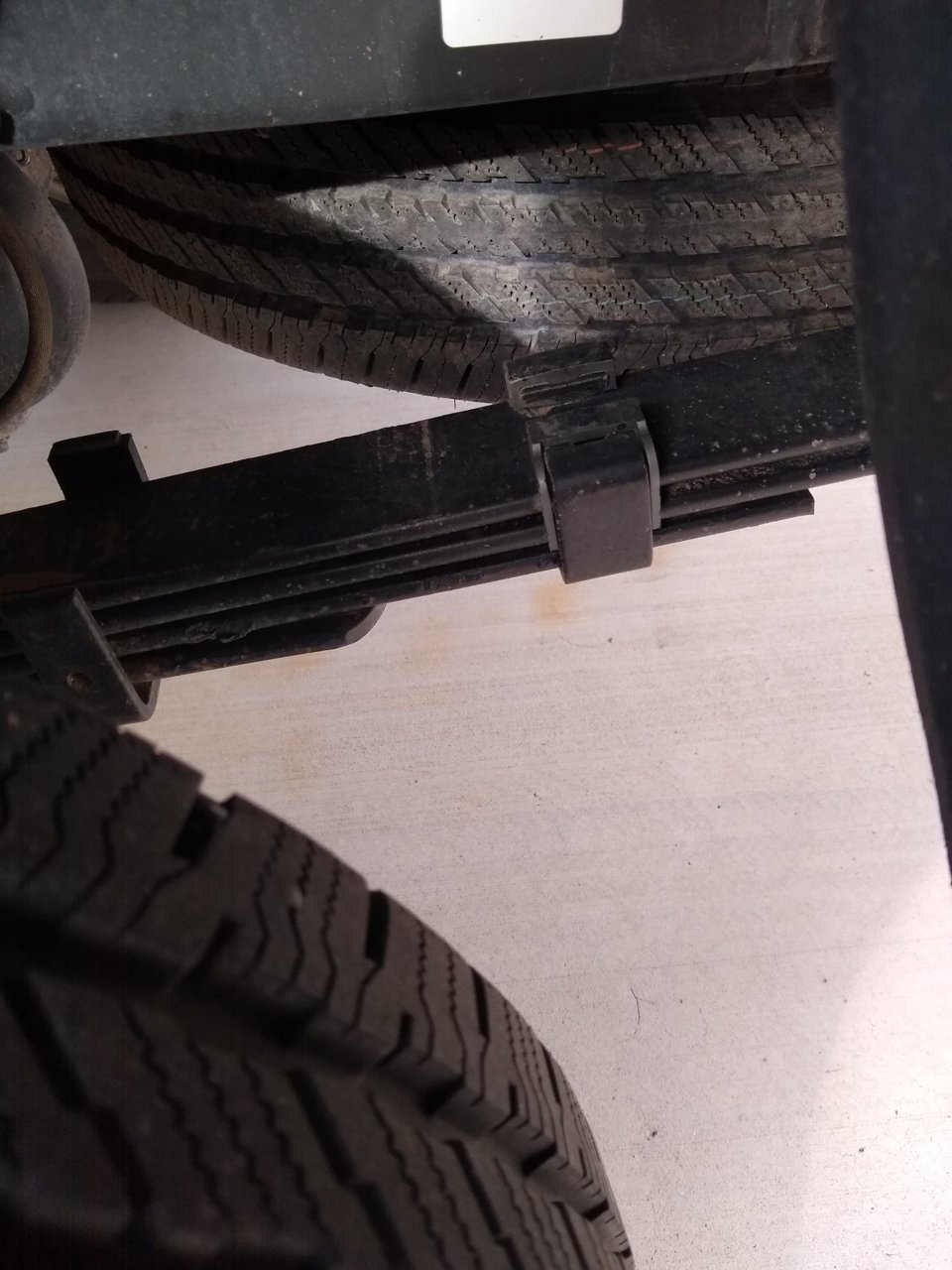

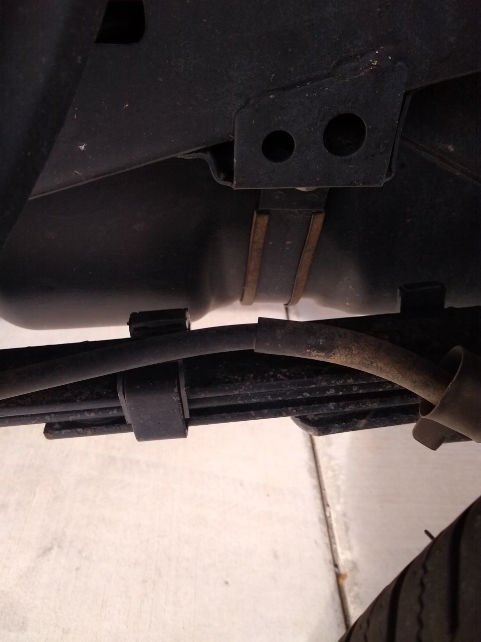

    Sounds like the leaf packs could be replaced then. When you have the chance, you could post a pic of it!

    Thanks man, but I was particularly referring to a pic of the leaf pack themselves lol

    when I take the wheels off then I could post a pic .. that might be a while.. the left side is flatter than the right side.. however it is not going reverse arc..

    Gotcha. Also curious to see how many leafs you have. Off-road models should have 3 plus 1 overload. If you have less than that then it oughta be worth finding take-offs!

    You’ve got the 3 leaf plus 1 overload. If you don’t plan on towing or hauling, you could go with cheap, low-mileage leaf pack take-offs to lessen the lean. I’ve got a full replacement leaf pack and still have a lean. I don’t tow, rarely ever haul anything either.
