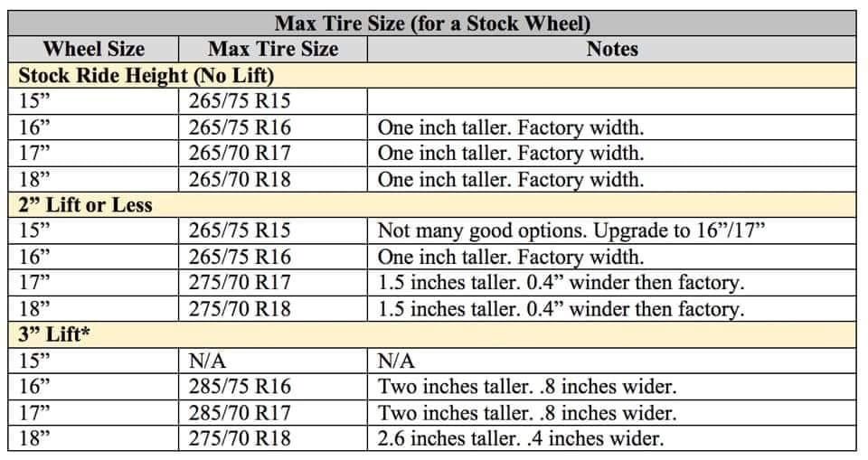

    TT005
    TT005 Well-Known Member
    Sep 23, 2017
    #230843
    1,415
    NC
    2023 SR5 DCSB 4X4
    Tocamo and Odlcjro01 like this.

    Nice! That’s great info. Thank you

    Great chart. Thanks for sharing.

    Like the chart.

    Here is the other chart. I forgot to add it.

    Doesn't the offroad factory wheel have a +25 offset? I think +13 in the wheel chart above is incorrect.
