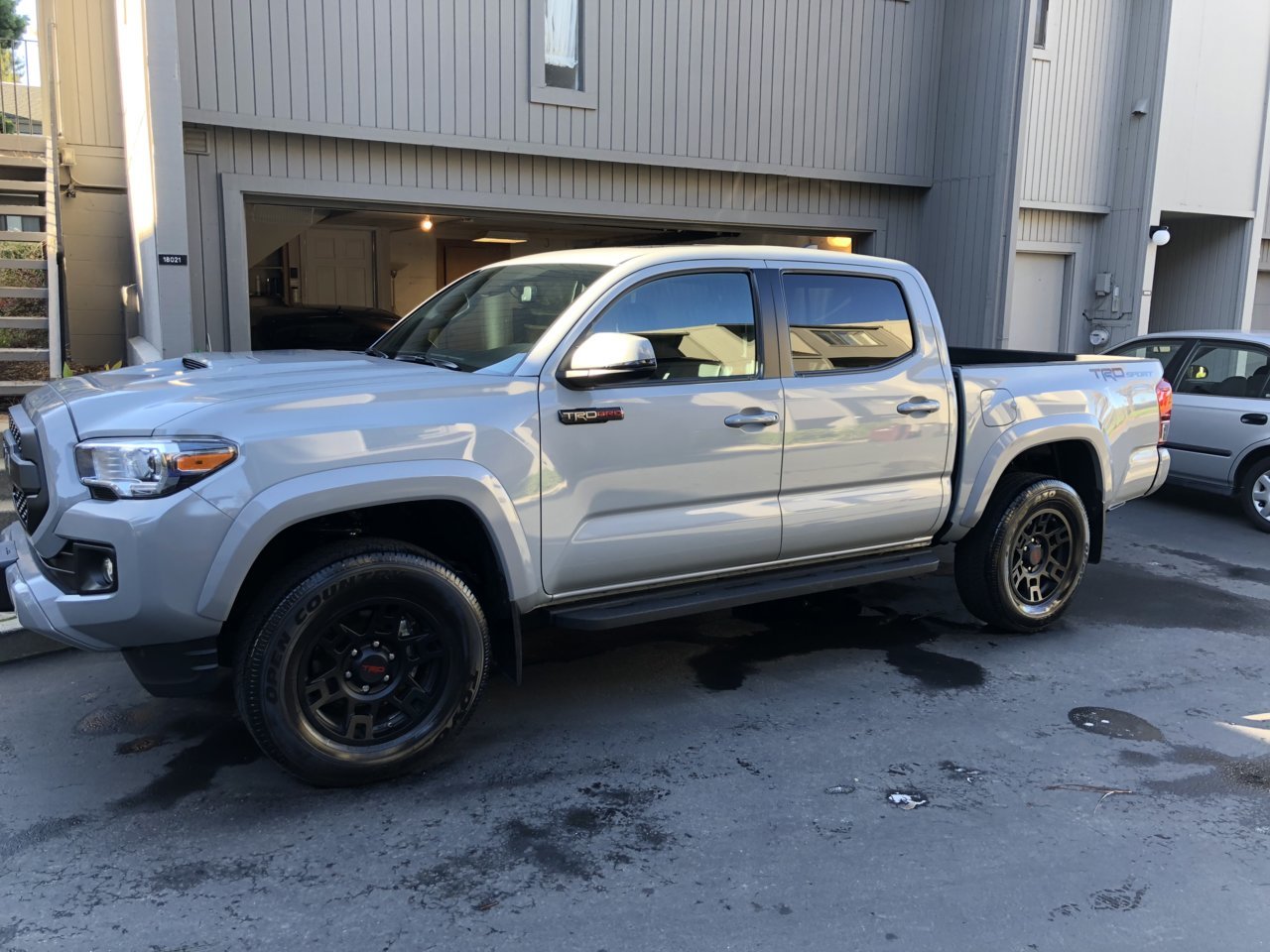

    I did the direct swap from my stock wheels to the sema wheels with the same tires. No issues in terms of throwing off the speedo or anything. When you go beefier tires though, that’s when things will change slightly

    Bilsteins 5100s on the top setting, 4runner Gray TRD Pro Sema wheels, 285/70/17 Toyo AT3s, Sumo Bump stops, TRD exhaust, ECGS Clamshell bushing, 1/4 shim for the lean and one inch rear block, OEM Pro grill and garnish OEM TRD Skid plate, TRD CAI, Demon Brackets, Rigid Industries Pro fog lights, OEM Trail Rails sidebars, Diode Dynamics LED SL1 high and low beam lights, OEM Roof racks, Clazzio leather heated seats, Remote Start, TRD Pro shift knob, tinted windows, Rockford Fosgate 4 channel amp for the headunit and sub and amp combo, OEM Puddle lights, OEM tailgate lock, OEM bed mat, LED interior lights, OEM blackout kit for letters, JLT catch can, upgraded 27F toyota True Start battery, Vleds led tail light kit with Pro tail lights, OEM Rave4 side mirrors with convex spotters,just to name a few mods.
    Check your speedo again your phones gps as mine was off a little with my stock 265/65/17 sport wheels. Got new trd pro Sema wheels and tires. I . running a 265/70/17 SL rated Toyo open country at2 and the speedo is now perfect against the GPS. Now gas mileage is the same since I'm running a light tire and lighter wheel. My mpg stayed the same. Plus the 17 inch offers a lot more tire choices.
