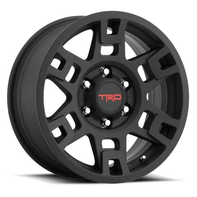

    This should be an easy one, but couldn't find the answer..
    If I have a stock 2015 Tacoma, and I want to buy (used) the 17" TRD Pro wheels that everyone has, will I need to lift the truck? Currently, I have a new set of P265/70 R16 winter tires that I want to continue to use come winter.
    Thanks,

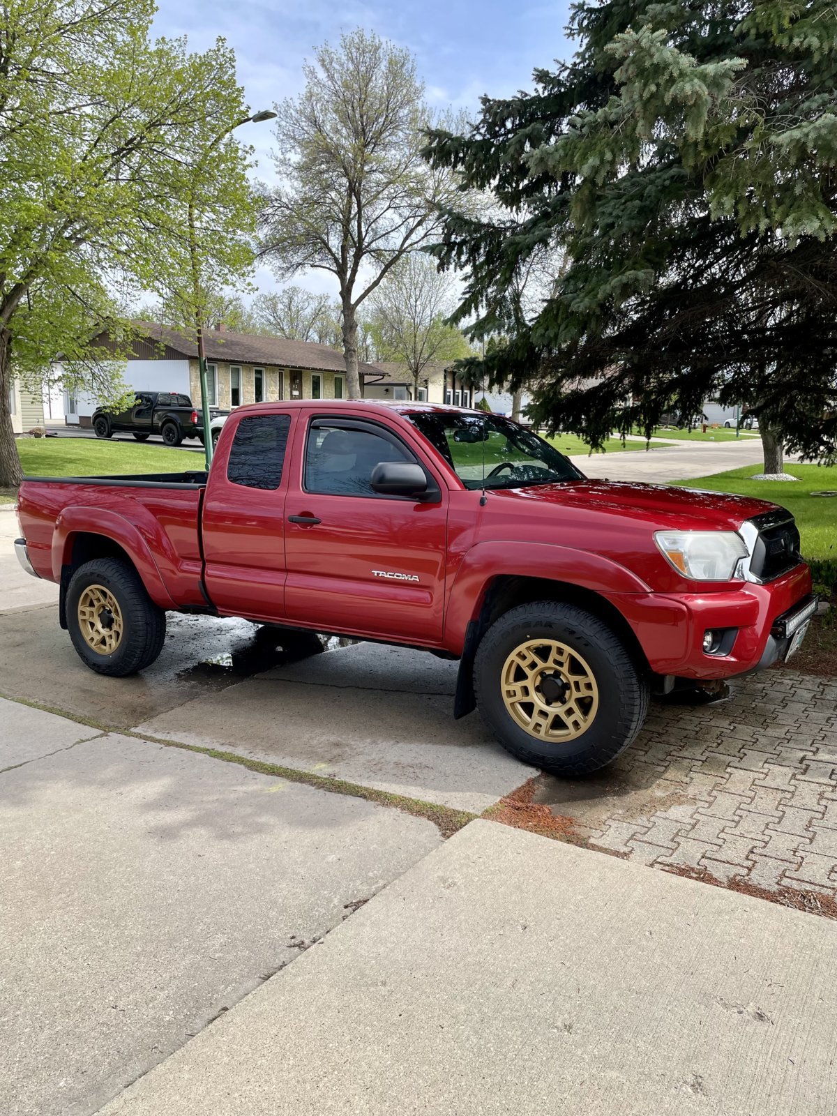

  9. Jul 16, 2024 at 4:56 PM
    firsttimer011
    firsttimer011 [OP] Member
    Jul 16, 2024
    #453439
    5

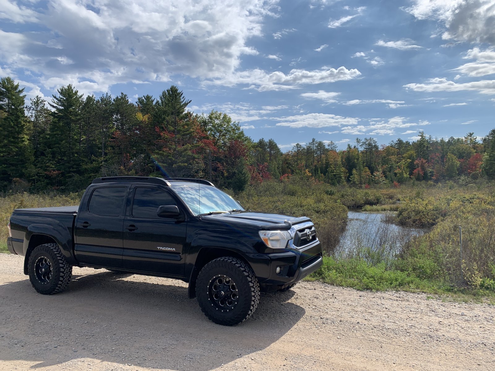

    2013 Tacoma
    I run 265/75/16 and they fit fine, no lift just 3rd gen springs IMG-2425.jpg
