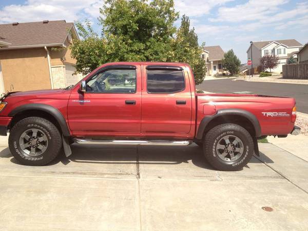

    I have a 2002 tacoma prerunner and i want a set of TRD wheels. But everything online says "only for years 05-12". I have 16" wheels, so if i purchase a set that isnt for my year truck specifically will they still fit?
    I am looking into these:
    [​IMG][​IMG]

    They will fit.

    What is the BS on those wheels?
    BS on 2nd Gens is 5.25" & on 1st Gens it's 4.5".
    I run 1st Gen TRDs on my 2nd Gen without a problem (moves the wheel & tire out .75").
    Running 2st Gen TRDs on a 1st Gen could be a problem (moves the wheel & tire in .75").

    They fit fine, although if you try and run 285s you'll rub on the frame.

    They will fit fine. If you're lifted, you will probably want to use adapters to push them out to get a more aggressive stance.
