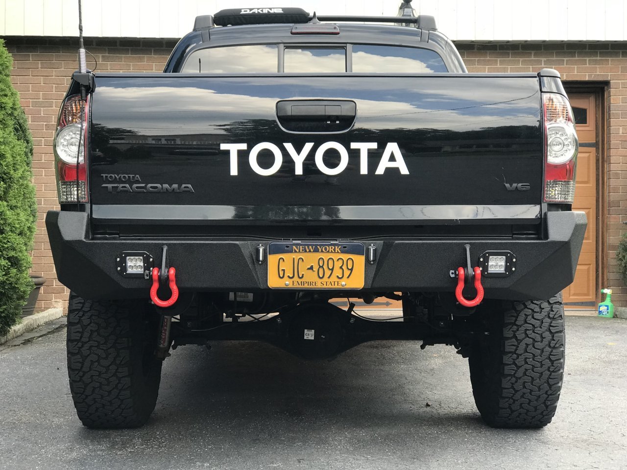

    Nice build so far! How was the fitment on the ebay rear bumper?

    It’s basically a knock off version of an all-pro bumper. It comes in two pieces the top piece fit like a glove and took no longer than 15 minutes to put on but the bottom piece gave me some trouble and that took about an hour or two. The bolts connect where the sway bar does and it was difficult trying to catch the thread between the sway bar and bumper brackets together but I’ve also heard that depending on the truck (and obviously having your sway bar or not) some people have had some trouble and others not. One modification I had to do was cut a 1”x1” hole if you will so I don’t damage the AC line. Other than that it was pretty easy to install. The welds are done properly, powder coat finish, pretty strong bumper I’ve been banging it off rocks wheeling and winching out no problems as of now. It also fits the all pro skids so that wasn’t a head ache either thank god!

    I just realized you asked me about the rear not the front that one fits great man no complaints. I just really wanted the high clearance with the swing out gate and I got a great deal on it so I sold my eBay rear.
