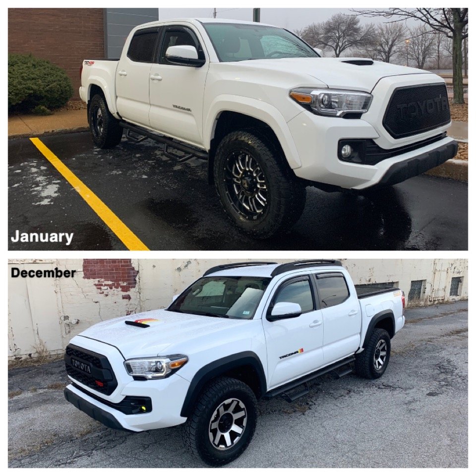

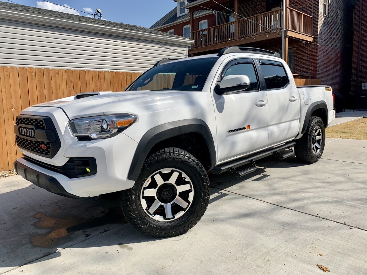

    December 23rd, 2020
    OEM roof rack and a little bit of new color.
    I really liked the retro color scheme against the white so I continued that theme in a few other areas. I’ll drive it for a bit and see if I’m happy with the look. If not I’ll just peel it off.

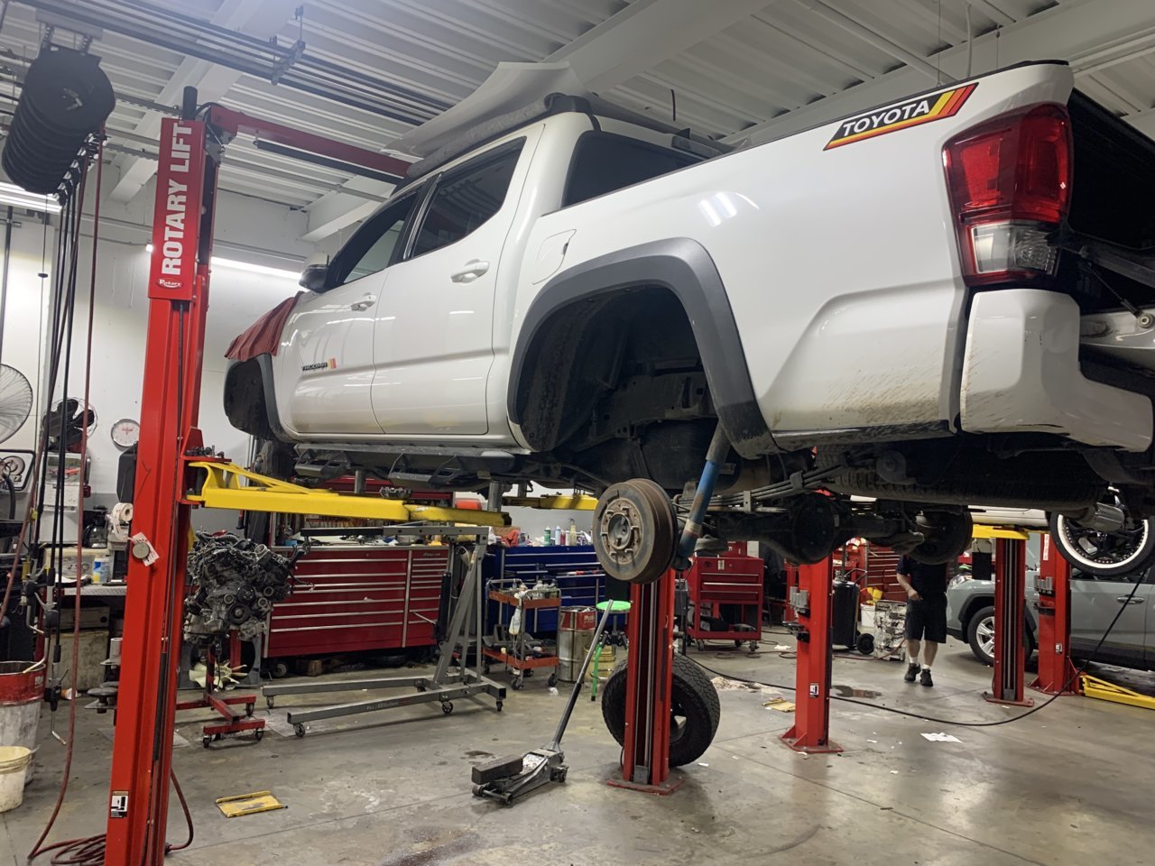

    July 27th, 2021

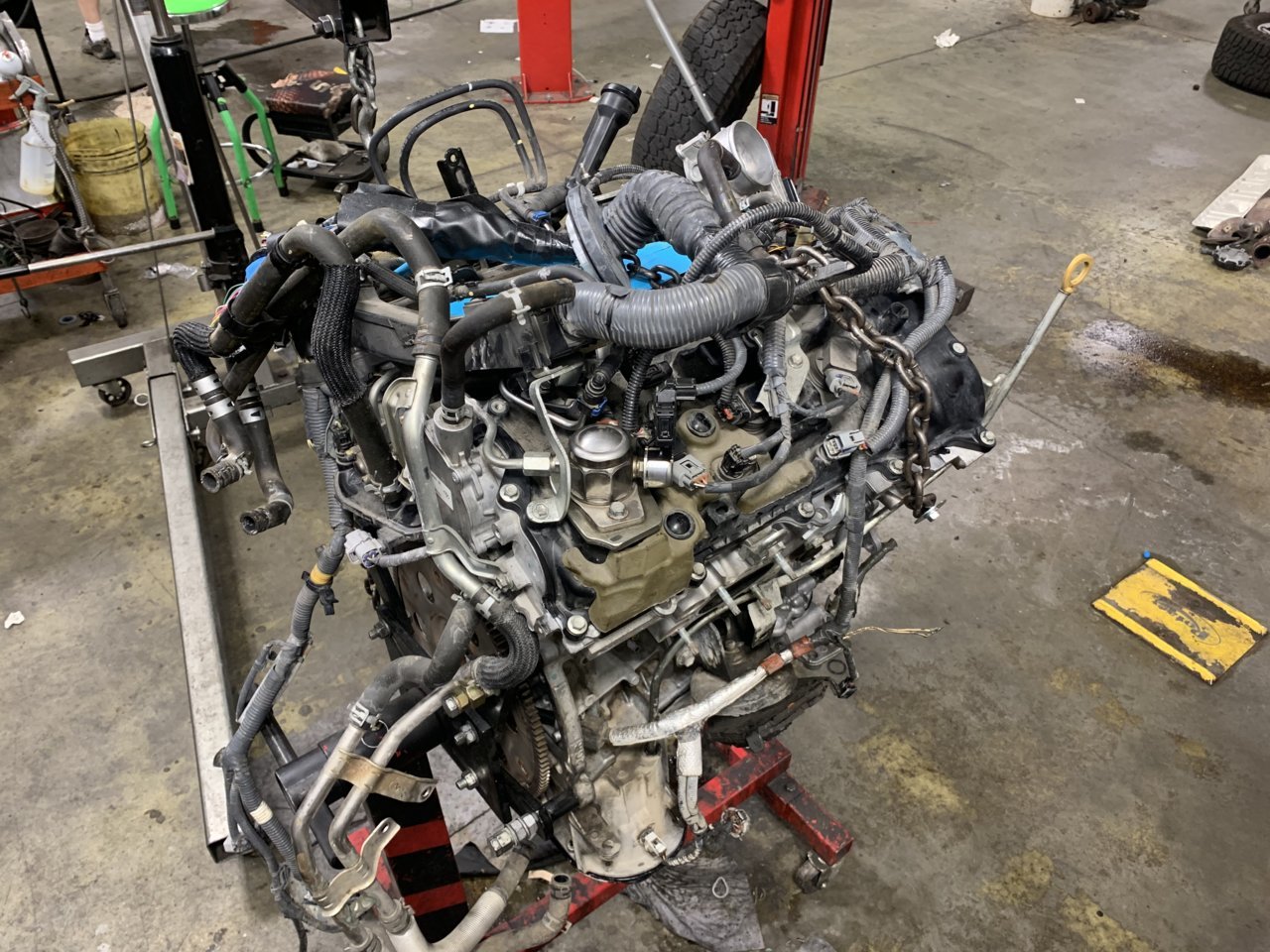

    New timing chain cover, water pump, drive belt, spark plugs, rear main seal, and exchanged every fluid. I’m hoping I can still find the time (and money) to get my suspension done before the winter.

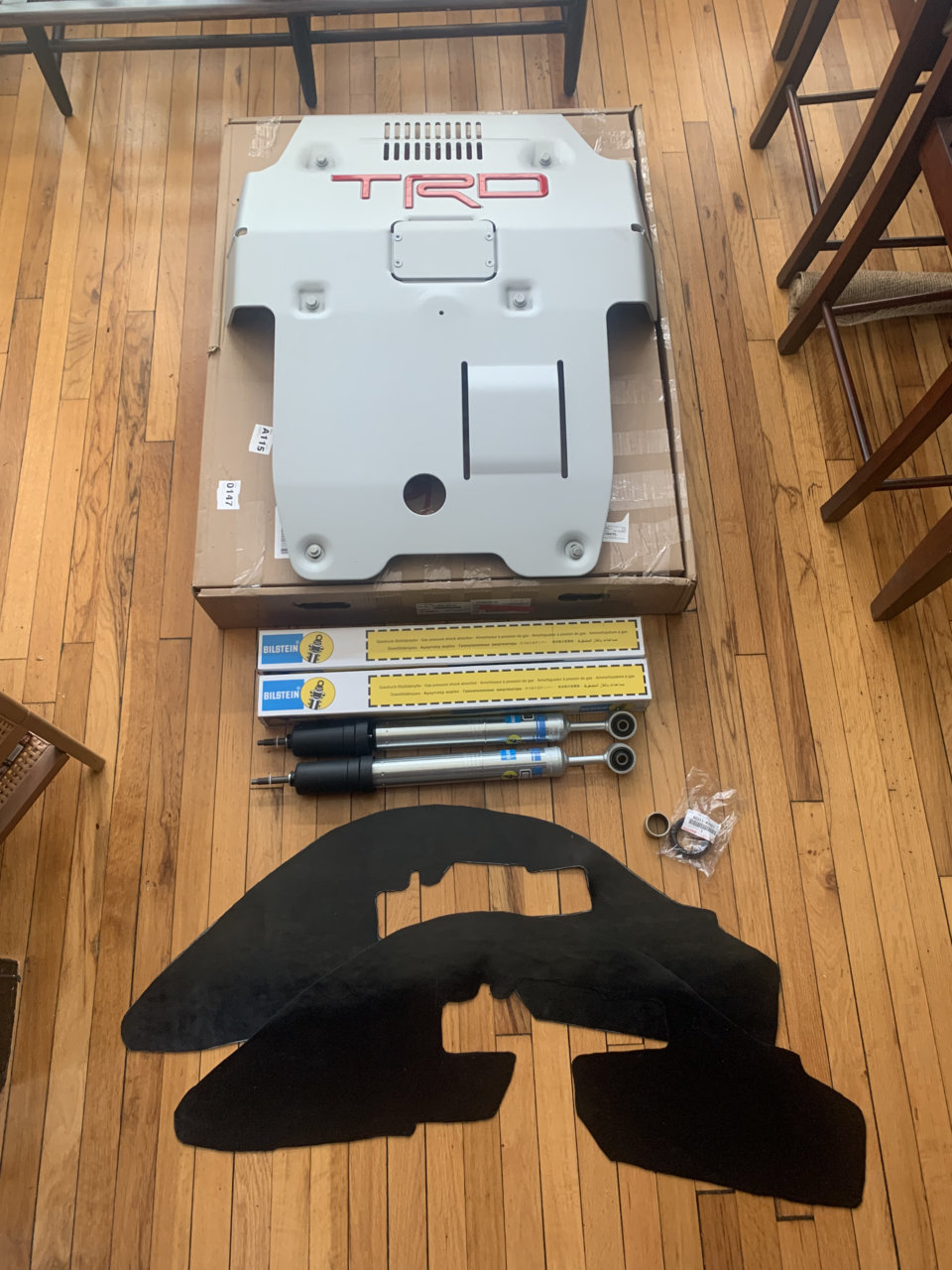

    August 7th, 2021

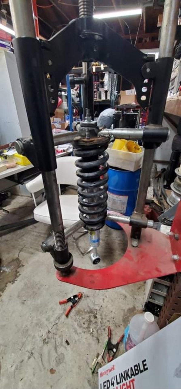

    Received my 5100’s, ECGS bushing, and Pro skid. Also finished up the upgraded fender liners.

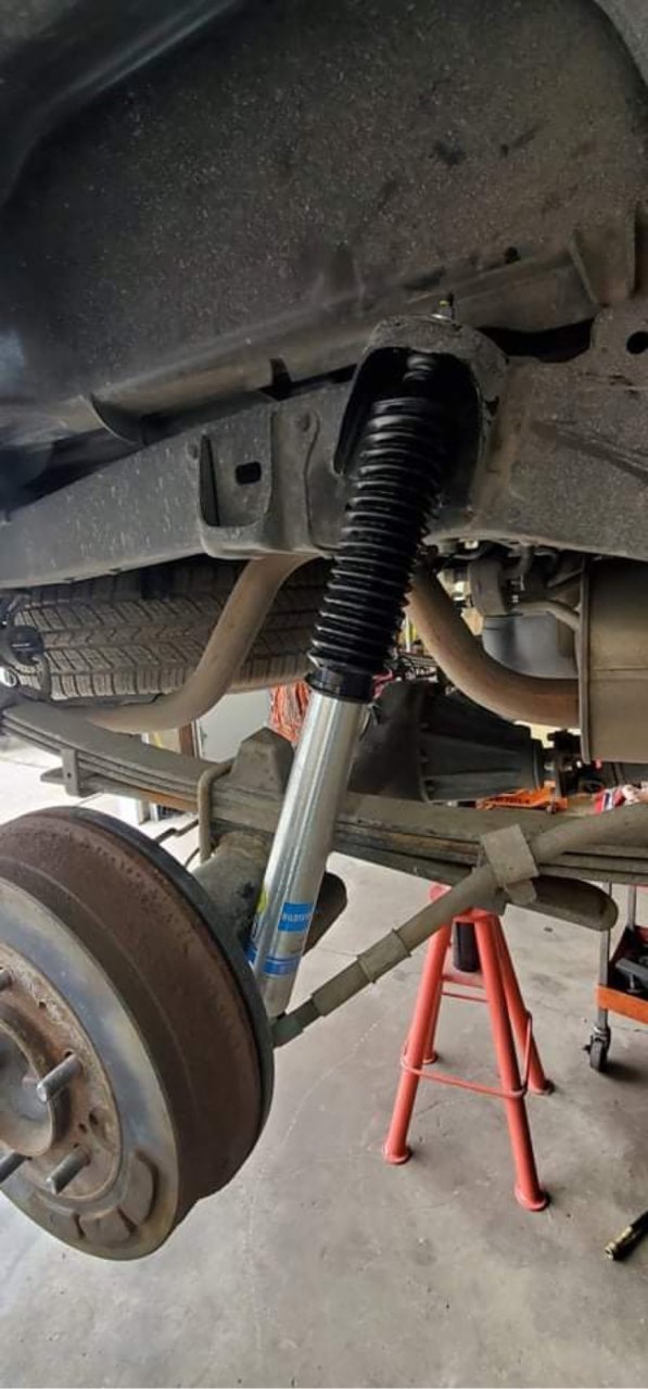

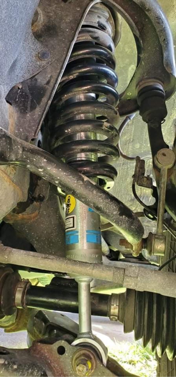

    August 14th, 2021
    Bilstein 5100 and ECGS bushing went on today. Serviced both diffs and the t-case.

    Not a huge change in stance after the 5100 install. I drive this truck A LOT for work so I wanted to keep the CV's as close to the stock angle as possible. I set my 5100 on the second clip and gained about .7" of lift. No lift in the rear. Tires are 265/70/17 and I don't rub at all after removing my OEM mud flaps.

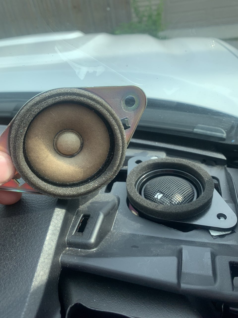

    Subaru Kicker tweeters installed

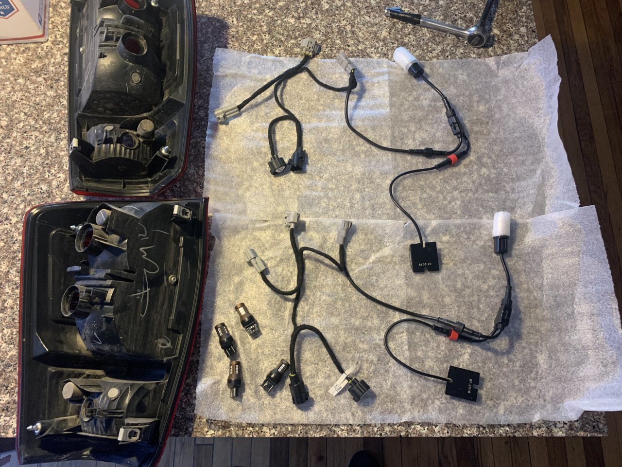

    September 16th, 2021
    MESO total tails - Stage 1

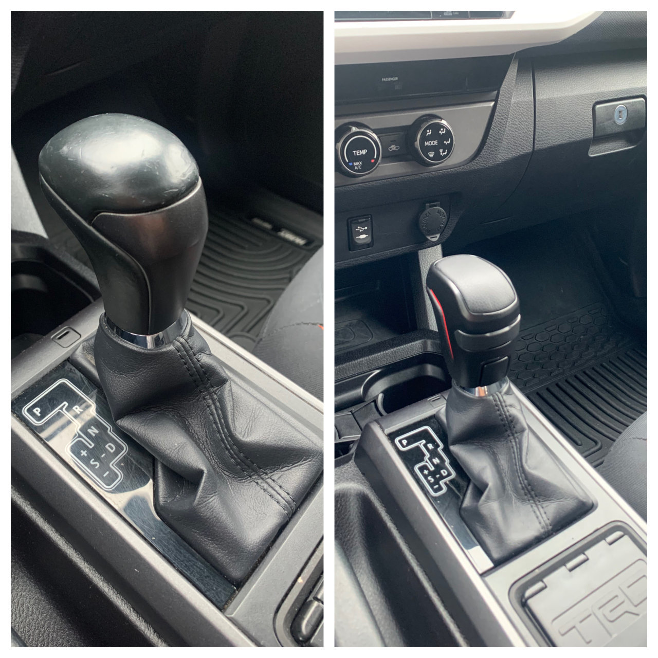

    Picked up a faux TRD Pro knob from eBay. I really like the larger size of this shifter since I usually rest my right hand on the shifter when I drive. Now that I know I like this knob, I’ll start looking for an OEM or *fingers crossed* MESO stealth knob.

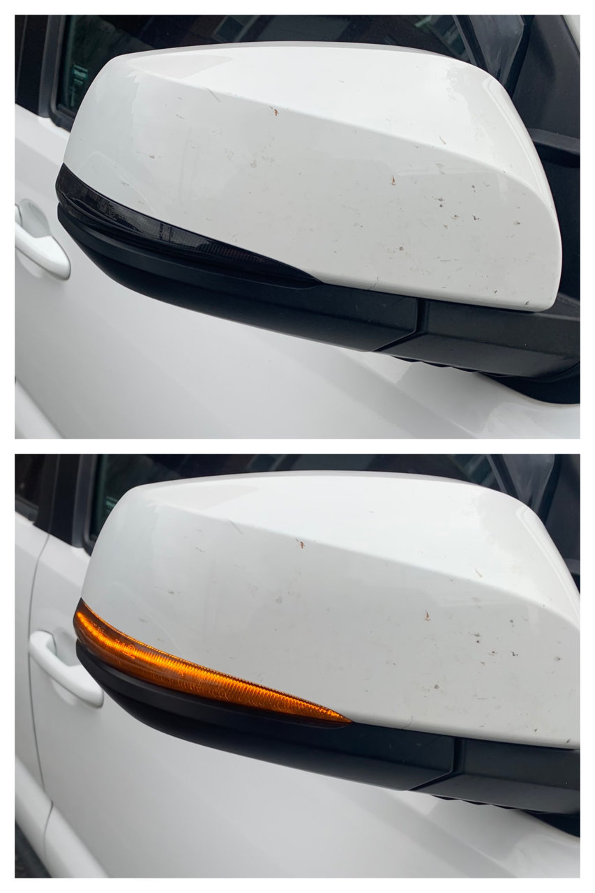

    November 12th, 2021

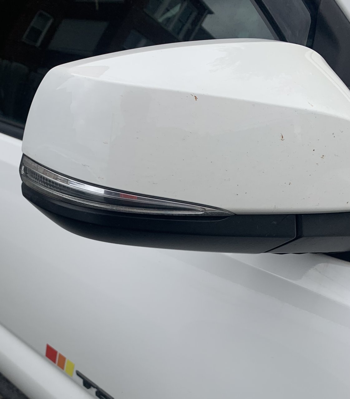

    Ordered the N2 designs remote start, Anytime front/rear camera system, and some sequential mirror signals from Cali Raised.

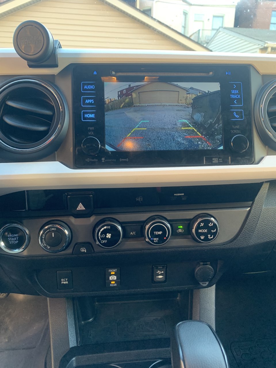

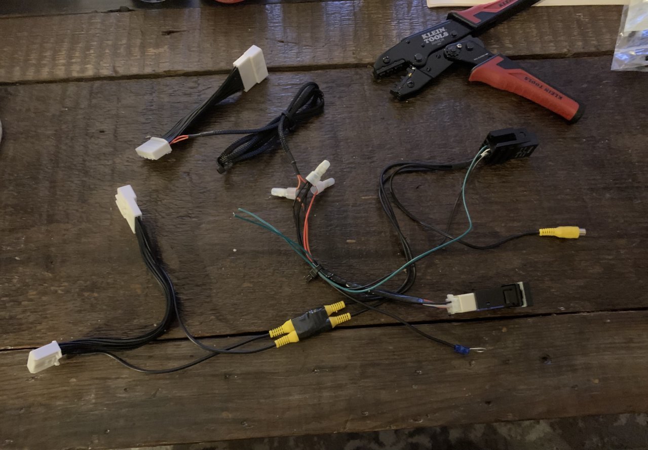

    November 22nd, 2021

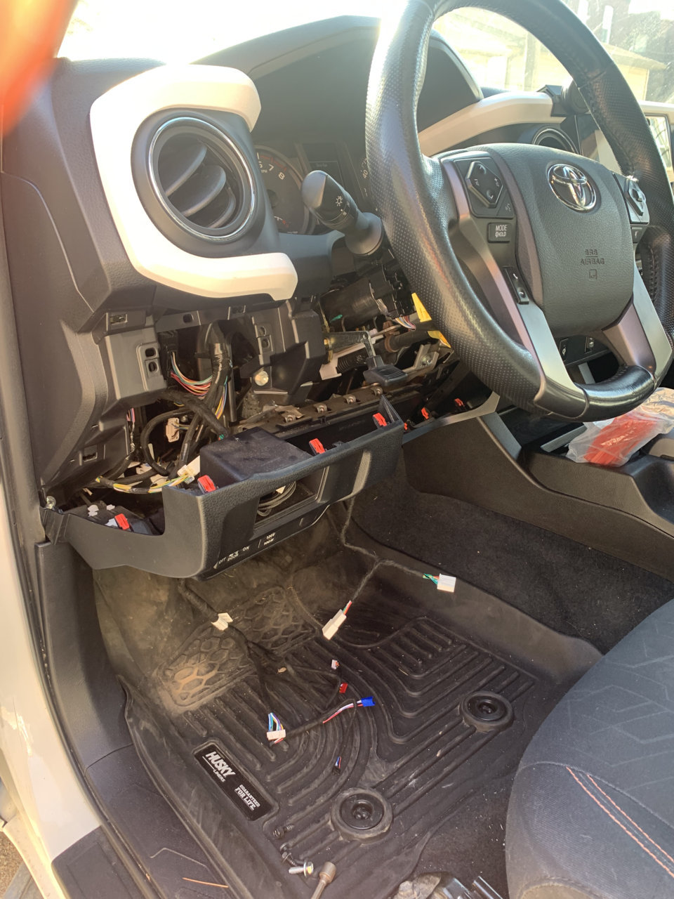

    Got everything pre-wired and plugged in for the Anytime front/rear camera.
    Installed!

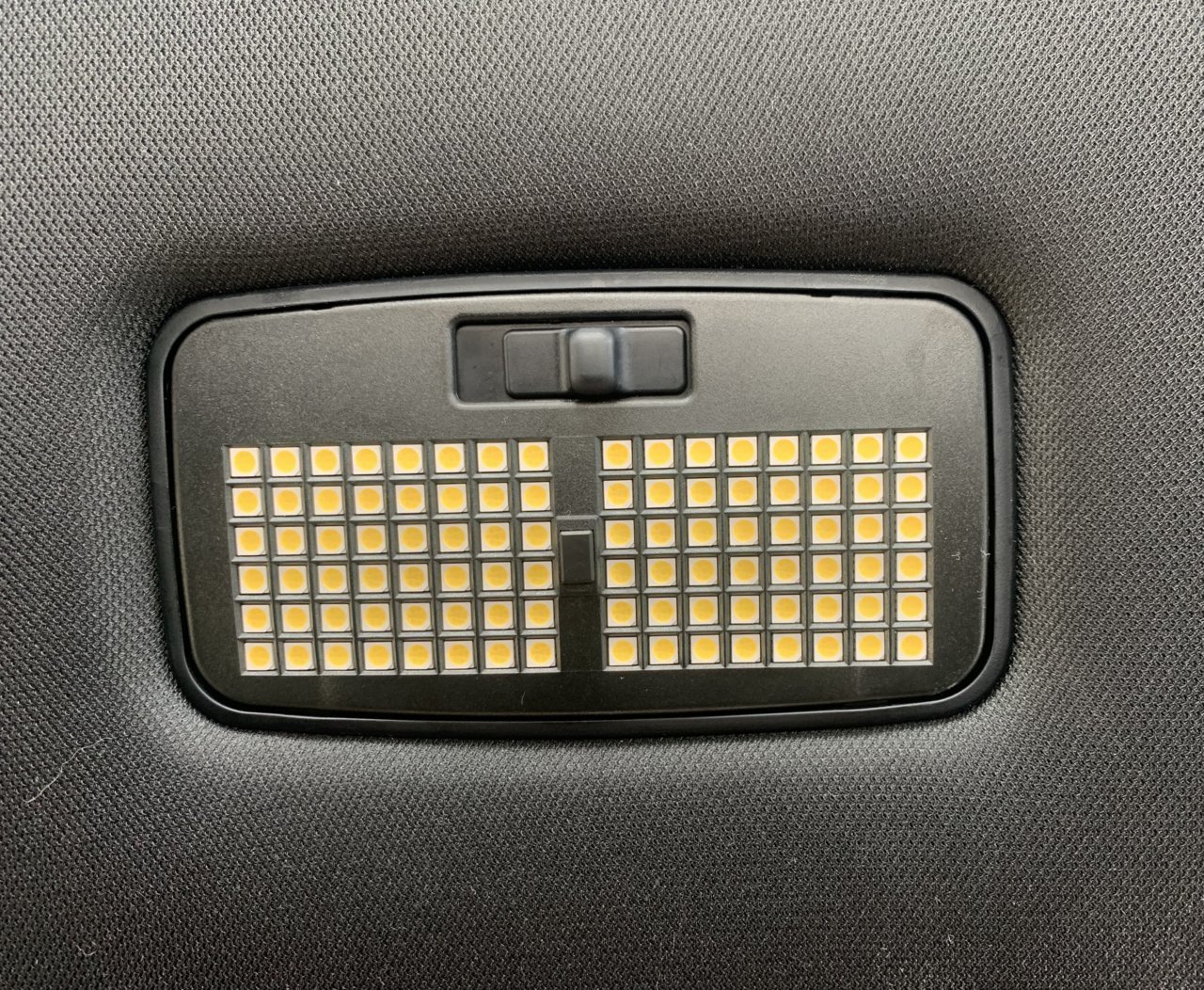

    Couldn’t pass up the Black Friday sale at Meso. Installed the LED dome light and Gashole since my gas cap leash finally snapped.
