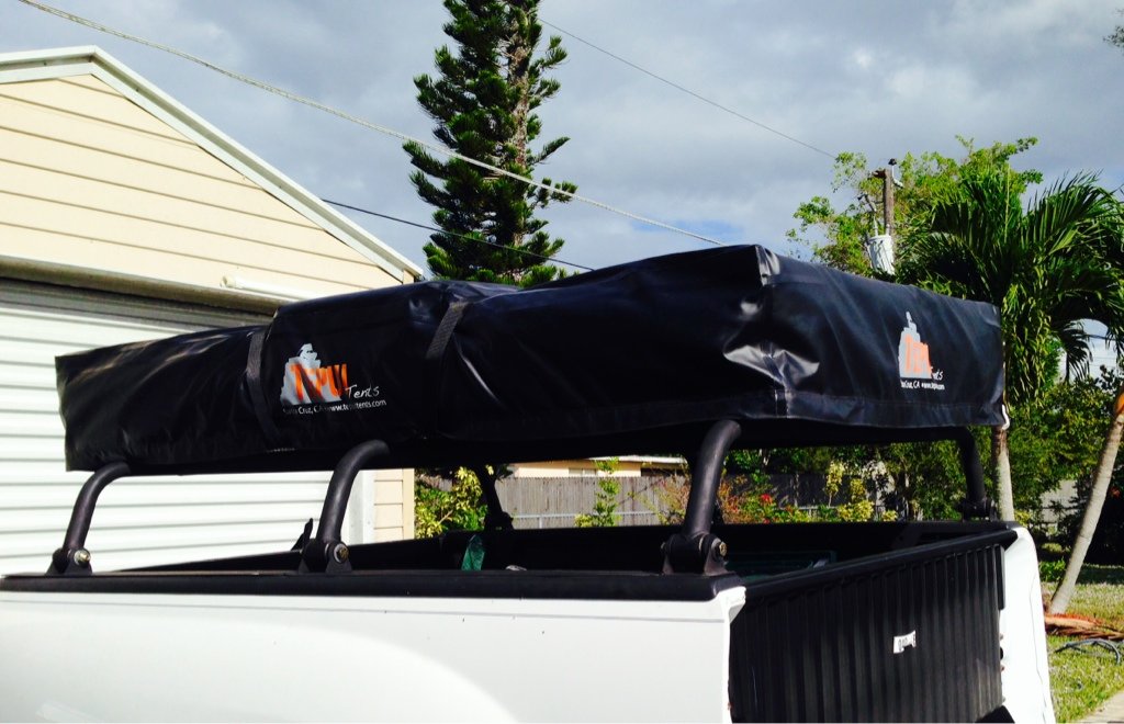

    yeah that is my rack , i design it long time ago and send the draws to eddy when i order it couple months ago , cant wait to have it on my hands because i will be doing some more modification to it for the gas lift shock , bracket for the awning that will be opening to the opposite side of the Tepui RTT and much more :cool:

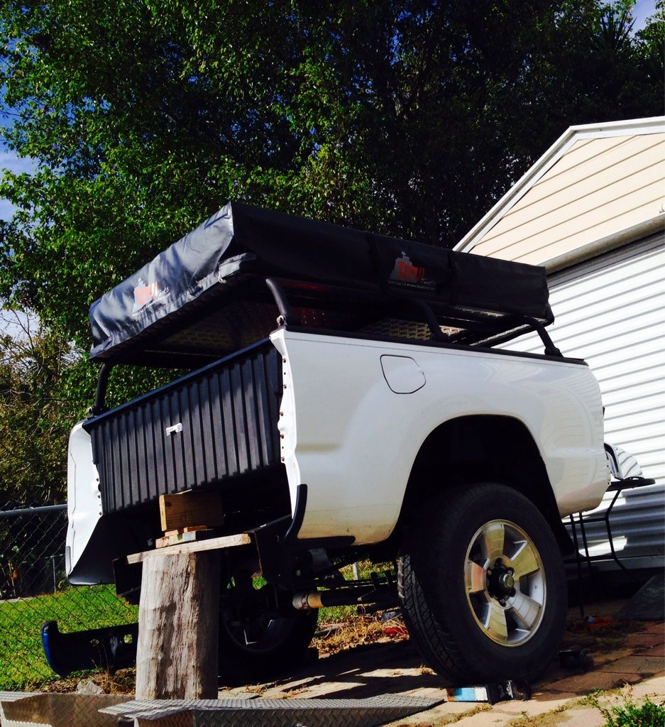

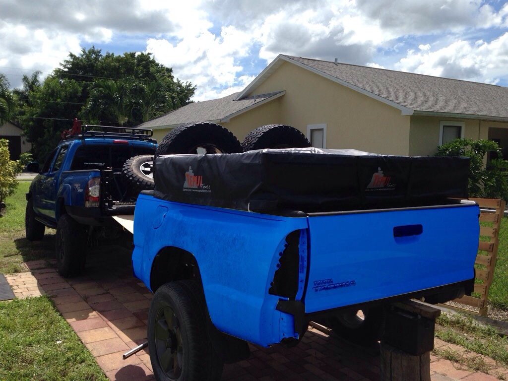

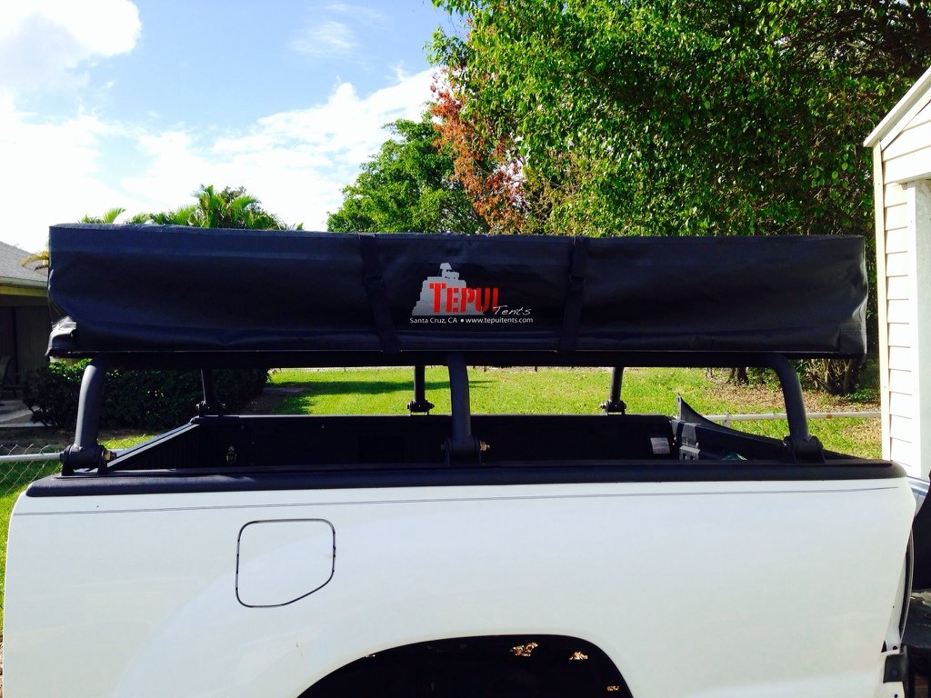

    I just pick up my Custom SOS concepts bed rack today

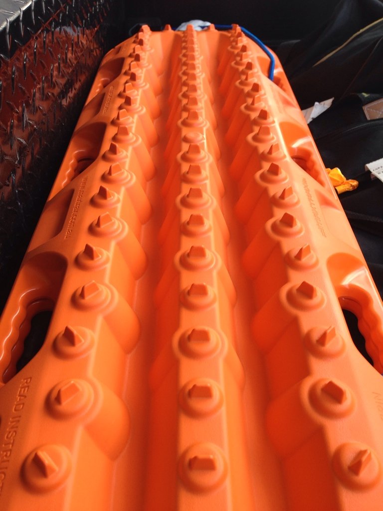

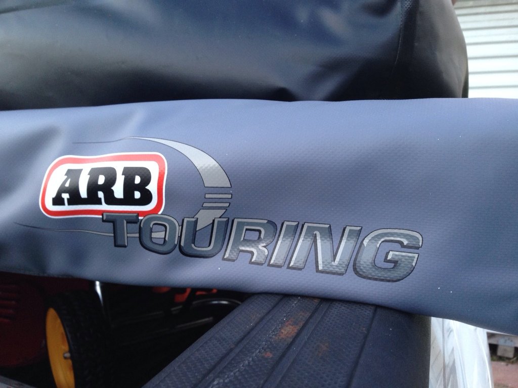

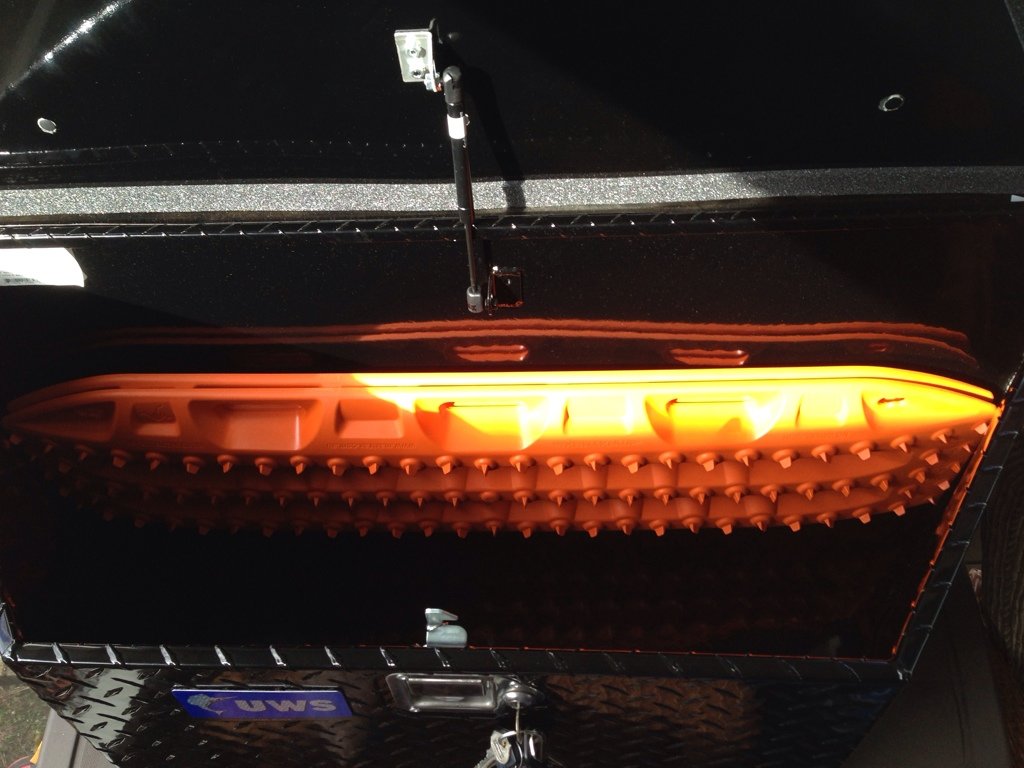

    Got a great deal cyber monday on a set of maxtrax orange and a ARB awning (2000) , I didn't get the one for the back (tailgate) because they are back order on the ARB (1250) but I will order in the next few weeks

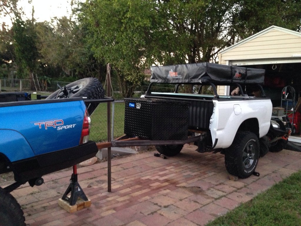

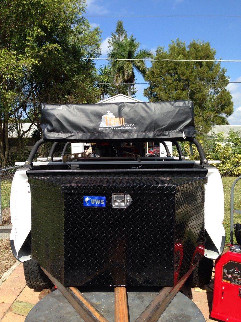

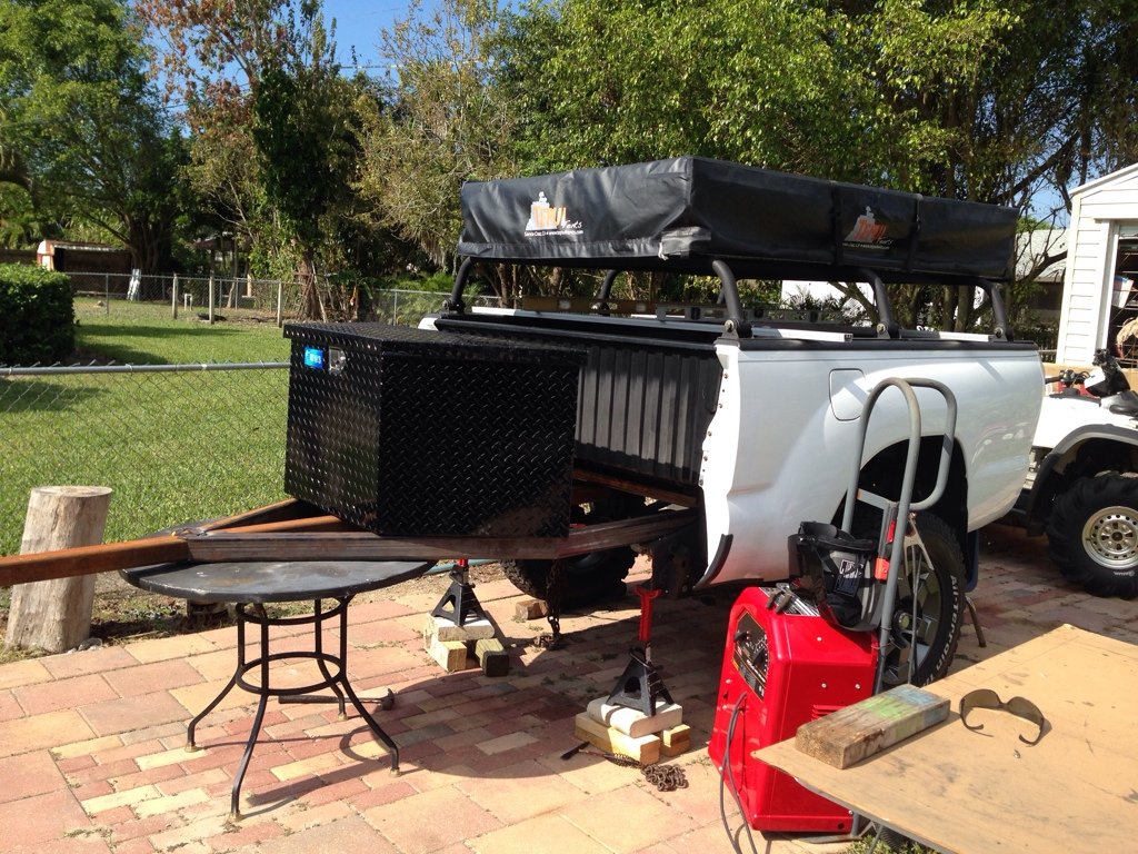

    2 Spare tires in between toolbox and bed
  17. Dec 8, 2014 at 10:50 AM
    #37
    gathaway
    gathaway TRD Overland
    Feb 17, 2013
    #97786
    436
    Fayetteville, NC
    '11 TRD Sport Double Cab
    6in. ProComp Lift 35in. Tires
    Will the 2 spares add to the tongue weight? (Asking bc I don't know)

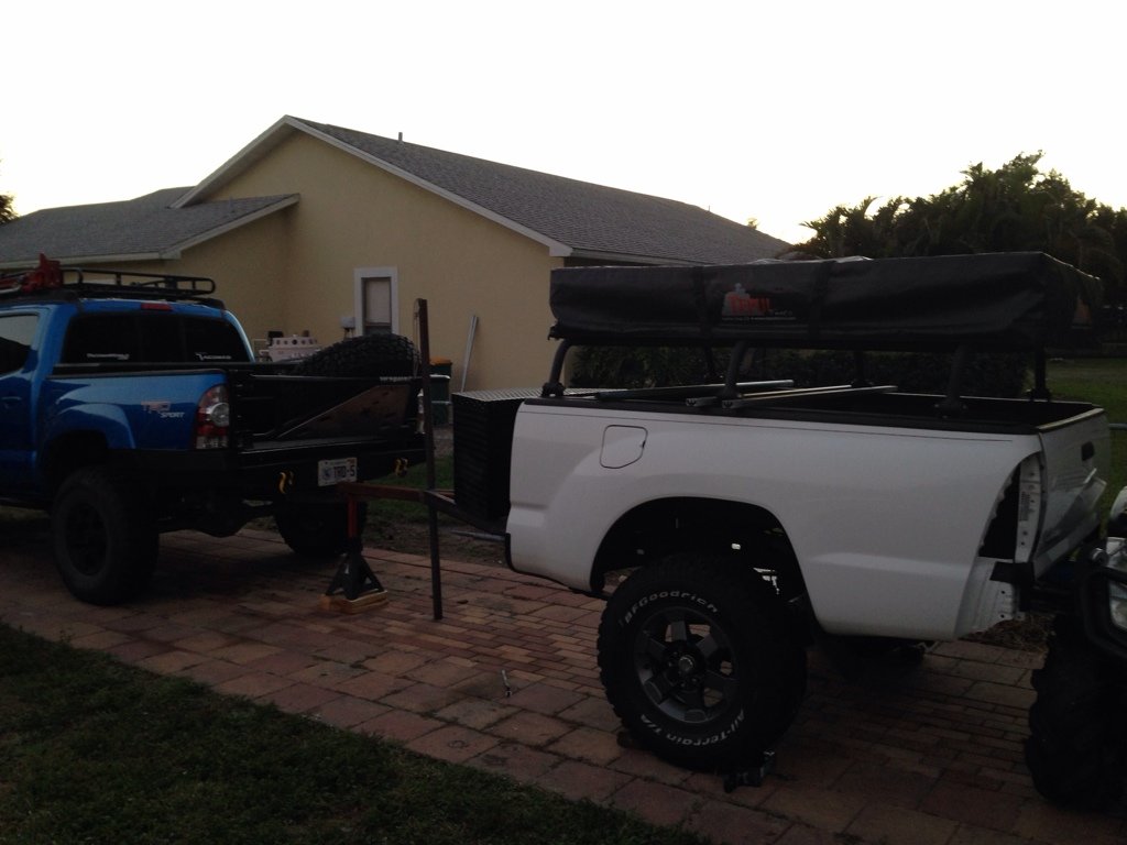

    I need more weight in front because trailer is heavier on the back when is empty

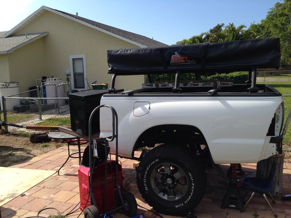

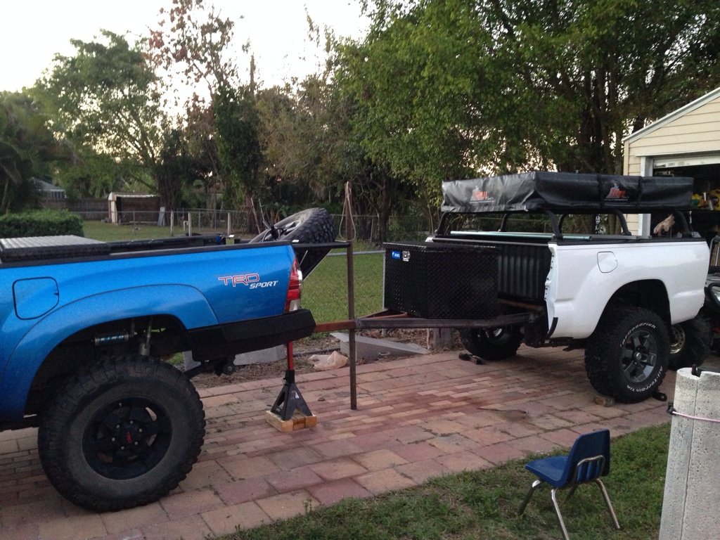

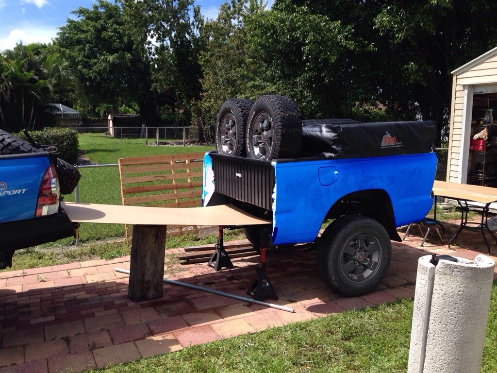

    some progress today
