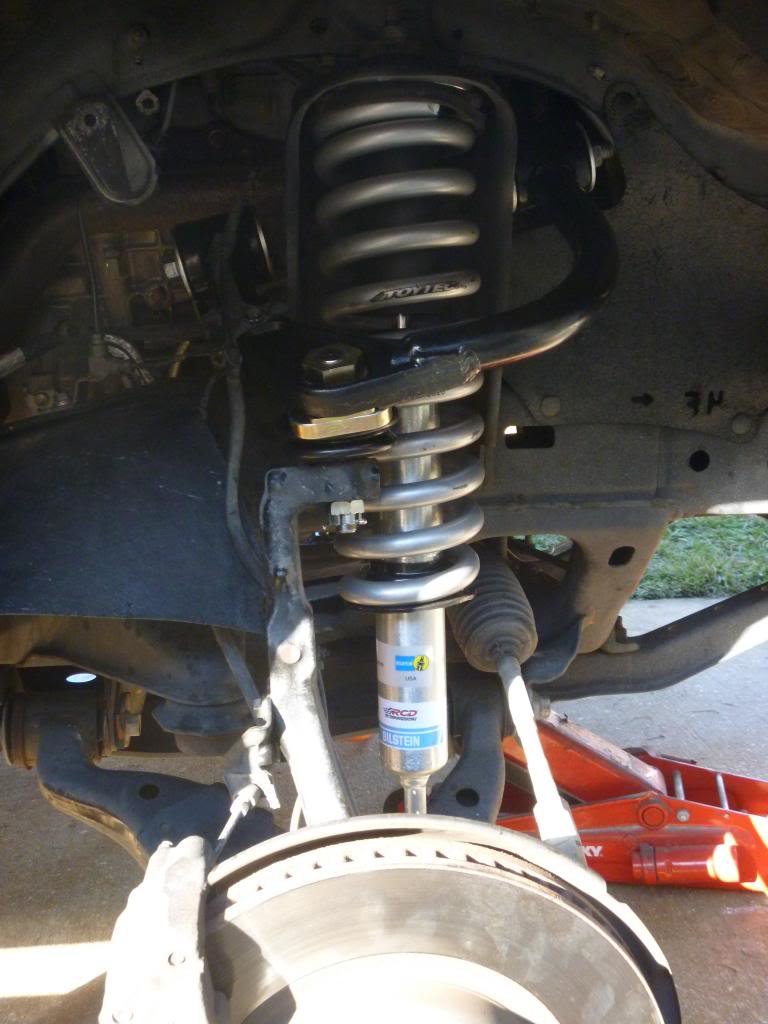

    Suspension
    -5100's set at .85
    -Eibach coils
    -LR UCAs
    -Sway bar removed
    -Rear 2" block

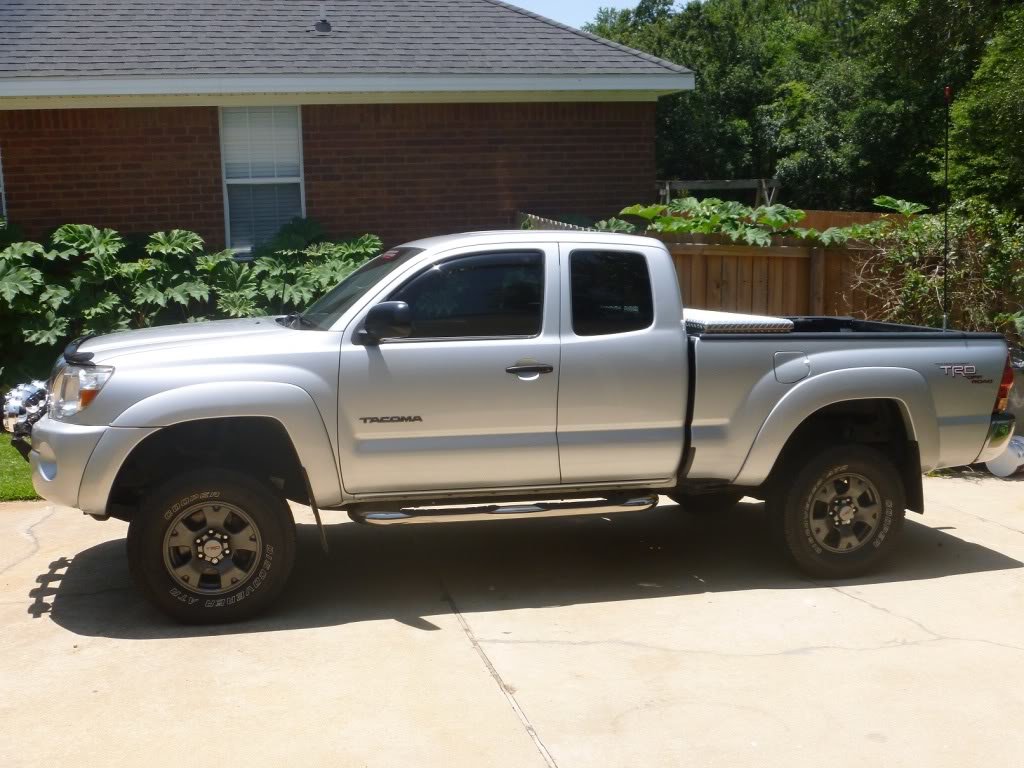

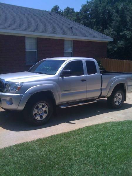

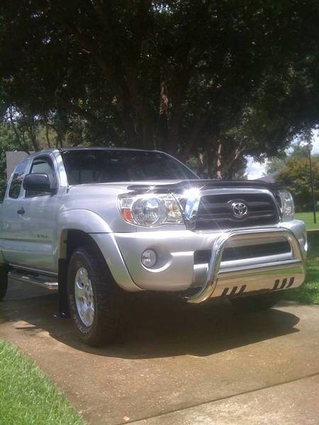

    Here she is the day I brought her home
    The first mods included AVS in-channel vent visors, an AVS bugshield and a bull bar.

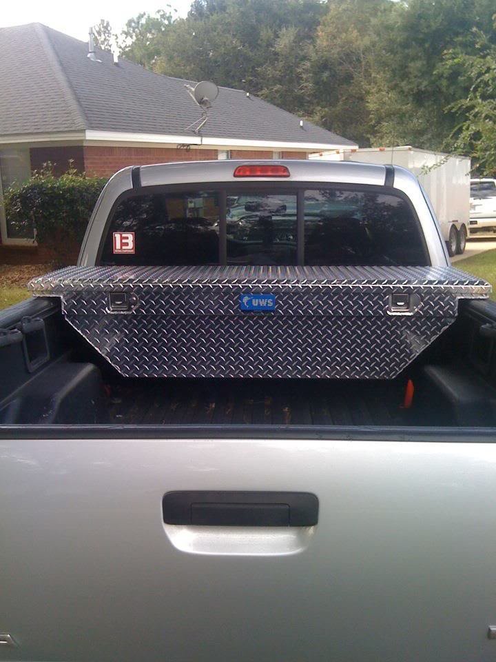

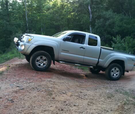

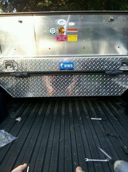

    For my 21st birthday, my parents got me a UWS low profile toolbox and my girlfriend bought me a 3in leveling kit :D

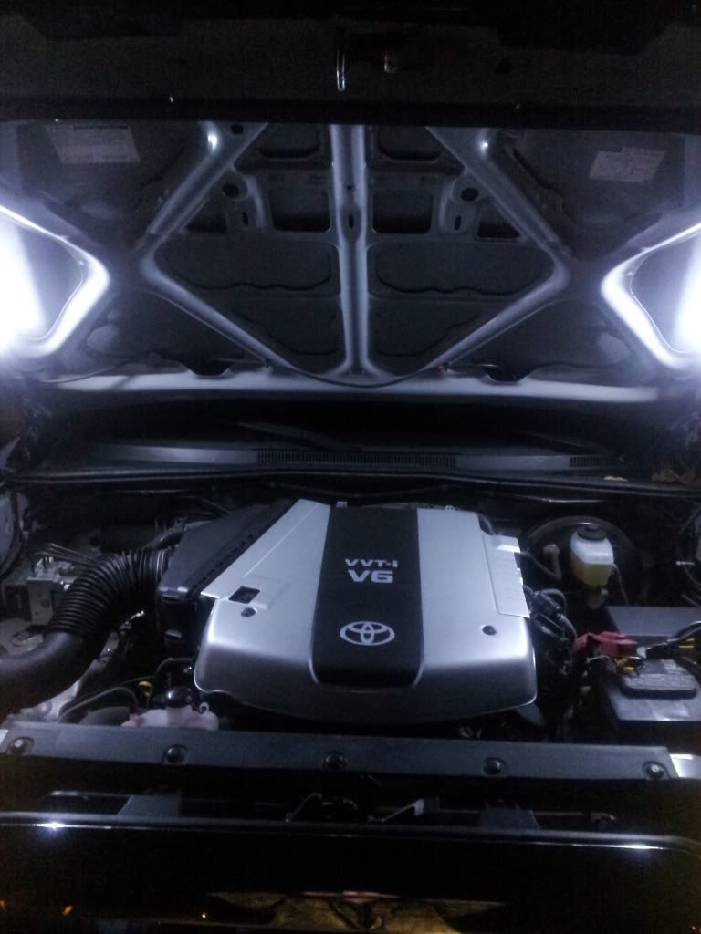

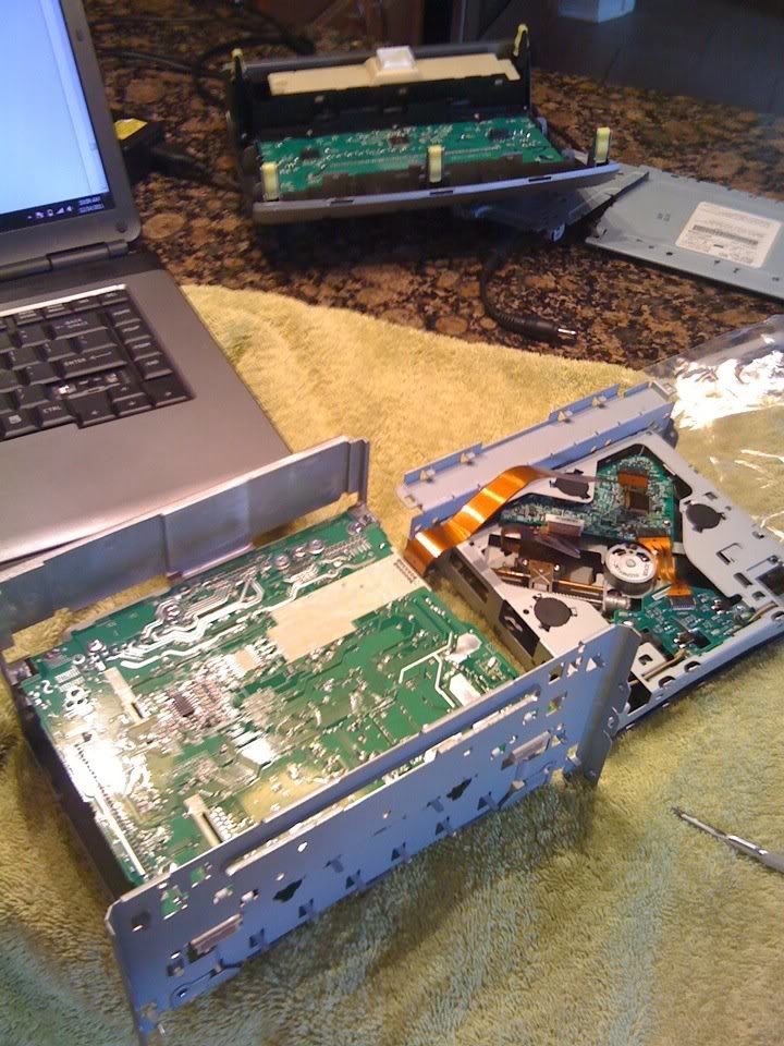

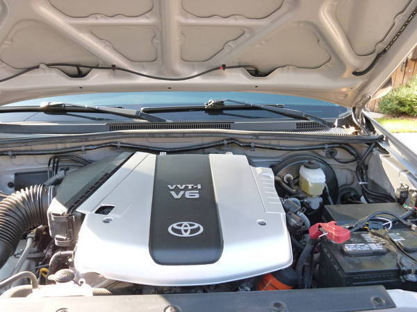

    I then did the aux plug for the factory radio, painted my engine cover and added led's under the hood

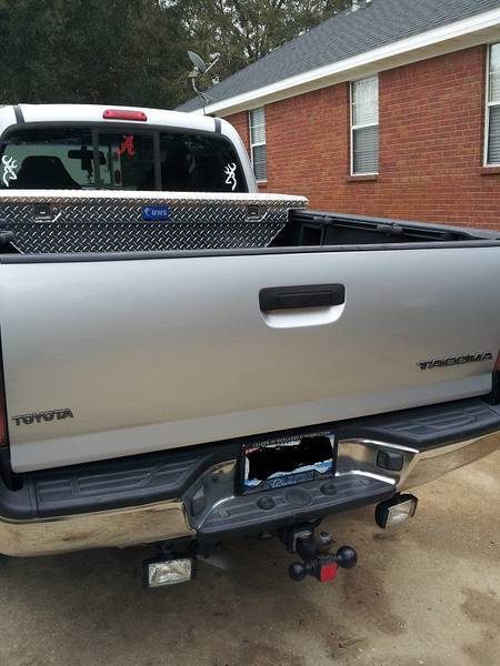

    It was hard to see out of my tinted windows so I added some extra reverse lights that are on a switch as well coming on when the truck is put in reverse.

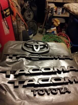

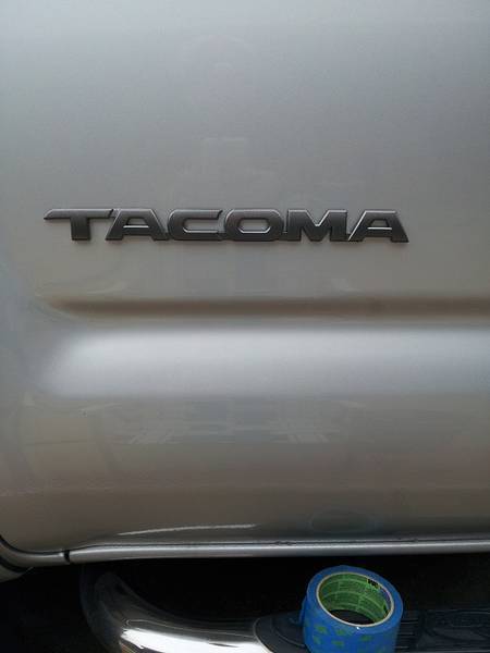

    Next came painted badges with a partial de-badge. I used graphite wheel paint to do the badges

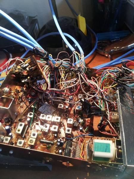

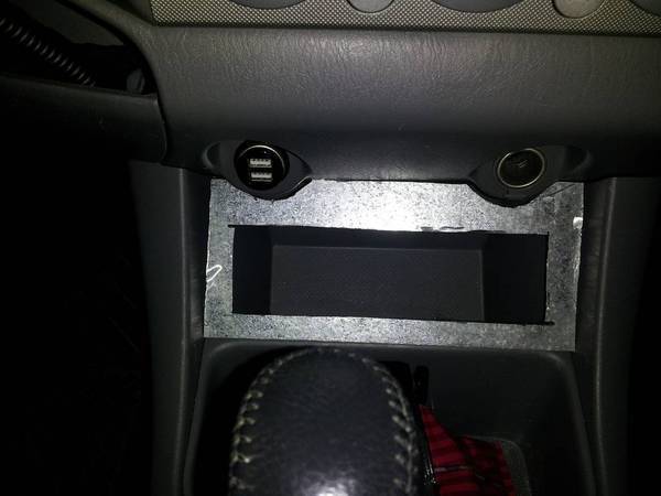

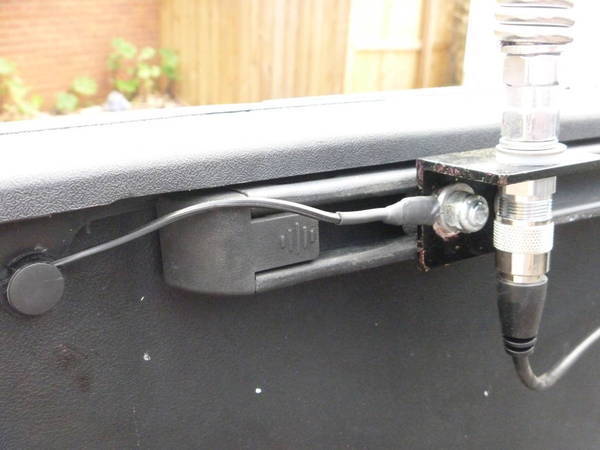

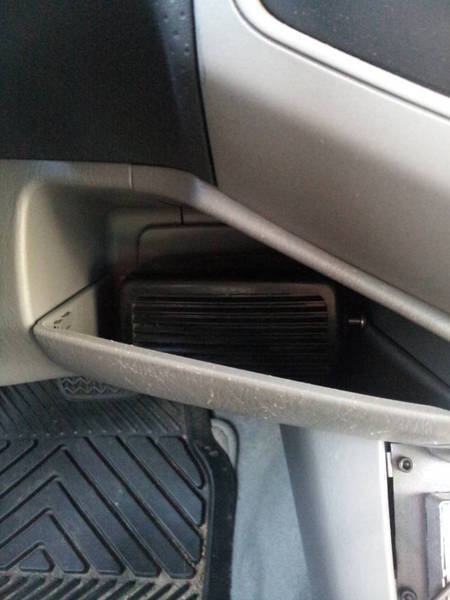

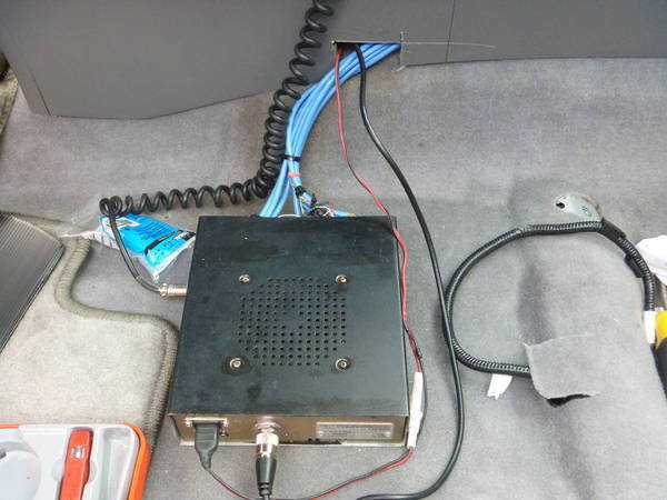

    I had a major impulse moment and decided I wanted a cb, so I went all in and put a Cobra 29 in the front cubby of the dash, paired with a 4' Firestik and an external speaker

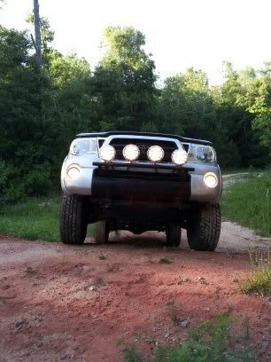

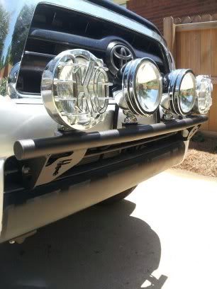

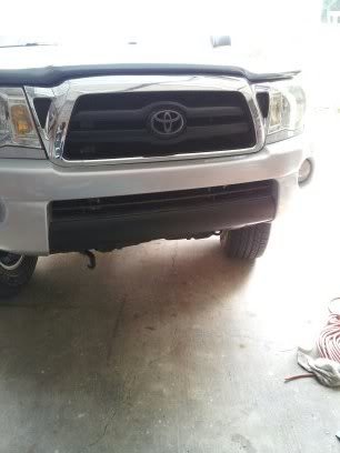

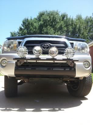

    After bashing my bull bar on a stump in the woods, I decided to ditch it and go for a N-Fab light bar with 4 KC 100W Dayliters and Plastidip my lower valence

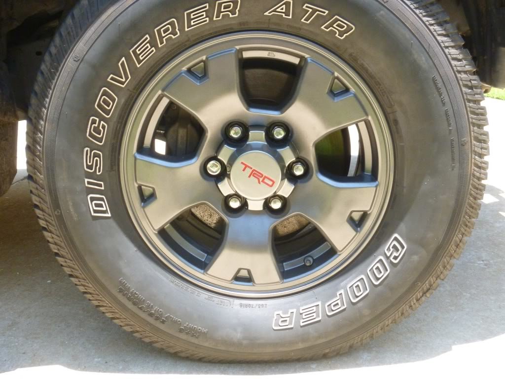

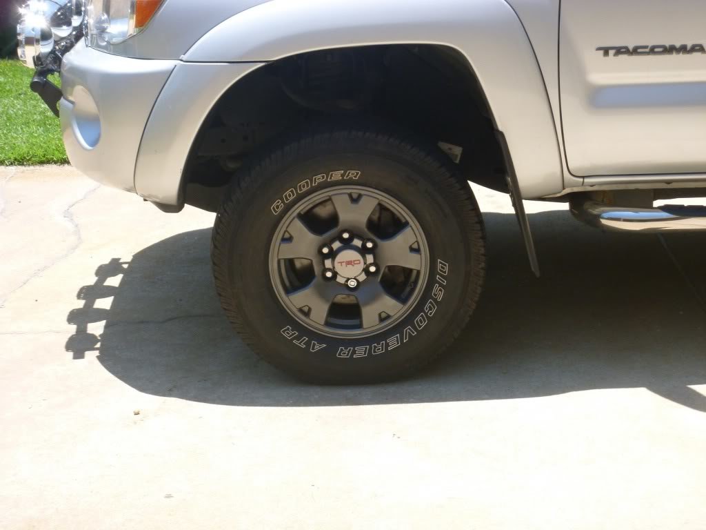

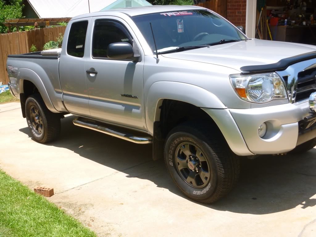

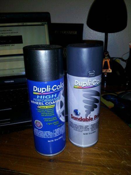

    I was wanting a different look so I decided to paint my wheels to match my badges. I used the Duplicolor graphite wheel paint and the Anthracite FJ center caps.

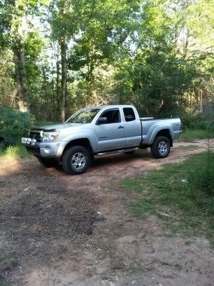

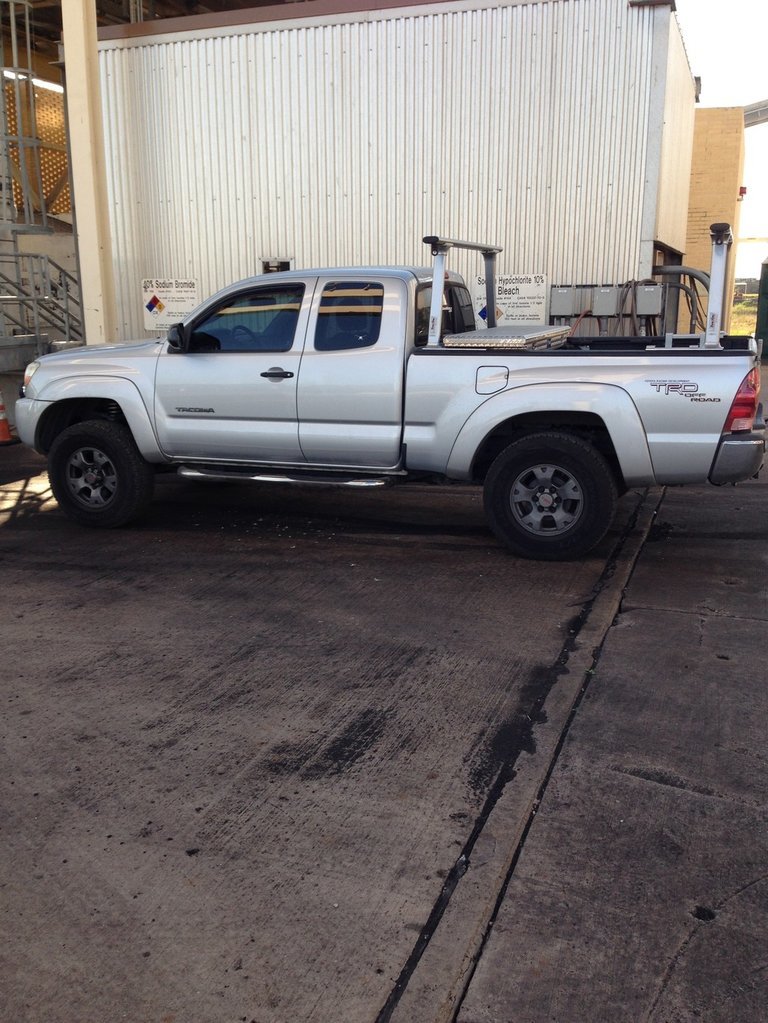

    This is how she sits today, and I am completely happy with how my build has turned out. I have this site to thank for all the wonderful writeups and how to's. I also have a lot less money thanks to TW :D I hope ya'll enjoy!

    Damn you did a great fcking job with those wheels! They look SICK!! :headbang:

    Thanks man! Prep is key and I didn't wanna go back and fix em so I did it right the first time lol. I got the wheel weights on the inside of the rim to clean em up. I sanded em completely with 320 grit. Primer then 3 coats of paint. Def my favorite mod so far!!:yay:

    What kind of paint and color did you go with?
  6. Jun 7, 2012 at 7:15 PM
    trdNick
    trdNick [OP] Odie
    Dec 27, 2011
    #69480
    749
    Mobile, AL
    07 Trd Off Road
    Duplicolor graphite

    actually going to copy two things you did... haha using some graphite on my old set of rims i'm selling and doing the cobra 29 set up. how hard was the cobra?

    wow thats a long time. Is it all straight forward though? like can someone who knows how to solder get it done.

    Oh yeah, once you open it up, just cut one wire at a time and splice in the longer wire, and be sure to use shrink tubing around the solder to prevent any shorts. I'm sure it could be done quicker i just took my time
