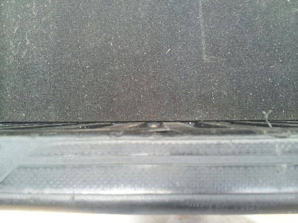

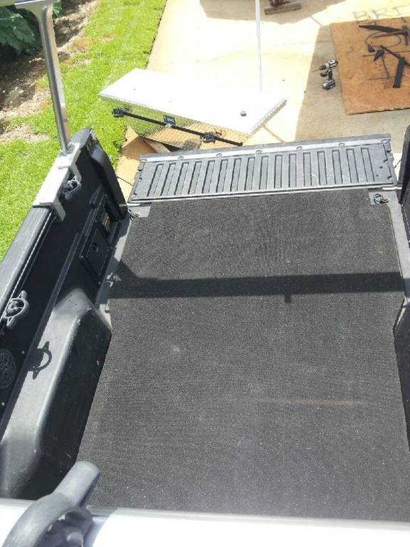

    Got my Tractor Supply bed mat in. Cut it to fit between the wheel wells. I love it!
    here it is flush against the tailgate

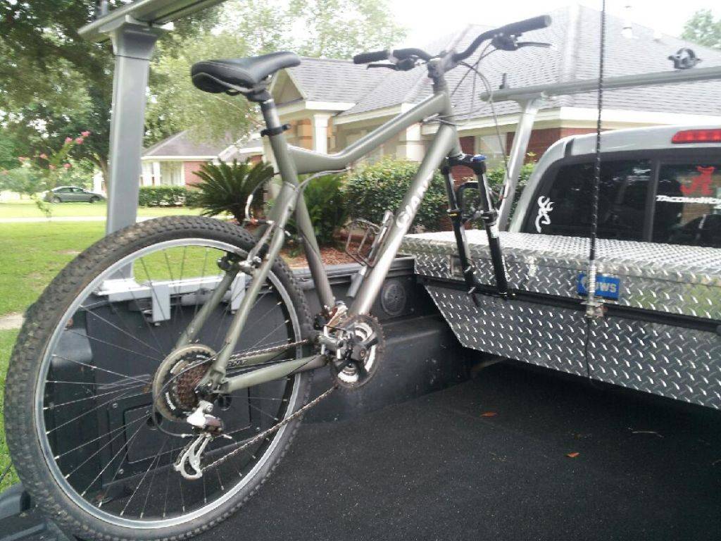

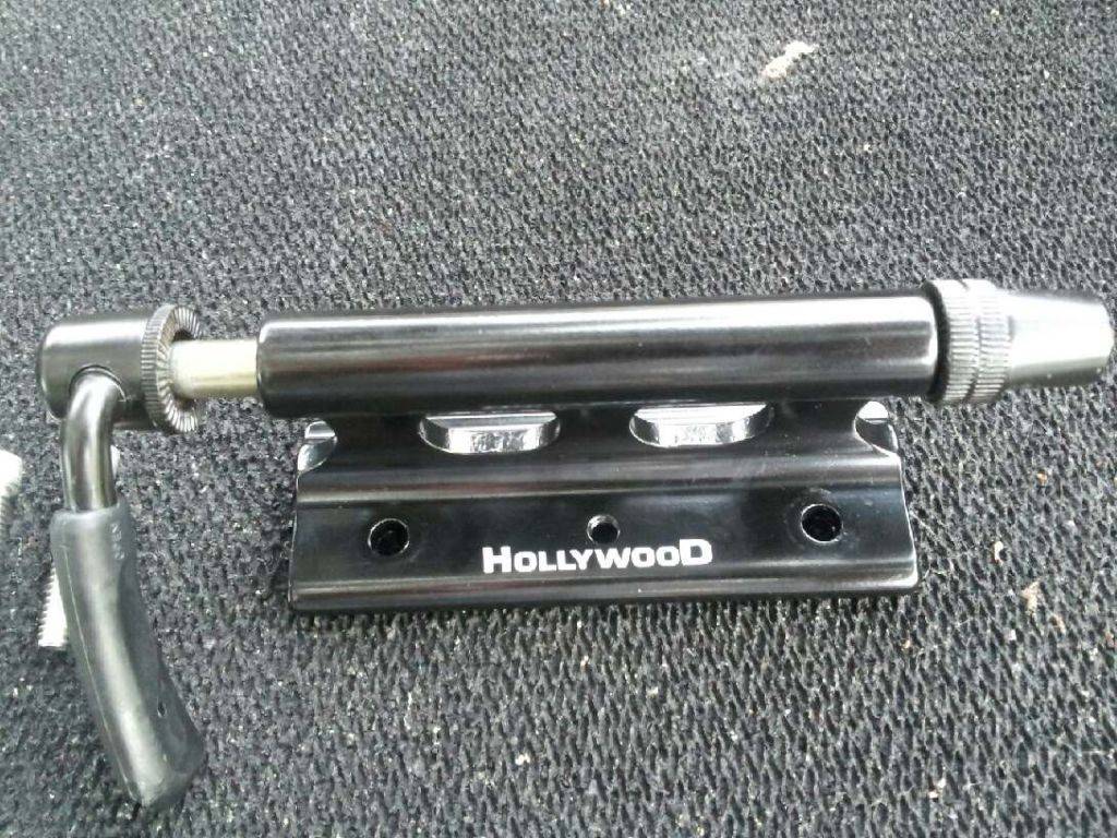

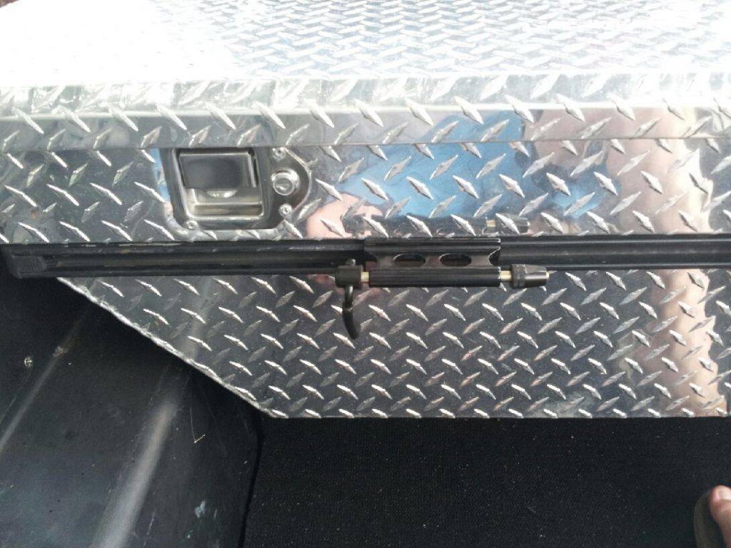

    Also mounted my new bike mount. Used stainless 1/4-20x1 1/4" socket head cap screws and some unistrut nuts. Works like a charm.

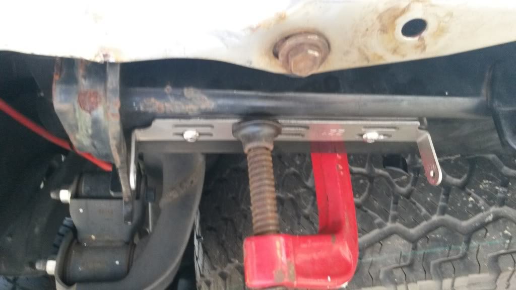

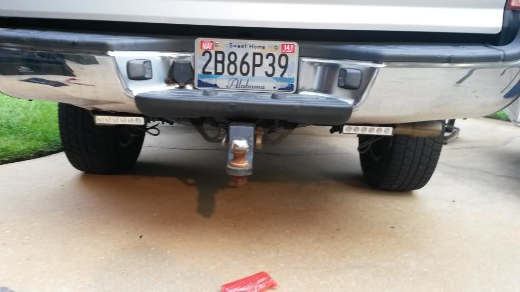

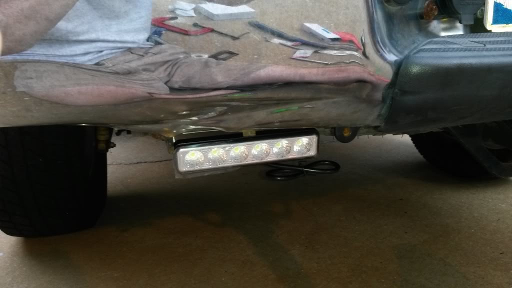

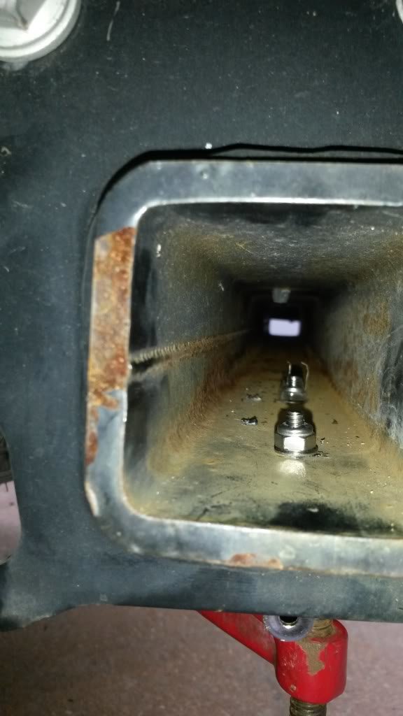

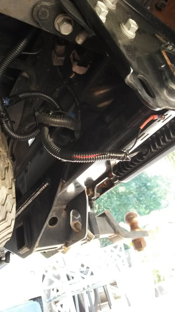

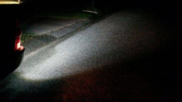

    New axillary reverse lights! Blitzpro 6LZ LEDs. Mounted into the receiver with some stainless steel hardware and Nylock nuts so I do not have to worry about vibrations.

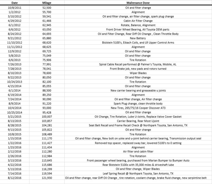

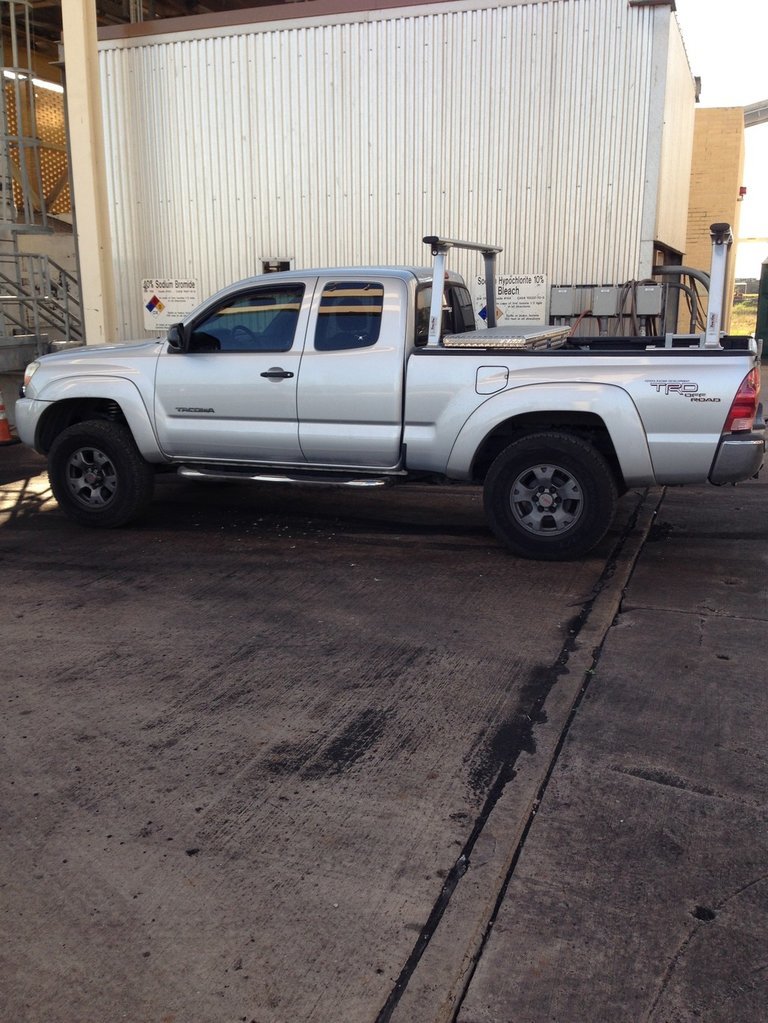

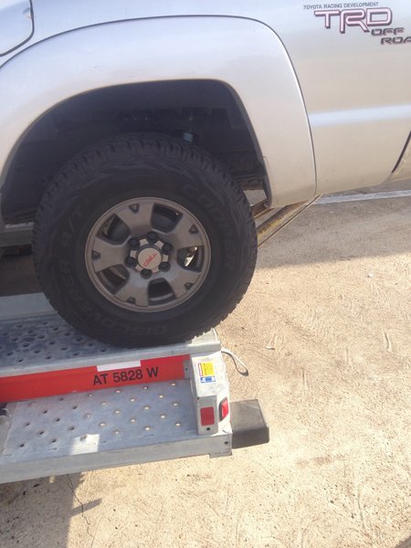

    I guess an update after more than 2 years in order. Not much has changed, had some driveline problems so I decided to remove my lift. Left the Eibachs on and Billies set to 0, and the LR UCAs. So basically just a fancy leveling kit now. Also got 265/75/16 Cooper AT3s put on more than a year ago. Really impressed with the ride. I have since moved to Texas and drive substantially more than I used to. Reliability is key for me now, so all unnecessary wear and tear is being eliminated. Next up is going to be tie rod ends (inner and outer), lower ball joints, rear brakes, coolant flush, transmission fluid flush, and brake fluid flush.

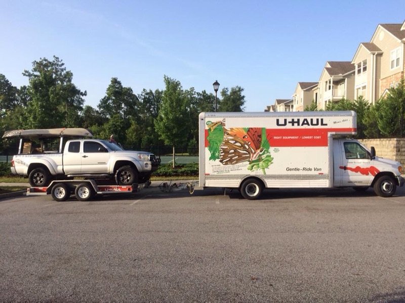

    Random shot from mine and my wife's move to Texas.

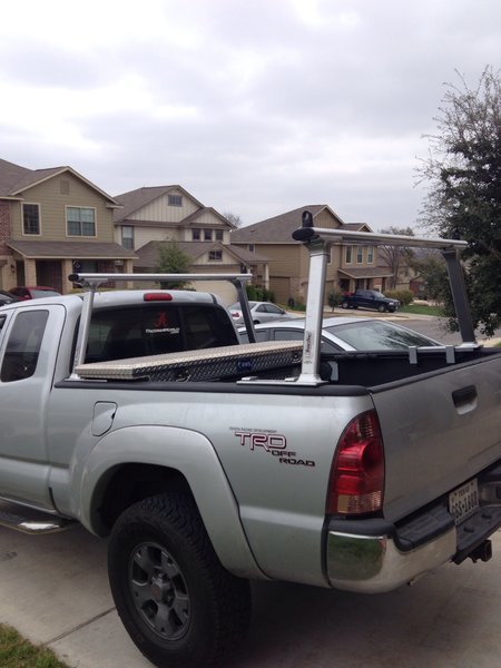

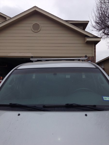

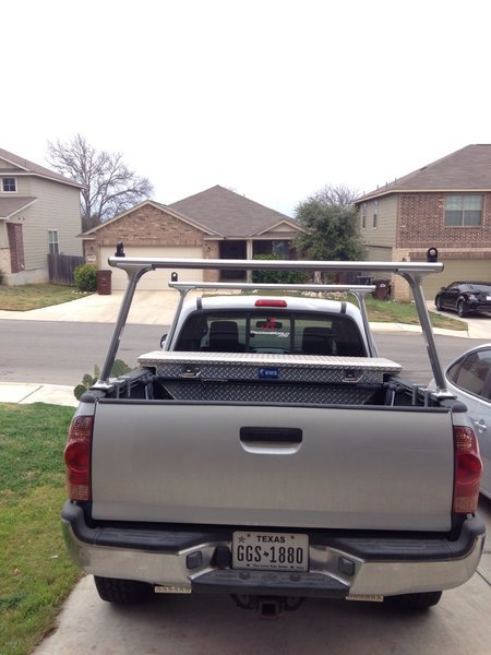

    Trimmed the Tracrac to better fit the lines of the truck. 3" off the height and 8" off the width.

    trdNick, how did you trim down the heigtht of the TracRac? I've been looking into buying a set and I have not found anything about adjusting the height via trimming.

    Just used a jigsaw with a metal cutting blade. Taped off the cut area and cut through the tape. So it is a non reversable modification.
