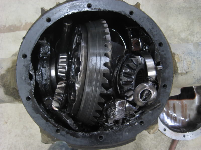

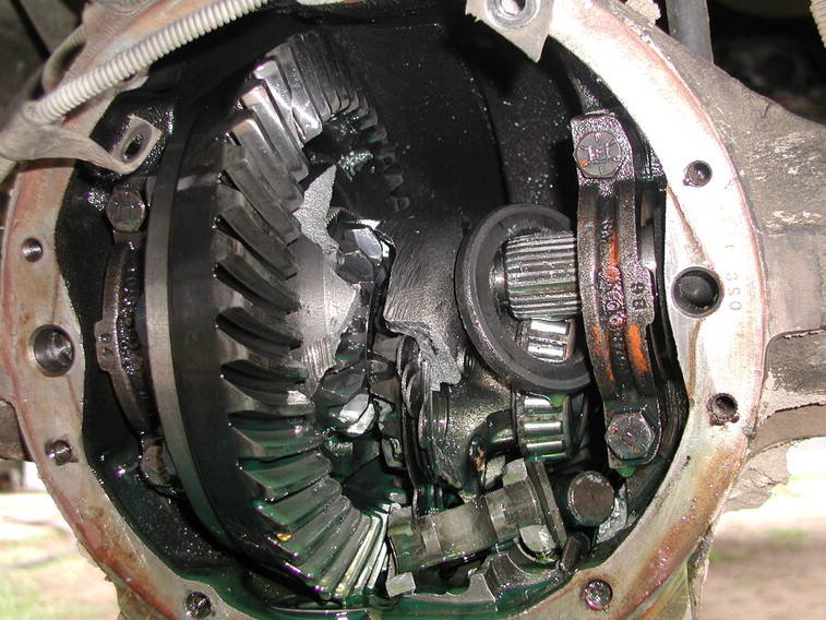

    Mostly stuff I built.
    Hense their nickname "Gov Bomb".

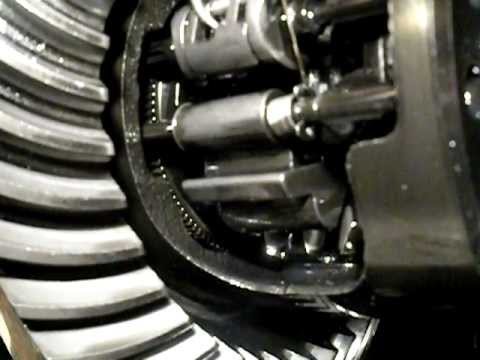

    Not going to argue with you but Eaton still makes the G80 for GM. They have been sense the 70s. They fail because of all the material taken out for the fly weight assembly location. Usually start cracking in the shaft bores then one or two high speed applications and they come unglued. I replace them pretty regularly in 10 bolt and SF 14 bolt rear axles after they turn themselves into scrap iron. I have probably rebuilt 150-200 of them that have failed catastrophically over the last 20+ years. Of those about 40 or so were on bone stock 2009 and newer trucks. IMG_2901.jpg
    http://www.eaton.com/Eaton/ProductsServices/Vehicle/Differentials/mlocker/index.htm
