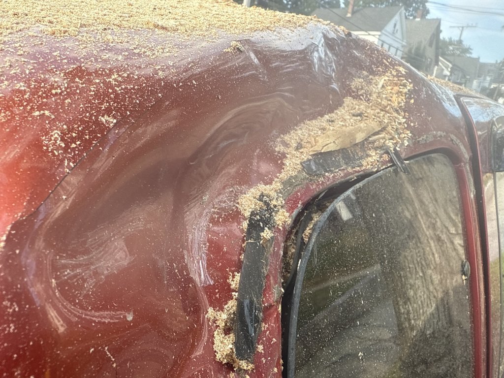

    A tree branch fell on the truck the other night and I wanted to know if you think this is worth saving, if I could maybe try to fix it up myself, or how much it might cost at a collision repair shop. This is the only damage from the fallen branch.
    Any ideas would be appreciated

    Horrible picture...
    I retract my statement thats the roofline of the extra cab.....
    Thats extensively mangled!!!
    Front door isnt even aligning correctly any longer..
    Professional bodyshop....
    Chances are if you go through insurance they will total the truck...
    That is 100% total if you go through insurance & a very costly repair, wont make financial sense...

    "What would this cost to fix?" There's about 3 dozen variables involved in this equation, none of which can be determined from the pic you provided. Clean it off, take some more pix, and lots of us can speak to repairability, but for someone to tell you with any degree of accuracy (not dumb luck) what it might cost, they'd need to know the labor and paint/material rates, sales tax rate (if any), what tax is charged on (everything, or just parts/materials), paint code, etc...

    Picture is kinda to close up. From what I can tell it needs more work than any body shop will want to do. Fixable yes, but it looks really deep like the inner structure is going to be damaged too. Most body shops won't want to touch that on such an old vehicle. It would be cheaper to find another cab and swap cabs.

    More work than a bodyshop is willing / want to do?
    Bodyshops will fix anything, well atleast where I live in San Diego....
    Thats not a job, lets pound & hammer it straight & throw some filler to make it right...
    That will cost & here, nobody shop will turn it down, but you or insurance will pay dearly....
    My guess no parts available to fix it, need the roof skin & structure underneath it....

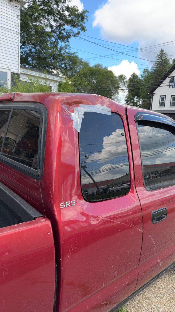

    You’re right, honestly at 250k miles it’s almost certain this is totaled especially after looking closely at other angles, and the fact that there’s a gap in the rear window seal.
    I thought I uploaded more photos but it appears only 1 is showing.
    I can’t see myself going through the hassle with how it seems so for now I’m just gonna run her to the ground, throw some duct tape on it and pray she makes it to 300k

    Okay that picture doesn't look as bad. You could have the panel replaced and a new roof skin. I would probably pull the headliner and see if I could make it better. With the mileage I wouldn't pay to have that fixed unless you plan to keep it forever.

    Ins will Total her out 100%
    Mainly bc a run/drive Tacoma with roof dmg will fetch over 50% salvage value of ACV
    big job
    Best to get LKQ roof with r C pillar
    RI:
    Windshield
    Bed
    Back glass/cab glass
    Doors
    Then paint
    sucks.
    Ins comp rather pay you $10k and then make $5k on salvage sale
