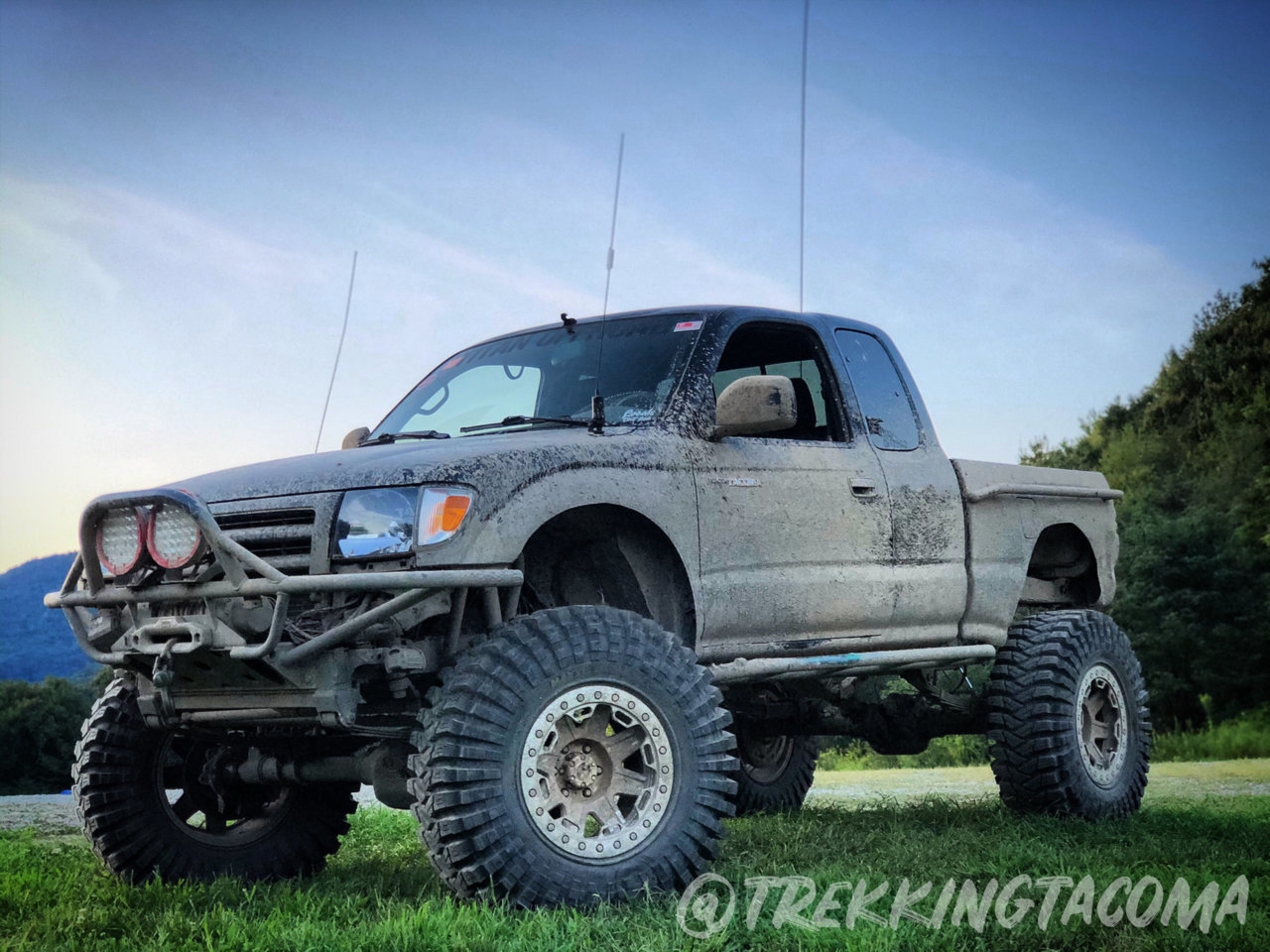

    THE TREKKING TACOMA
    2000 Toyota Tacoma
    3.4 V6
    Suspension
    Trail Gear Solid Axle Swap Kit C
    Trail Gear 3” front springs
    Trail Gear 4” rear springs
    Bilstein 5100’s
    Front Axle
    Rock Assault Housing
    Dirty30 Chromoly shafts
    Six shooter knuckles
    Trail Gear High Steer Kit
    ARB Air Locker
    4:88 gears
    Rear Axle
    Rock Assault housing
    Trail Gear chromoly shafts
    Toyota e-locker
    4:88 gears
    Armor
    Addicted OffRoad front bumper
    Trail Gear sliders
    Trail Gear transfer case skid
    (coming soon) Custom swingout rear bumper
    Bed sliders
    Wheels/Tires
    37x13.50r17 Cooper STT Pros
    17x9 Vision Steel wheels
    Total Metal Innovations DIY beadlocks
    Interior/Comms
    Scion tC seats
    Pioneer Bluetooth stereo
    Kicker CS speakers
    President Andy CB radio
    TYT 9800 quadband radio
    IPad mini w/ram mount
    Other
    Warn m8000 winch w/synthetic line
    ARB Safari snorkel
    Half doors​

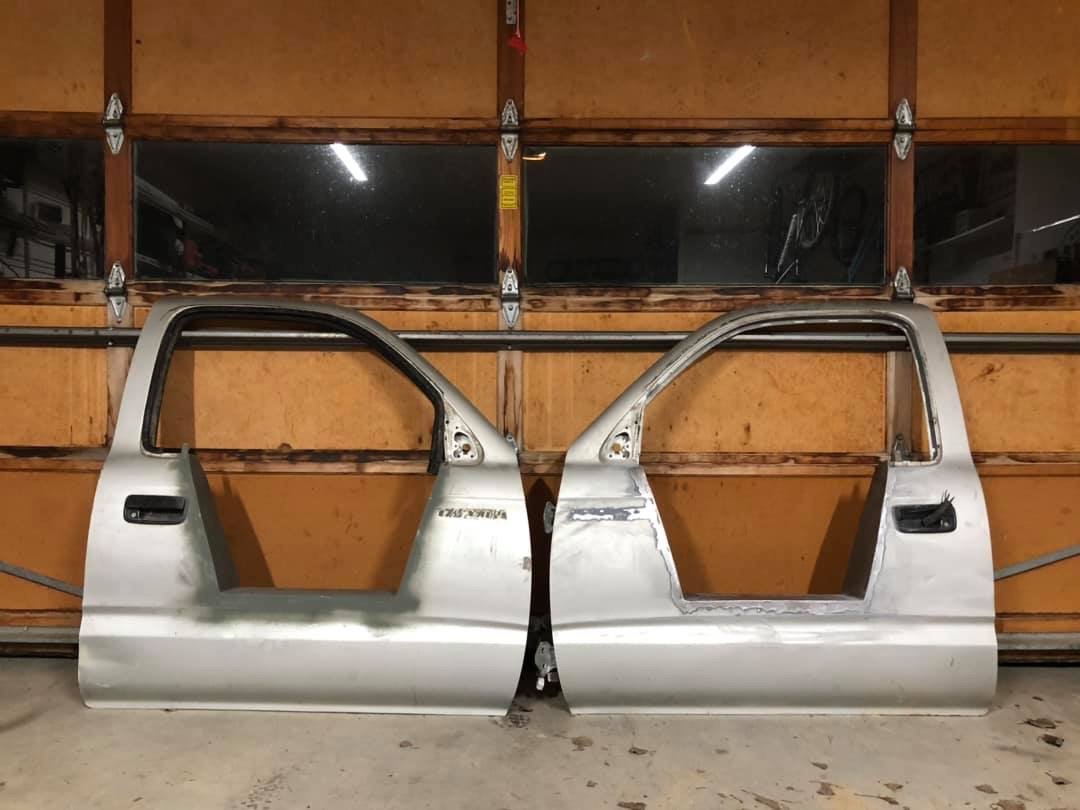

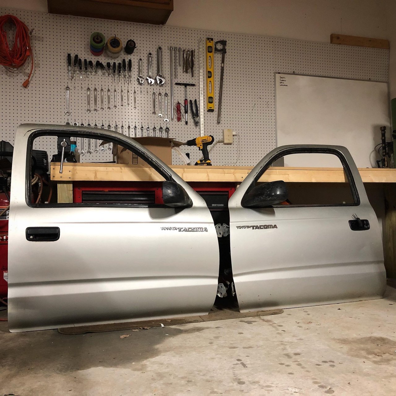

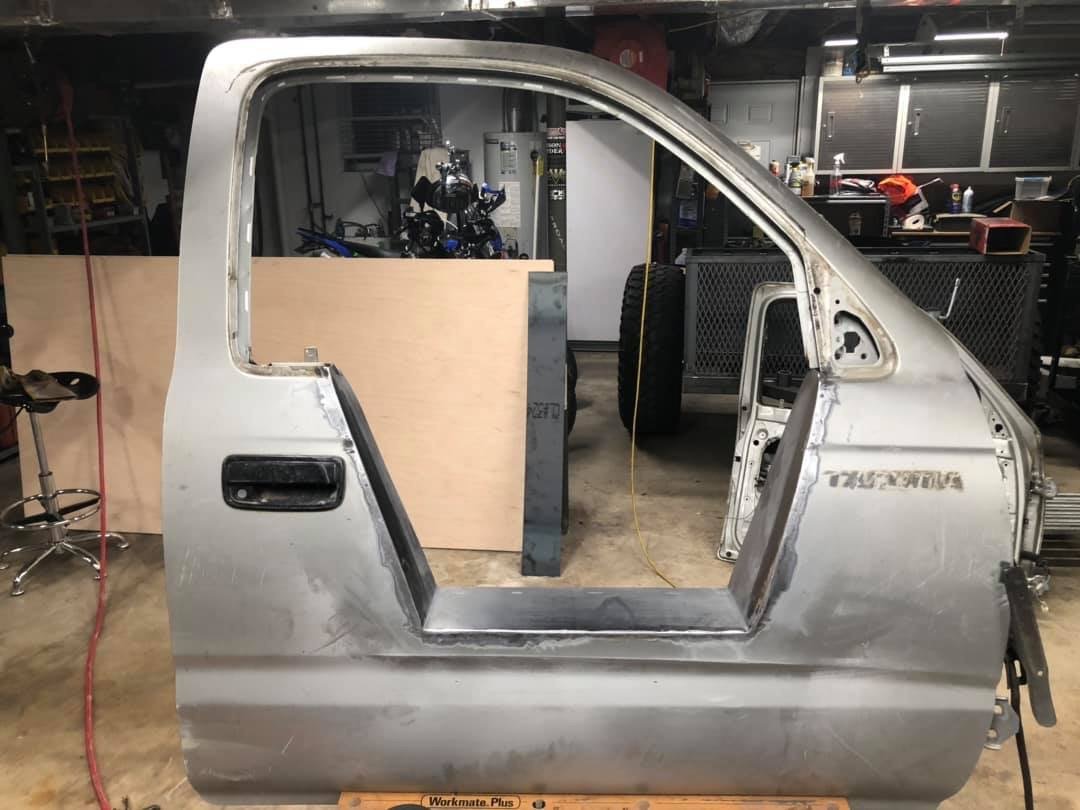

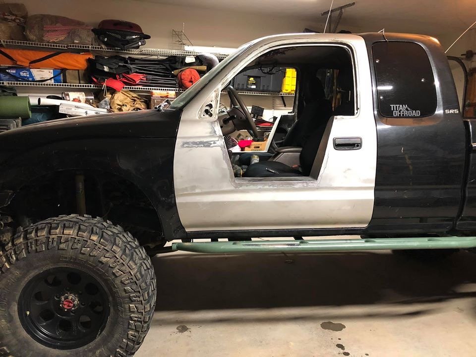

    Half Door Build
    I had a set of half doors on my 4Runner, and never really got to use them before I traded for the Tacoma. So naturally, I had to build another set.
    I picked up these doors off a buddy for $60 for the pair. Looking back, I probably should have sold these and made some money on them.
    Next was time to get cutting. This was more tedious of a process than with other doors, just from the contour of the interior of the doors. Nothing in there is straight. Cut the outer skin, and lined up the inside as much as possible to make it straight. Did a pretty decent job with it.
    Got some steel cut from a friend at his shop, and went to another buddies and got them bent up and welded in. Did most of the welding myself, once we got the settings set. Nothing to brag about, but it holds! 1” stitch welds all the way down then lots of grinding! Also had a few 1” steel scraps that we used to brace the inside of the doors.
    Got them home and got the speakers wired back in and threw them on the truck, just to check and make sure everything was good. Good to go!
    Sprayed some black on them, threw the mirrors on, and called it good! Still have a few things I need to finish on them:
    - finish the inside of the doors
    - cup holders
    - add some rubber finish on the rough edges
    After that, they’ll be good to go, but they’ve made it through one wheeling season so far with no issues. Just some fine tuning and they’ll be finished.

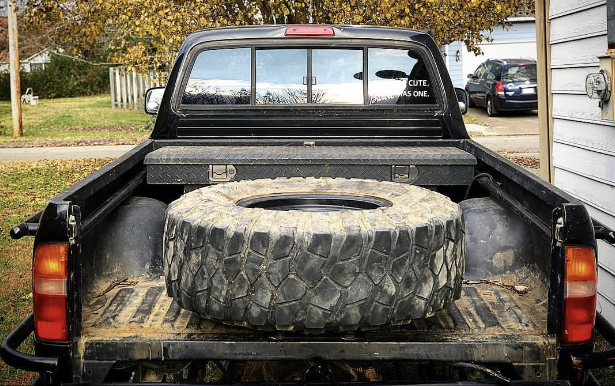

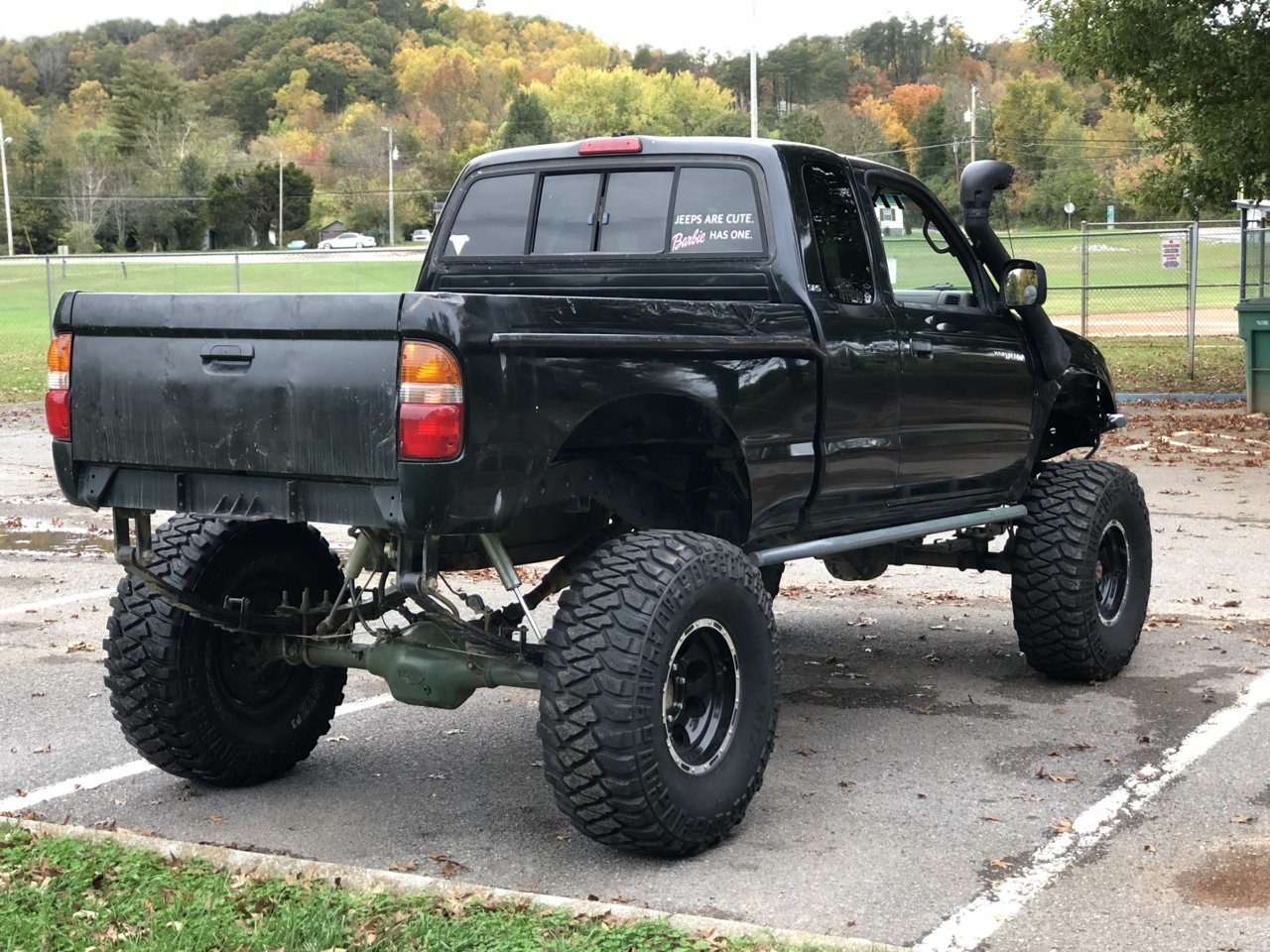

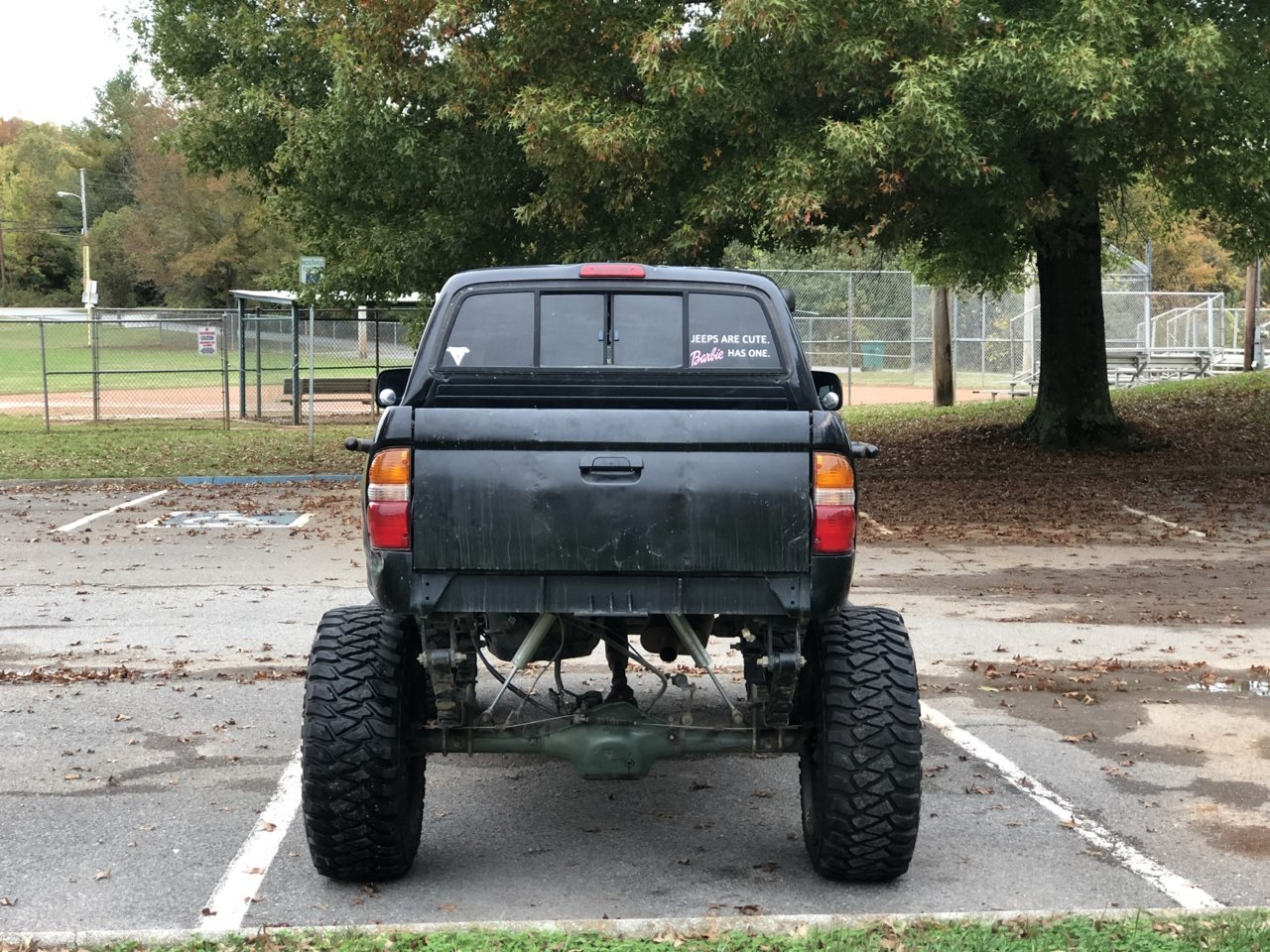

    What can you tell about the exterior bed handle?
    How was it mounted in the bed?
  5. Dec 30, 2019 at 2:40 PM
    TrekkingTacoma
    TrekkingTacoma [OP] Well-Known Member
    Jul 15, 2018
    #259454
    64
    Evan
    Knoxville, Tennessee
    2000 SAS Toyota Tacoma
    The “bed sliders”. Outside bar, with a bar mirrored on the inside. Cut through the the bed and connected there. Welded front and rear directly to the floor of the bed.
    Originally, it was built as a full bed rack, but the PO cut it down to fit a camper top. Not a fan of that...
    Eventually, when we cage it, the bars will all be redone and cut through and tied into the frame in the rear and up by the cab as well.
