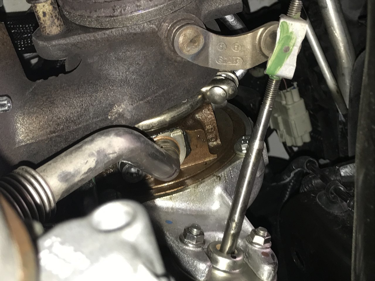

    While you’re at it, I would order some new turbo oil supply line gaskets. A lot of times from the factory they are over tightened and tend to leak under pressure. Easy fix when doing all the fun stuff you’re about to do

    This was one of mine. You can see how the black rubber gasket is crushed. Causes oil to leak out and run down supply line and drip on ground. You can see the sprayed oil from when under heavy boost it’s forced out onto back of turbo

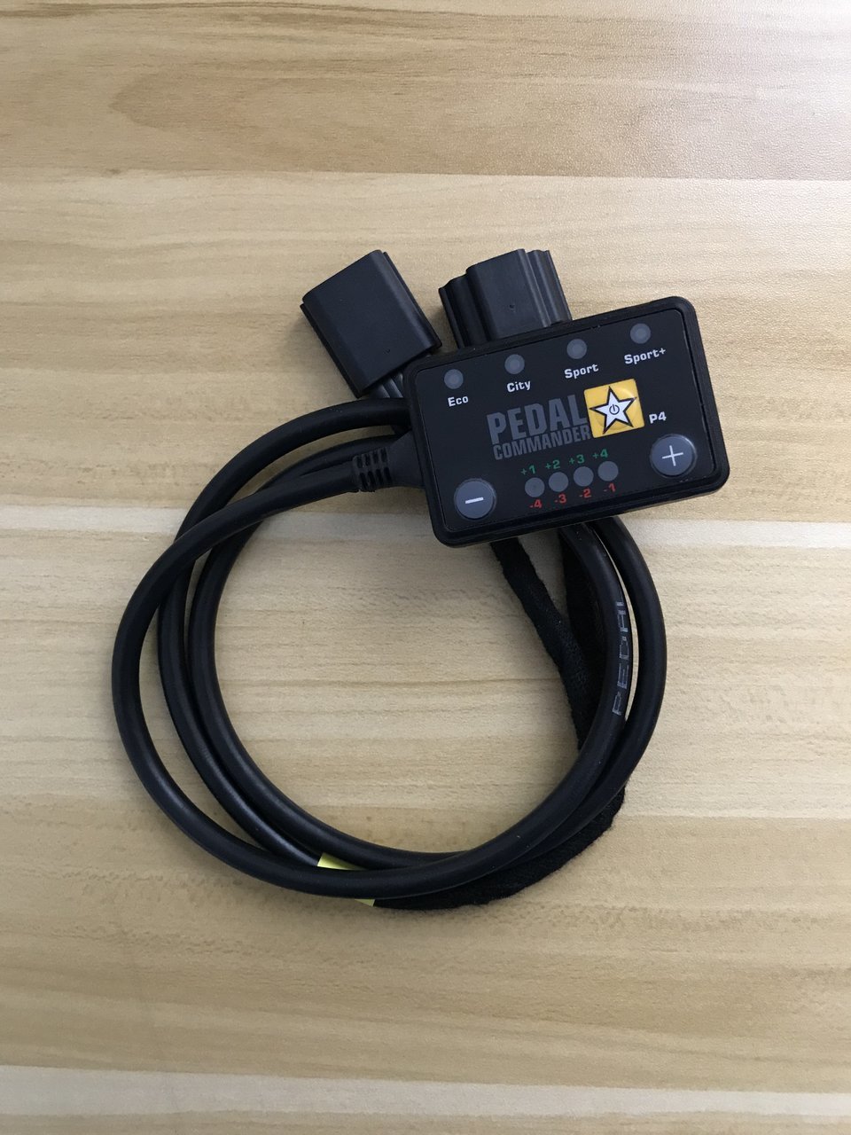

    Got the pedal commander, installing it now but won’t actually be able to drive the truck today since the roads still suck.
    I thought this thing was bigger, I pulled it out and it’s this tiny little box? Like wut

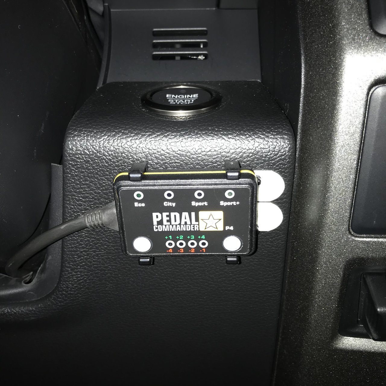

    Lots of guys hide it in the little cubby hole right above your foot behind the beginning of the console. You can just tuck it in there and not have to mount anything

    I thought about that but it’s so small, it doesn’t bother me. I just stuck it on with command strips under the start button. That way it doesn’t leave a mark if I want to move it.

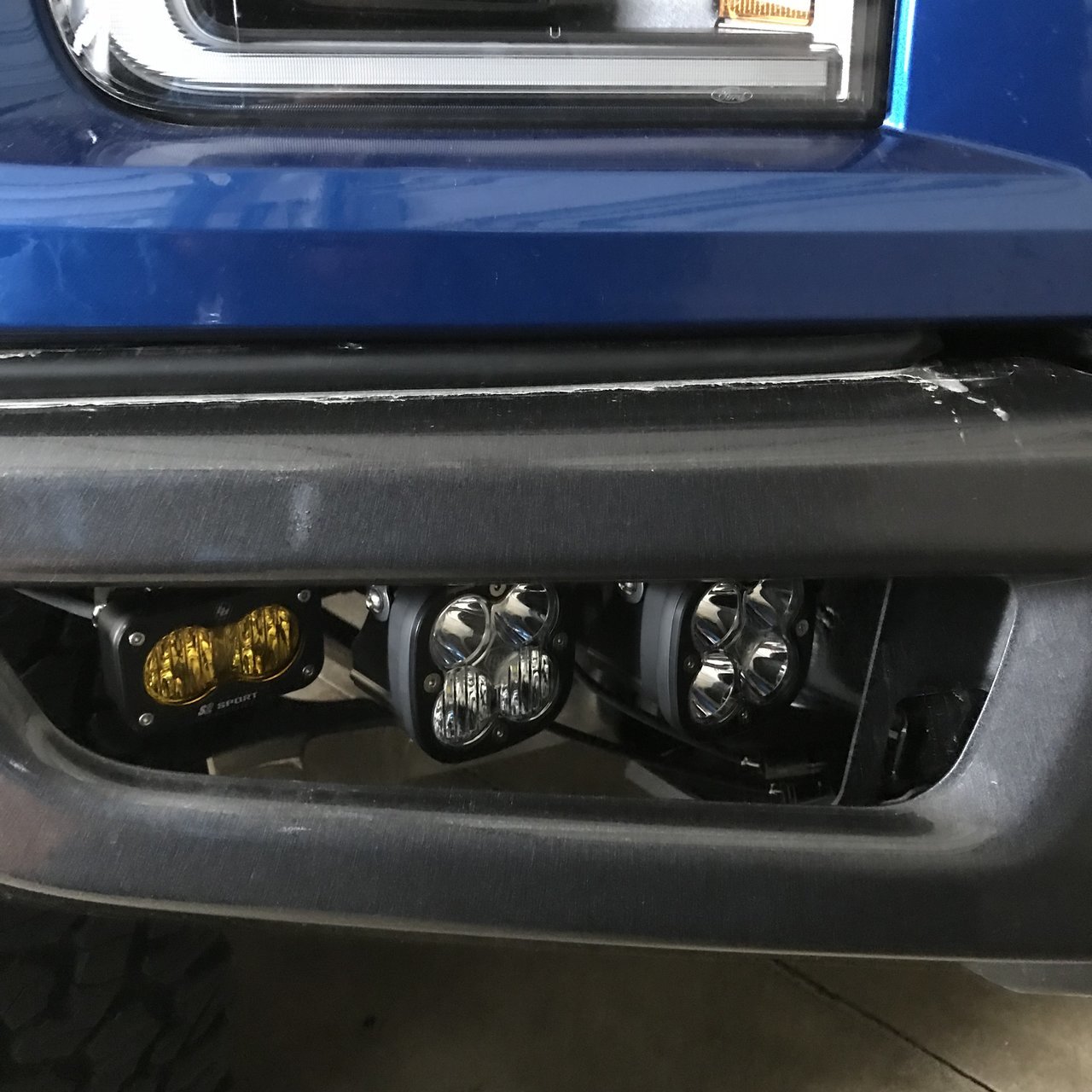

    Got the fog lights mounted up and a few other things done. Will be trying to wire these in to AUX 4 (Flood/Spots), and AUX 5 (S2s).
    Weather looks good this week, might be able to drive this truck a bit :D

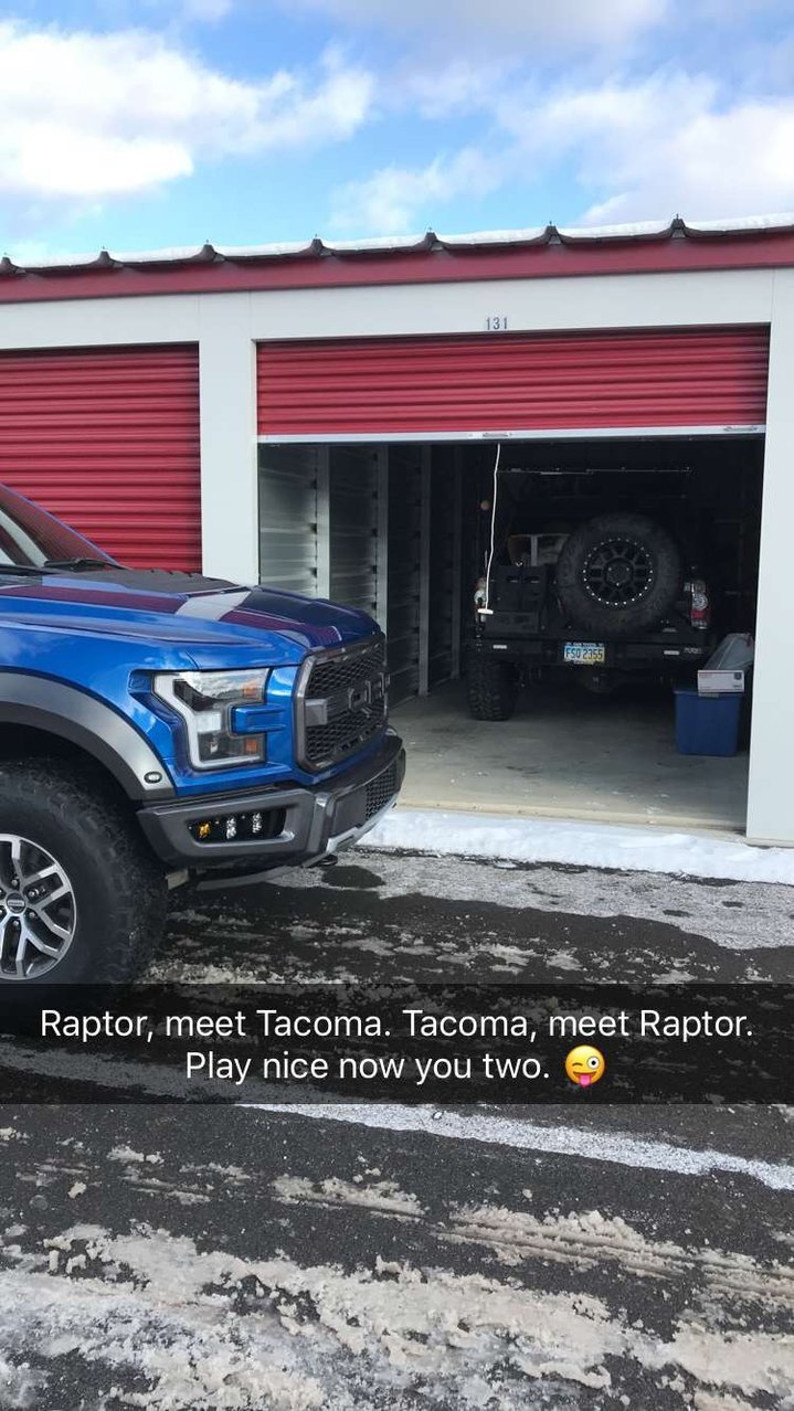

    I took it to meet the Tacoma too.

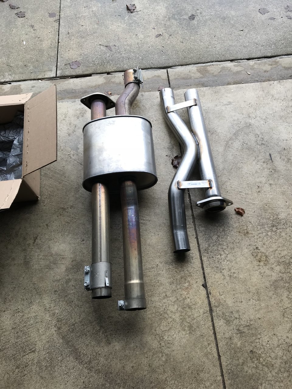

    Bit quiet in here! I’ve been doing some little things to this but the biggest one was the Corsa X-Pipe so far. Tomorrow I’ll throw on the SPD turbo Adapters.
    I love the way it sounds without the resonator.

    Audio clip of the goodness!?
