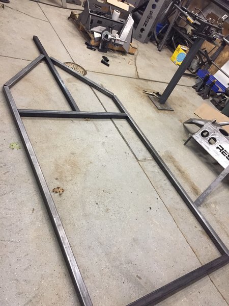

    Purchased an older M100 military trailer over the summer but realized it won't work out how I'd like it to...
    So, I am starting my custom home built trailer early.
    Specs
    Total Length w/hitch: 12'
    Tub Exterior: 52"W x 72"L x 28"H
    Tub Interior; 50"W x 70"L x 27"H
    Frame
    2" x 2" 3/16" Square Tubing
    2x 1/8" Gussets on every 90*
    Tub/Body
    1" x 1" 1/8" Square Tubing
    1" x 2" 1/8" Rectangular Tubing
    14ga. Sheet
    Axle/Suspension
    Southwest Wheel Company 3500k axle -- 67" long
    Pro Comp YJ 4" Lift Springs
    -2 leafs removed
    Bilstein Shocks?
    WFO spring mounts
    5" shackles
    Wheels/Tires
    Toyota Tacoma 16" Factory Steel Wheels
    245/75/16 Mastercraft Courser MT
    Misc.
    Curt 5k Tongue Jack 15" Travel
    LED marker/turn/tail lights
    Gear
    Max Coupler Hitch 6k
    Indel B TF51A
    Tepui Kukenam RTT
    Tongue Box for Storage
    Camco Jack Pads

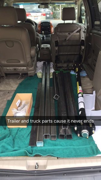

    Found these hidden at work and they let me take them for free!

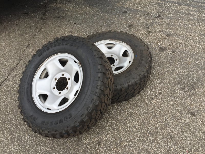

    Also mine

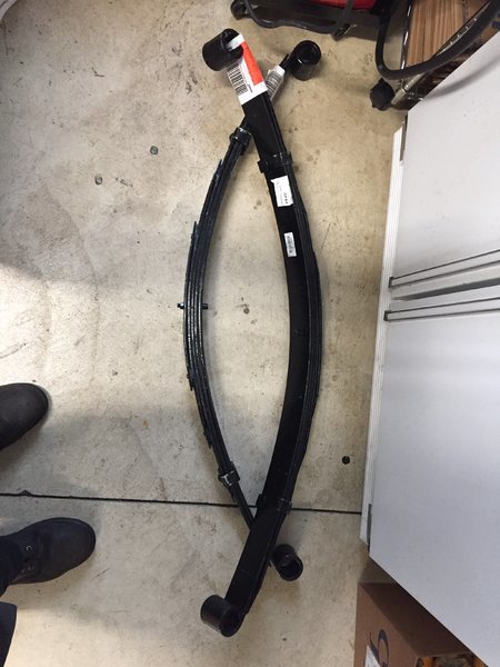

    Those YJ Springs might be on the stiff side. Coming from a former YJ owner that had 4 inch lift Springs and went to 2 inch springs. Much better. XJ stock leafs are even better.

    I will note that, but following a few of the builds on here, they have used these YJ springs and seem to be okay with them. If they do really start to suck, I can always swap them

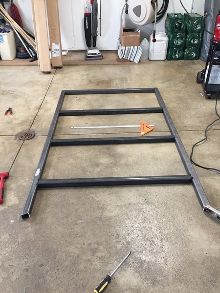

    We accidentally measured and cut the tubes incorrectly so now the axle is too short... about 4" too short..
    So,
    Will be sending it back and picking up a new one.
    BUT it's looking great!!
    Total trailer length will be 11'
    Tub dimensions 72"L x 52"W
    ChadsPride and medic2230 like this.

    2" tubing and it came out 4" too wide I think I know how it got incorrectly measured lol
    That extra 4" will be nice in the long run :)

    Haha! Yeah.. we didn't cut the 48" crossmemebers first and when we finished cutting all the angles we put it together and realized we screwed it up but that extra 4" of room might be nice and now the trailer will match the width of the truck too. it was originally going to be narrower

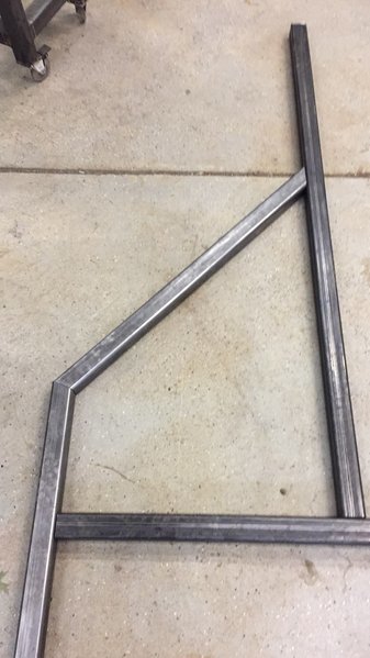

    It's looking good so far
