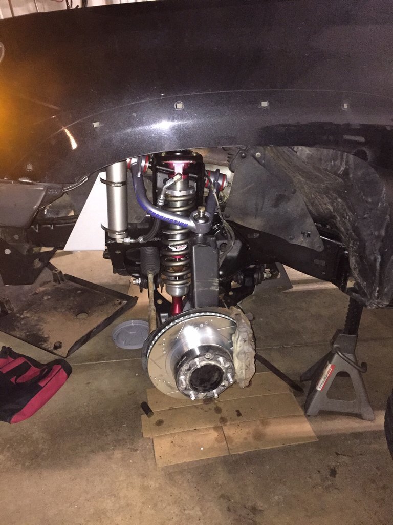

    Got the front end finished up yesterday.
    Newly rebuilt; re-bodied, re-valved coil overs with reservoirs added as well. Also put new rotors and pads on which caused my front calipers to seize and needed to new calipers so figured I'd add new braided lines up front too. Also relaxed a bad axle up front.
    New Total Chaos UCAs installed.

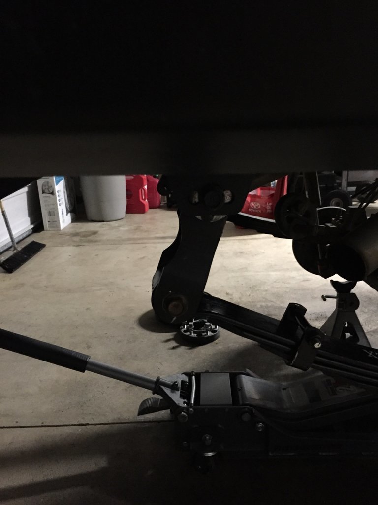

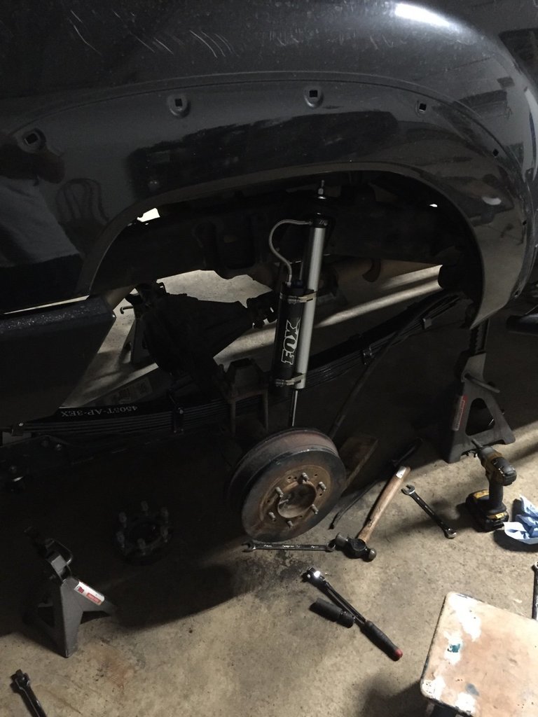

    Next up is the rear with new All Pro expo leaf springs and 12" Fox shocks with CDC reservoirs.
    -Yes I found a way to make a 12" shock fit in stock locations!
    -New calipers added after this picture was taken.
    And to make @loco happy, flipped my XJ shackles in the (correct?) direction.

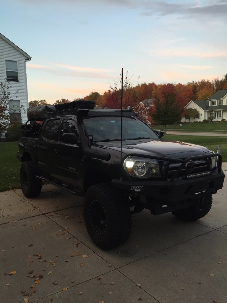

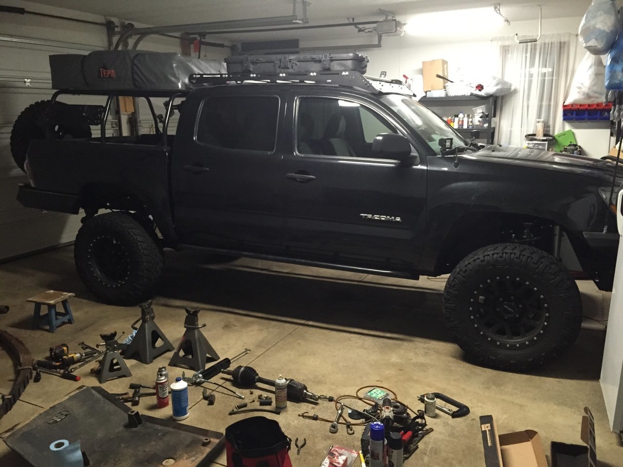

    She is officially back on all fours after a total of 8 weeks and 5 days. 803d42fc1b2d3f8b9eb94d515fd25cf8_e1b609367c209061ad54fcf11716e98b5abb2306.jpg

    NICE build! I'm curious about those 12" shocks on the rear... they fit in the stock locations, but what about up travel when compressed? You have the APEX springs with shackle reversal, do you know what travel numbers are you getting from that set-up and how much lift? Just curious since I run those springs too.

    Not s single clue yet. Just finished it all last night. Once I get it aligned and the springs settle in a bit, I'll go test some stuff and get numbers. I know I need to get a set of timbrens for the rear and possibly limit straps. Just have to play with it a little. I'll update once I figure it out

    You're going to need an inch spacer under timbrens if you go that route.

    What other options do I have? Superbumps would require even more spacing

    Shorter shocks. 12's are too long for stock location and to have any bit of up travel left. Although I know how much you like having up travel after our x-country....

    Nah man. This shit works. I have some good up travel still left. I'll measure tonight

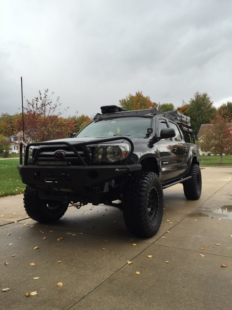

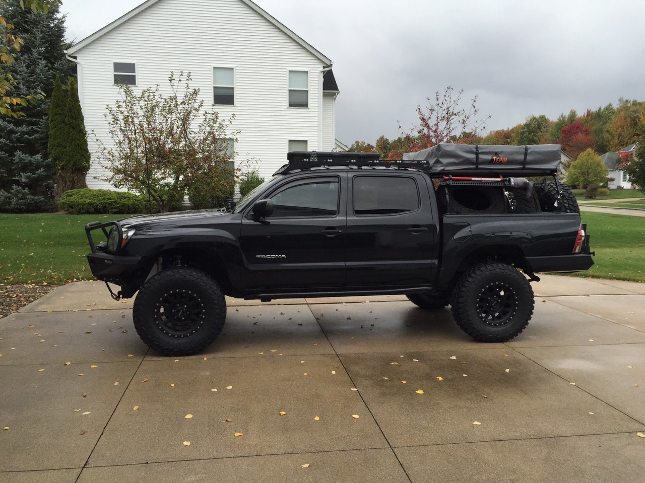

    Feels good to be back on the 315s. Can't wait to try these out in the wild in two weeks!
    -Mastercraft Courser MXTs
    --315/70/17

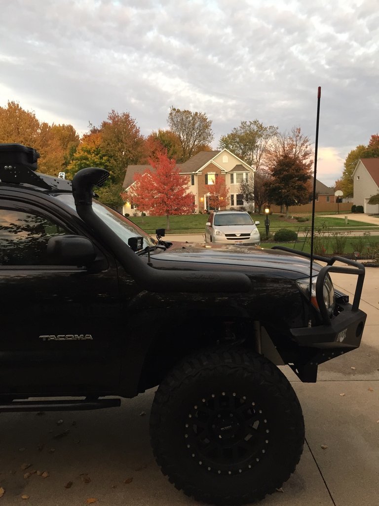

    Got the Safari Snorkel on today. Was more of a workout than I expected it to be.. Sure does look good! 4a54cc6f4a4f2c29222165bcb450db20_8b3ffcae781b56a6392f2aebe12b2e12a0c6f73d.jpg

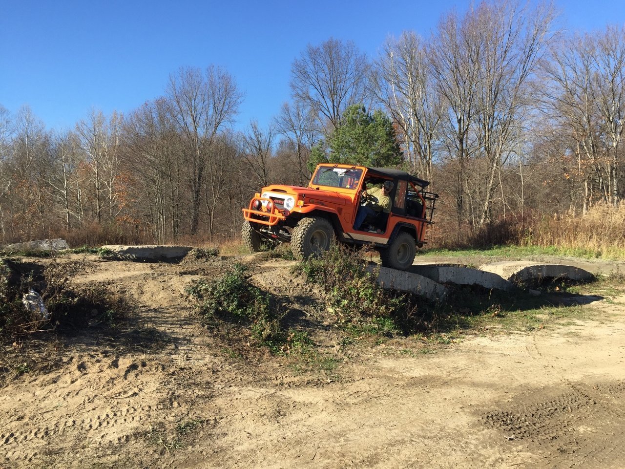

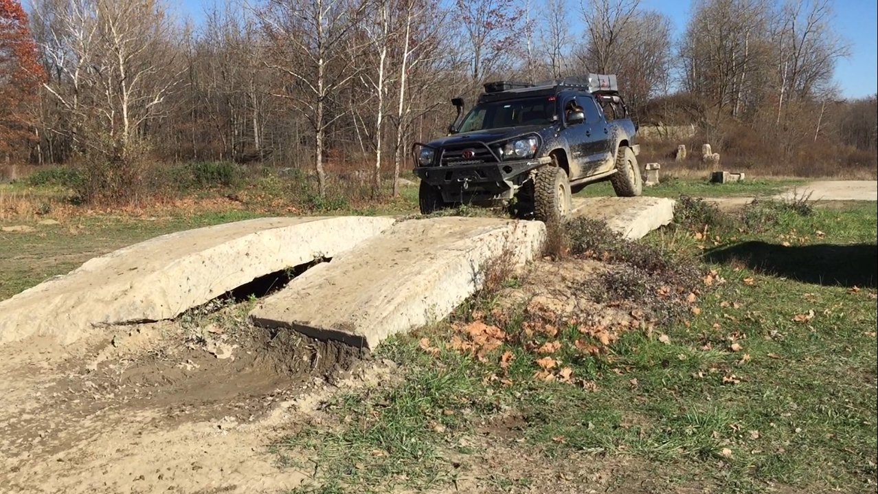

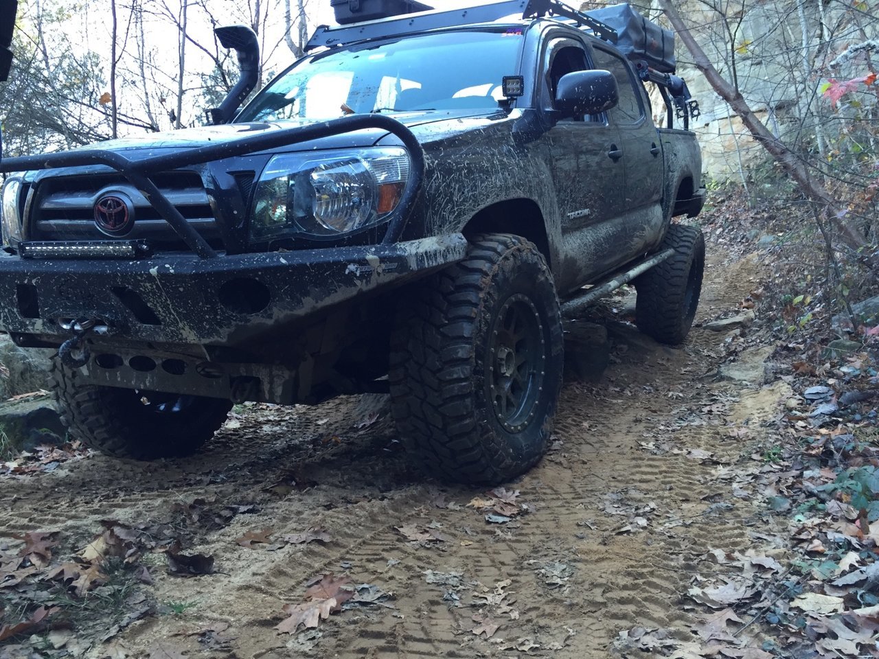

    Went out and had some fun at Southington Off-road today. Good R&D... 345e4cc8eb8d33791520f88a4625b6e6_df5676b770cc764cf724e5d49422e71d15ebdf47.jpg58d3d35832ace1bd361de215856df911_b3aa6f5c5b38ea9aa1c2cd007149f548362e8135.jpg15ccd12524d4bb9992d36614c04a1e9e_e645d4925ff8e255f81b0ab840cdeb1179f3b275.jpg
    Then wheeled with a new friend and his legendary rig

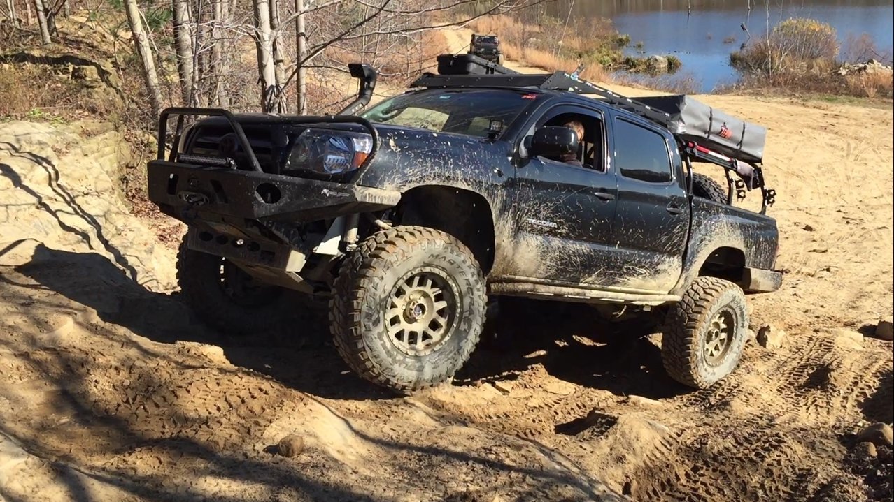

  18. Nov 8, 2015 at 6:29 PM
