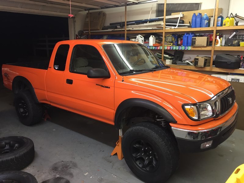

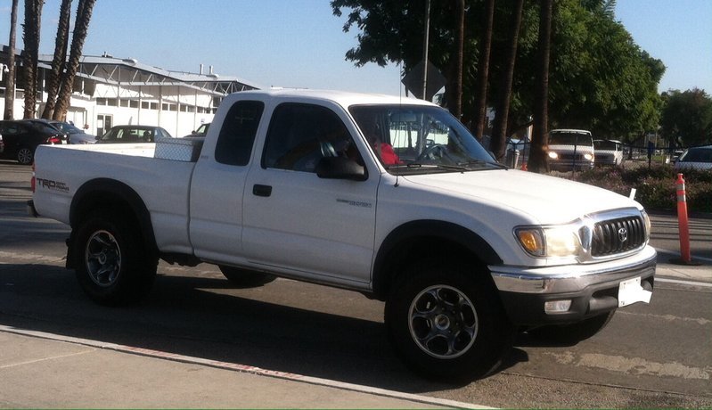

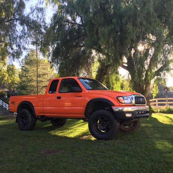

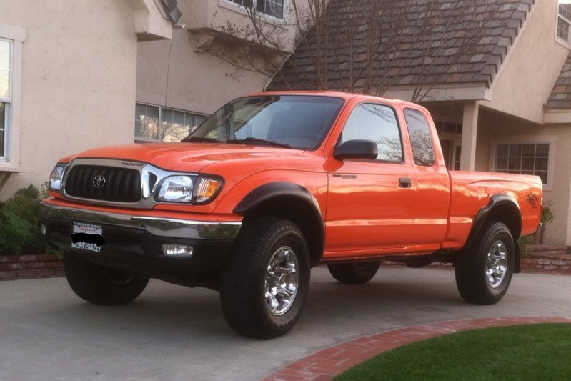

    This is my 2001 Xtra cab Prerunner (2.7L...) as it sits today. Got it Christmas of 2014 as my present/project. Dad bought it for $4,500 with 123k miles with a lot of work to be done...

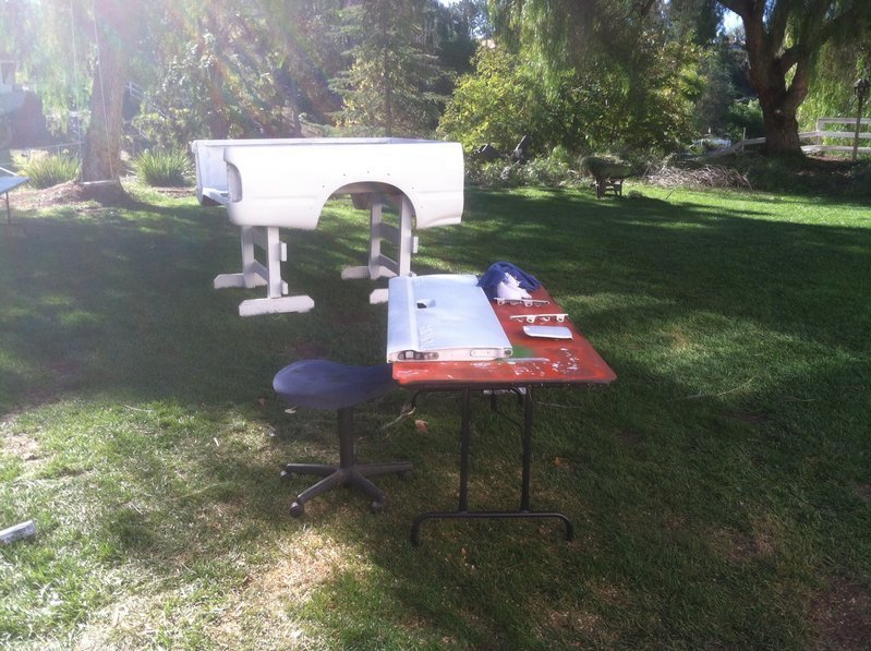

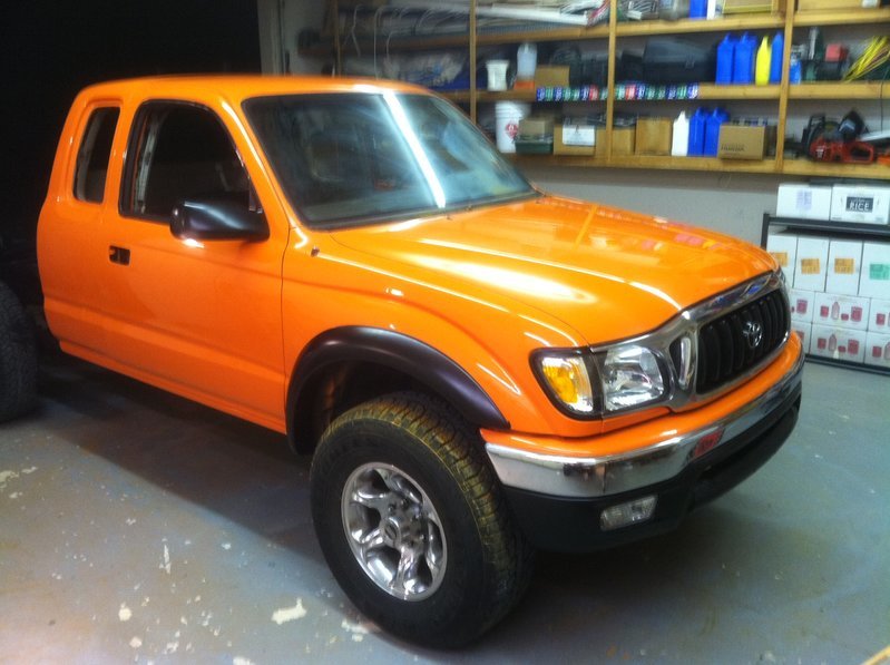

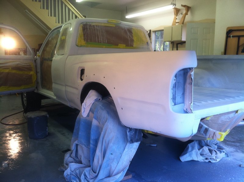

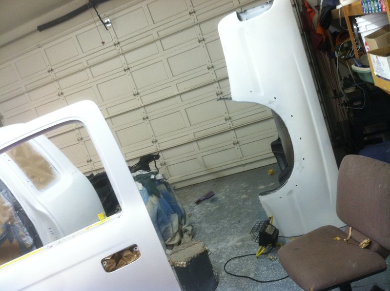

    Dad said we're gonna paint this ASAP! Christmas night I began to take everything apart for sanding and prep work.
    1/1/15
    1/2/15
    1/5/15
    1/10/15
    1/24/15

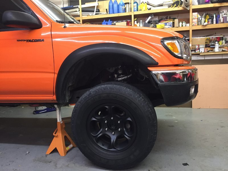

    Paint complete with raptorliner. All new lights up front from ebay for $60. Got seats redone, when they were done my little bro and I fell asleep in them in the Garage till 4 a.m. Lol

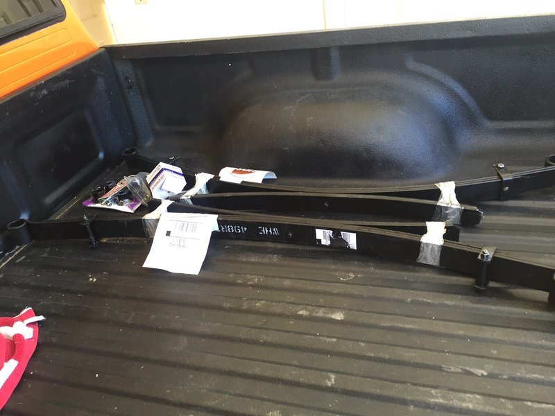

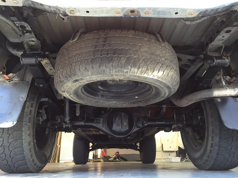

    Installed wheeler's 4 pack $550 I believe
    Looking back I wish I did a Deaver pack or not even touch the springs at all... The wheeler's have been a pain because the driver side is stiffer than the passenger so I needed a 1/2" block to compensate the difference.

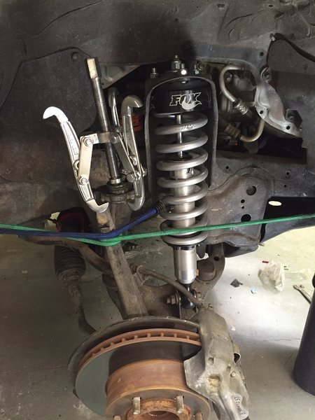

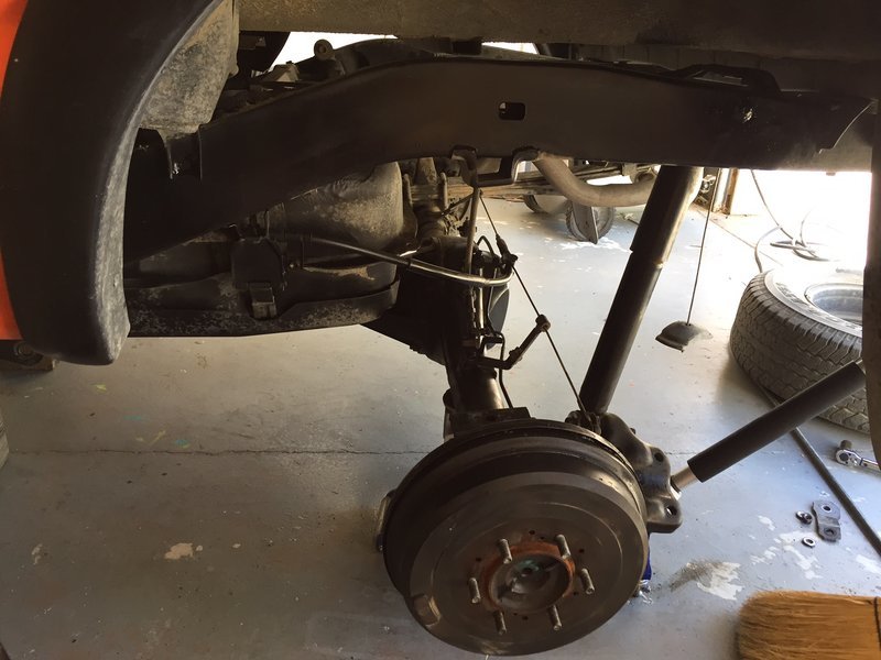

    I forgot when I installed my 2" spacer... well before the leaf springs
    6/27/16
    (Truck is off the ground BTW)

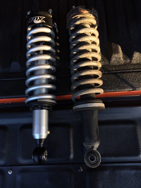

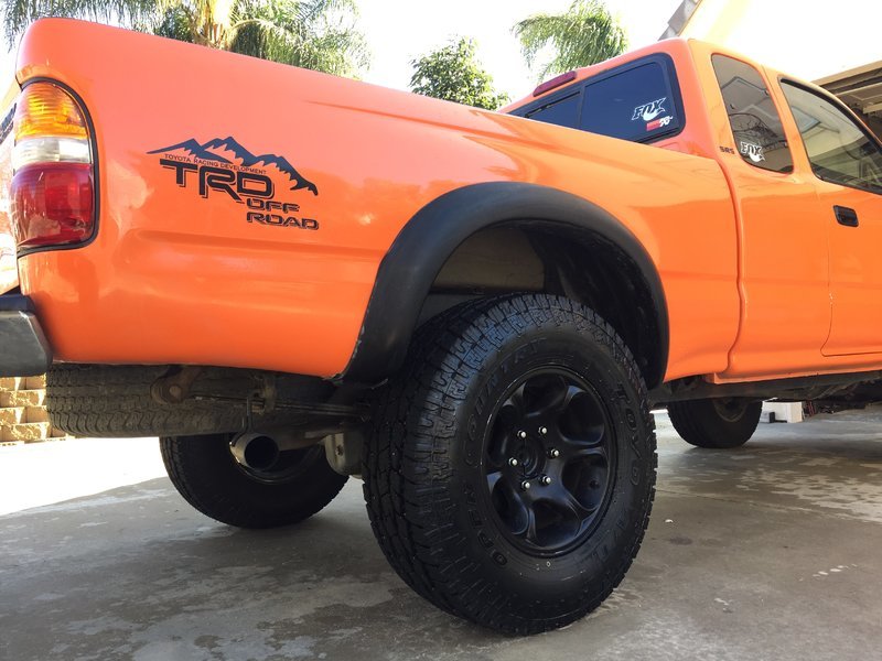

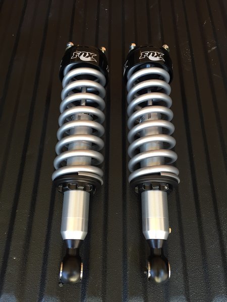

    I was done with the spacer so I dropped $900 for FOX 2.0's Installed them myself in 50 Mins
    Love them! Selling them with in the next few weeks/months for Bigger c/o's

    Rears finally came in ~$280

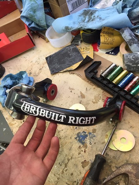

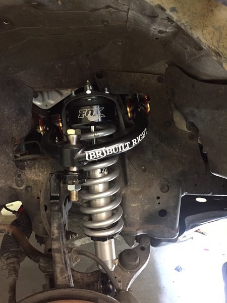

    Bought Built Right UCA's from The Truck Shop. $550 out the door
    Got an aliment and it felt smoother because the tires were on the ground much more betta

    With FOX 2.0's and Built Right UCA's

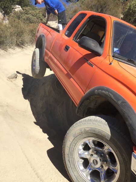

    Black diamond jeep trail. In a 2WD with open dif :crapstorm:
    Good thing my Dad had his 2005 4x4 Durmax :thumbsup:

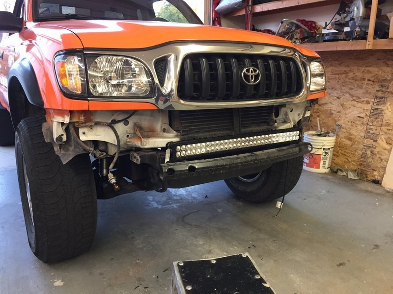

    12/8/16

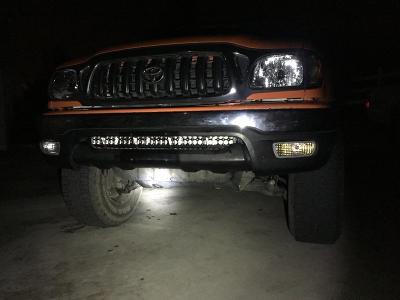

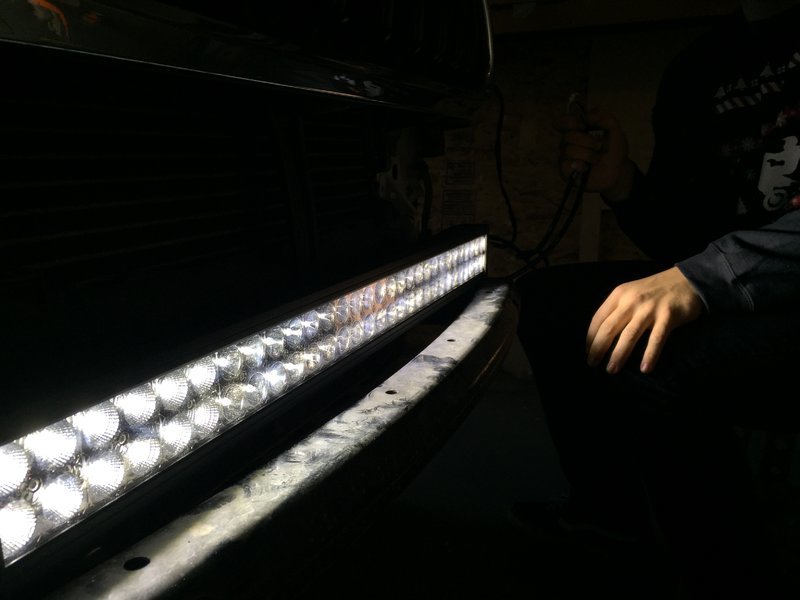

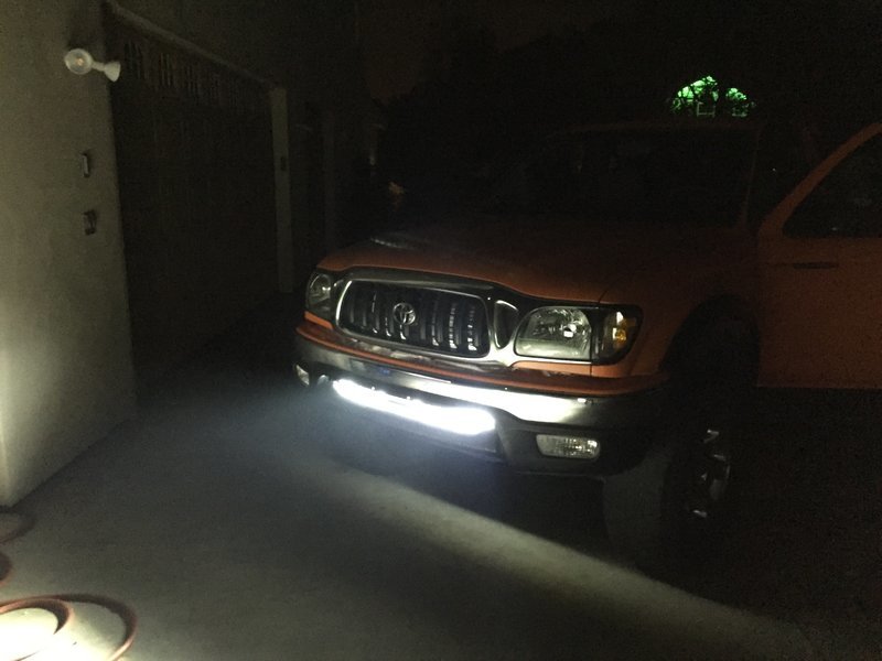

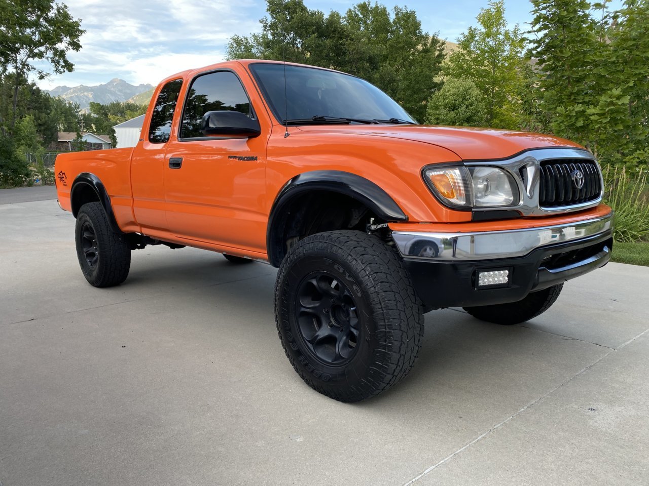

    32" LED light bar $36 Amazon and $12 for wire harness
    The bar is 31.5" long which happens to be the distance of the outsides of the frame. I got Aluminum 90 degree stuff that was laying around and bolted it to the bar and screwed into the frame.
    People have no idea it's there. Unless I turn it on :cool:

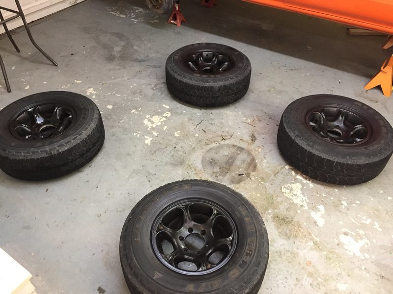

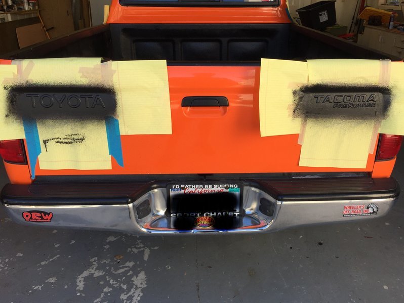

    12/27/16
    Plasti Dipped badges and rims
    FullSizeRender (10).jpg FullSizeRender (9).jpg IMG_9063.jpg IMG_9069 (1).jpg IMG_9085.jpg
    Next up TIRES!

    You need to look into a rear axle swap with one that has a trd locker in it! I am still looking around for one to get for mine. Open diff sucks compaired to a locker

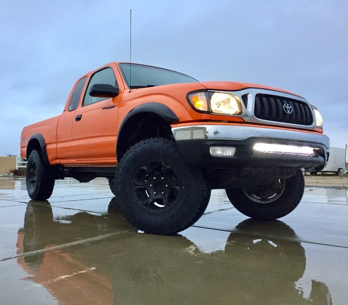

    1/19/17

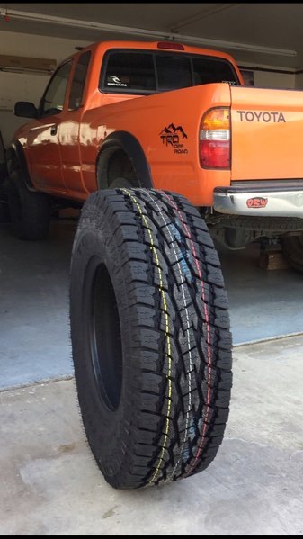

    Toyo AT2 265/75R16 load range C
    $150 a tire $650 out the door at ORW for all 4
    Had them Installed at Ramona Tire since I have a lifetime alignment over there
    $170 for install, alignment, and lifetime for rotation and Balance
    $820....
    Took rear mud flaps off
    since this is a 4 banger the 32's took some power away sadly... but it's worth the look IMO
    Next mod that's not done yet is Led light pods in the old blinker location and blinker relocation mod
    Then rear Led light pods for backup (and tail gaters) in the rear bumper.

    FWIW the driver's side spring is likely stiffer to account for what's commonly known as the "taco lean" where the weight of the gas tank tends to lean the body of the truck to the driver's side over the years due to the weight
