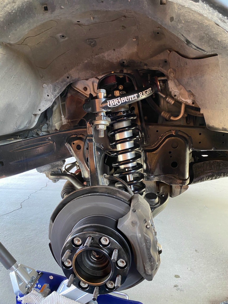

    Nice looking truck man. I have the same set up with the foxes except the deavers and built right ucas. How is the ride with the new ucas?

    Thanks man! How's the lift with the deavers? With the UCA's I noticed the ride was smoother because the tires are now straight up and down to the ground vs angled with stock ugly UCA's as before. I got UCA's Because in the future I may run ext travel 2.5 coilovers :cool:

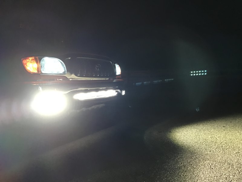

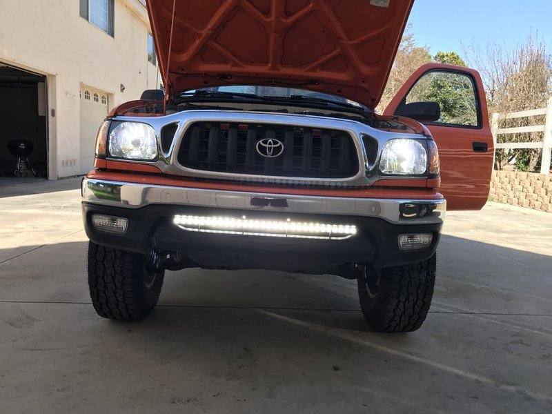

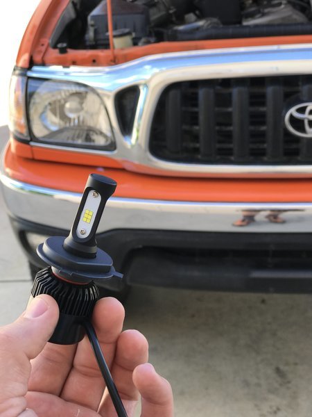

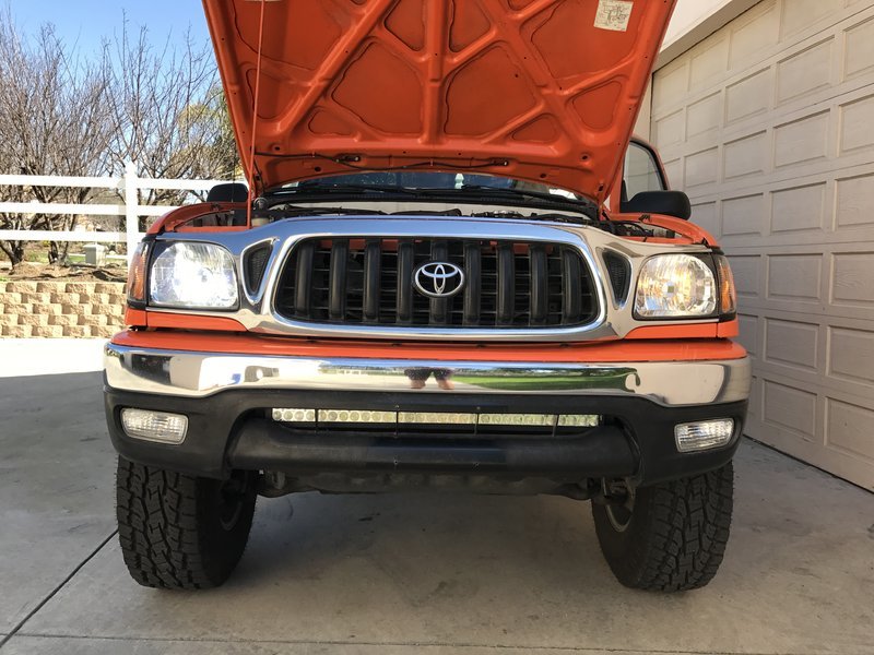

    JDM Astar Head lights! There's a lot of glare because it's a reflective lens but nice bright lights!

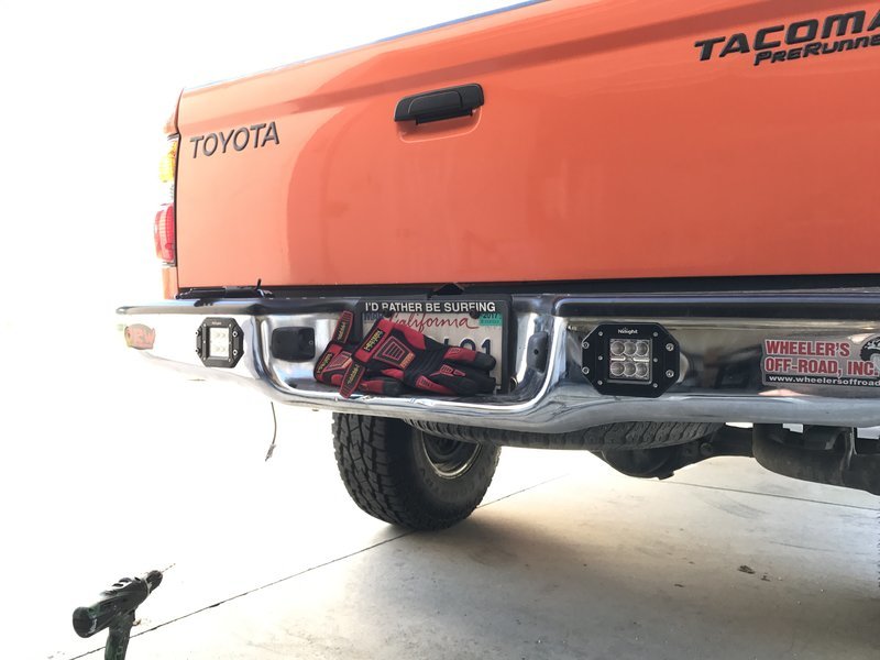

    and 20 dollar Led light pods with flush mount for back up lights.
    I feel bad for other people's eyes...

    Hey I have a question. How do you like those LED headlight? And what brand did you go with?

    JDM Astar G2 60 bucks off Amazon

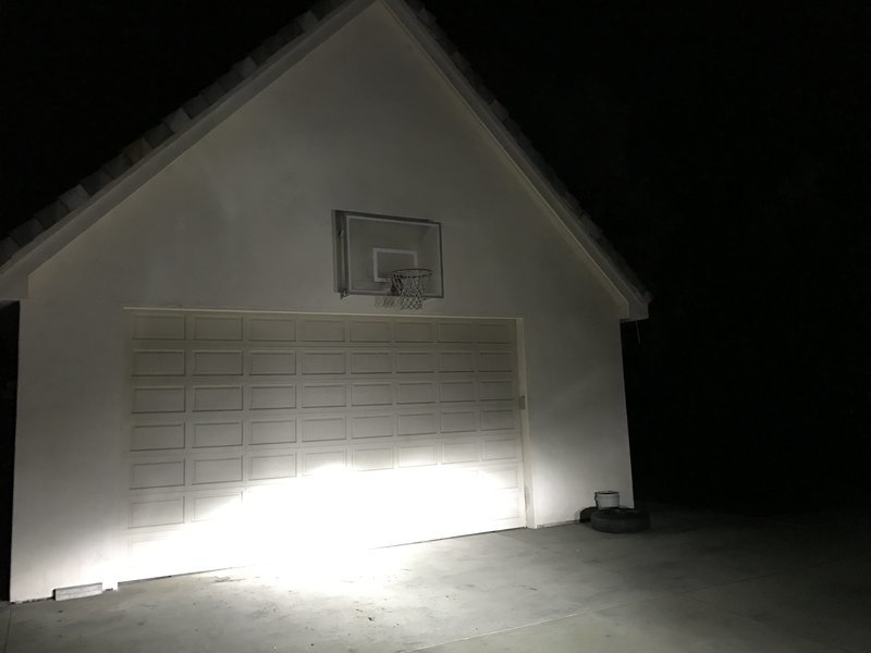

    What I don't like... the whole shop is lit because there's no precise cut off. Other than glaring peoples eyes... I like them a lo! The color is great and really really bright. It even competes with my LED light bar.

    Do your high beams work? Also how hard are they to wire up? I had HIDs for awhile and got sick of them and went back to halogen

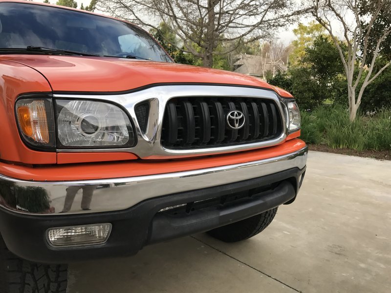

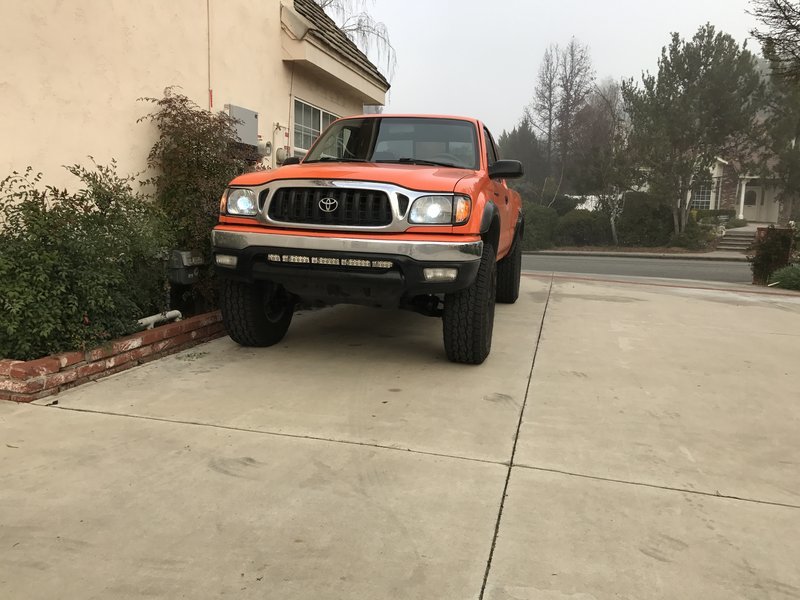

    I ditched the Led headlights because light was going everywhere and I didn't want to deal with angry people shinning their rights and what not. so I went with some HID retrofits in total 75 dollars off Amazon
    I replaced the HID with Zeon and it's a lot better light. (Installed sometime in 2019).

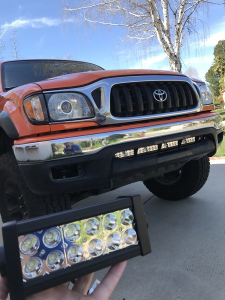

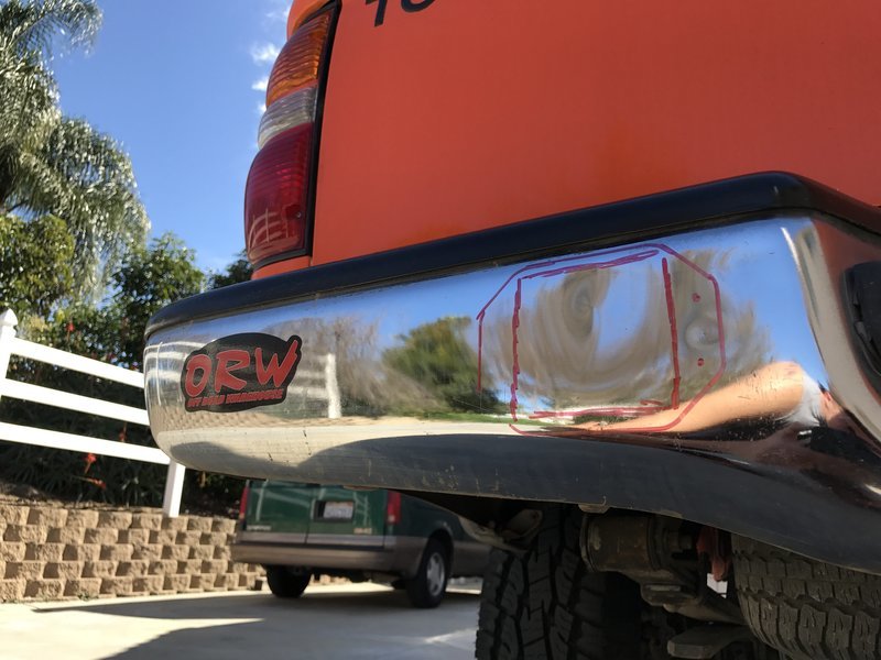

    Next project
    Since my original blinkers were freed up I decided to get some mini led light bars.

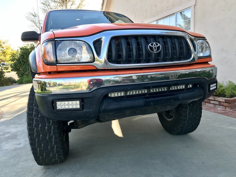

    They turned out pretty good!It took some trimming but fit in nice and tight. They are angled out so it gets the corners really well. I'm pushing 20,000 lumens!!!!

    How'd you mount them in the bumper? Anything special in the back to hold them in?

    nothing special at all. just trimmed it a little to make it more of a rectangle and drilled 2 holes and bolted them in.

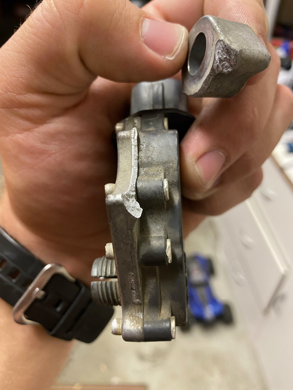

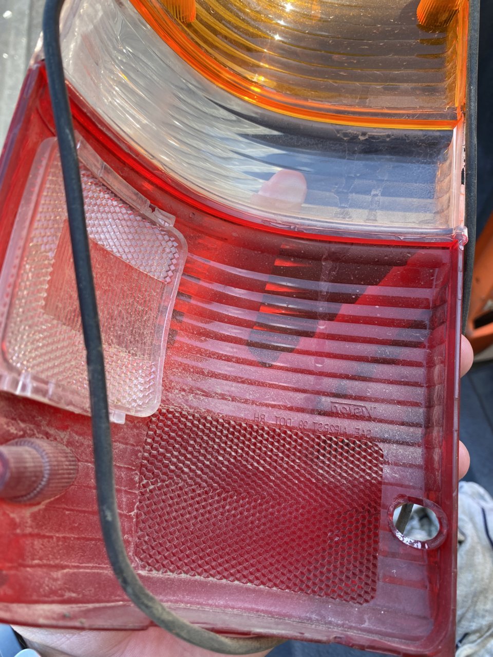

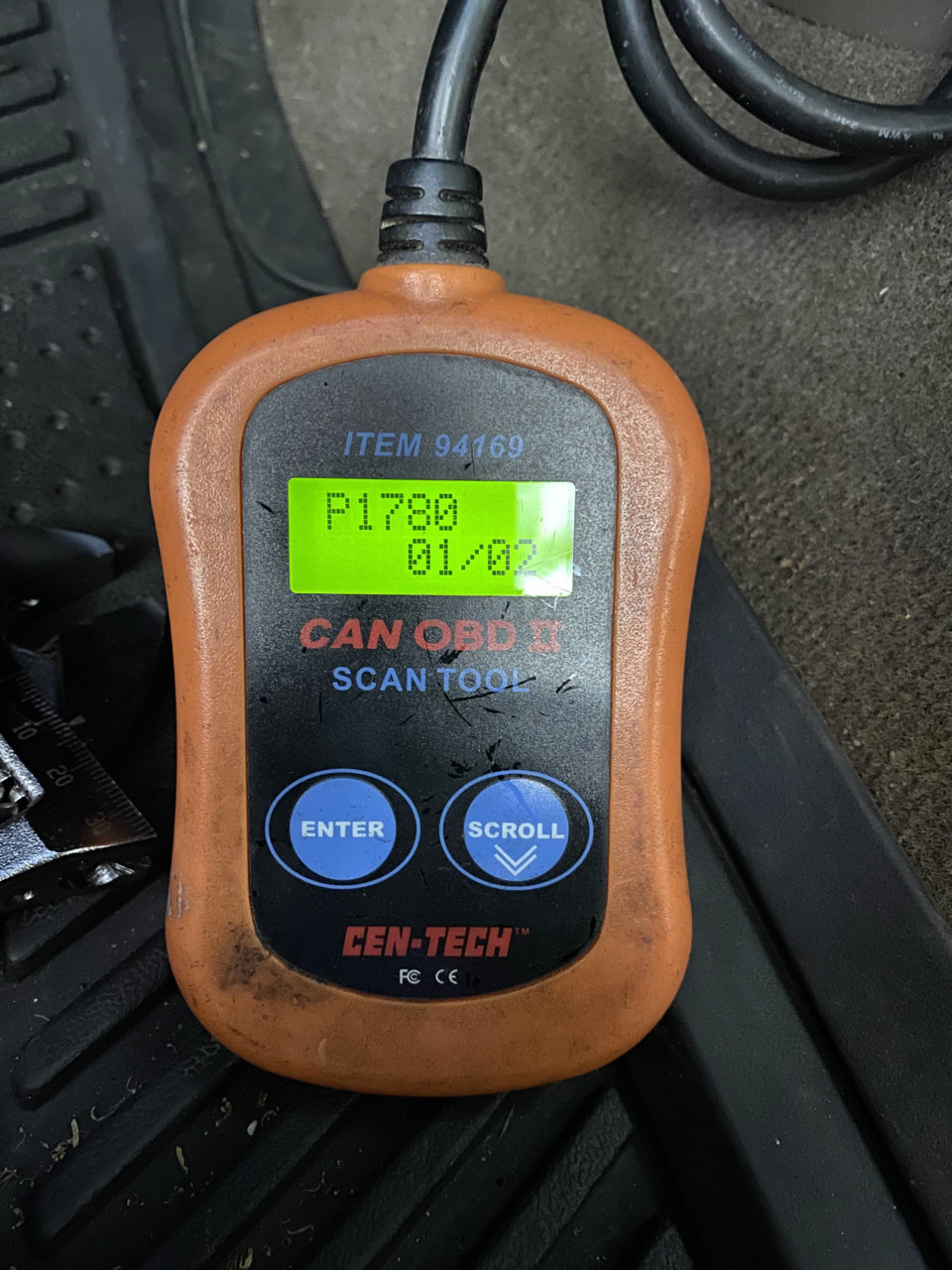

    Got a P1780 code. Truck wouldn't shift into second gear... I was stuck in first, but it was slipping in first. This code is related to the netural switch so I bought a new one, but it still had the code!
    I searched and searched... until I found a guy on TW who recommended to check the brake lights, I took the fuse out and no more code! My passenger brake light had gotten some dirt in there due to the broken piece for the screw (picture below of dirt 3 months before code came) so I patched it up and replaced the bulb and I was good to go!

    I broke the old Neutral switch in the process so I had to keep the new 400 dollar one...
    For some reason my truck only took the one from 2004 even though it's an 2001??? I guess I have an 2004 transmission...?

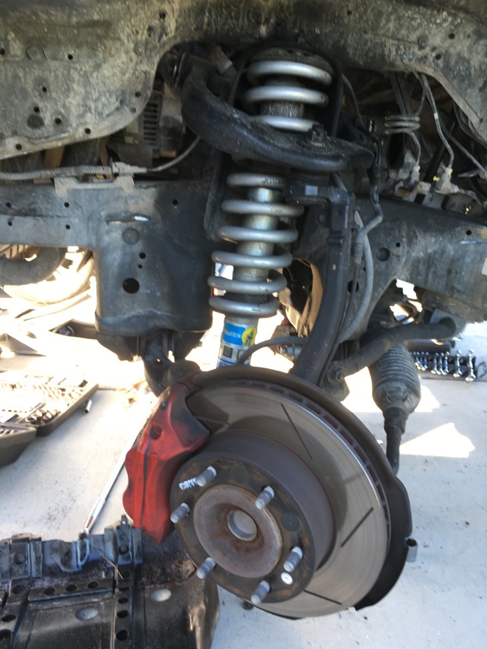

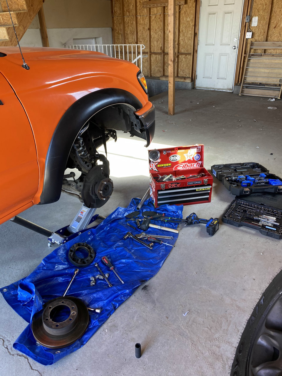

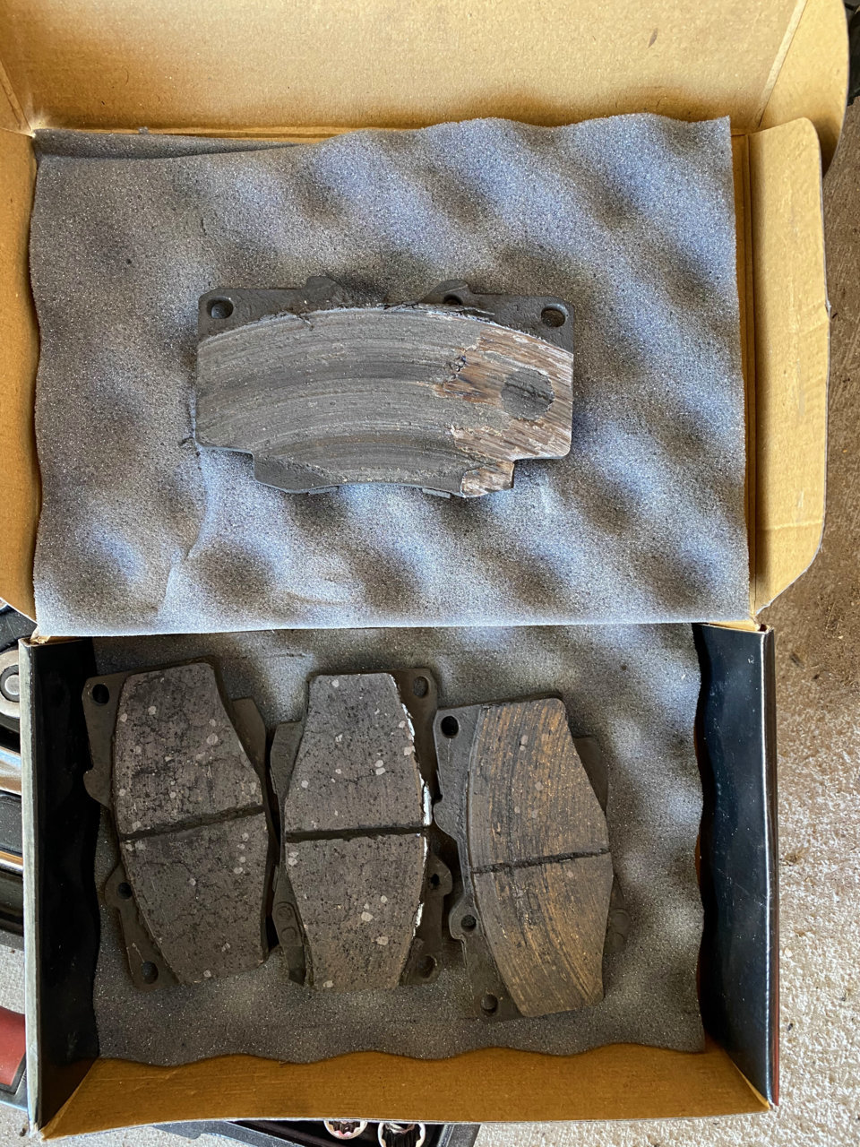

    Changed brake pads and rotors from Autozone. Driver side inside pad was to the metal and the passenger side was at 50%... Weird.

    Running the stop tech Cyro rotors and now hawk pads and noting but good things to say
