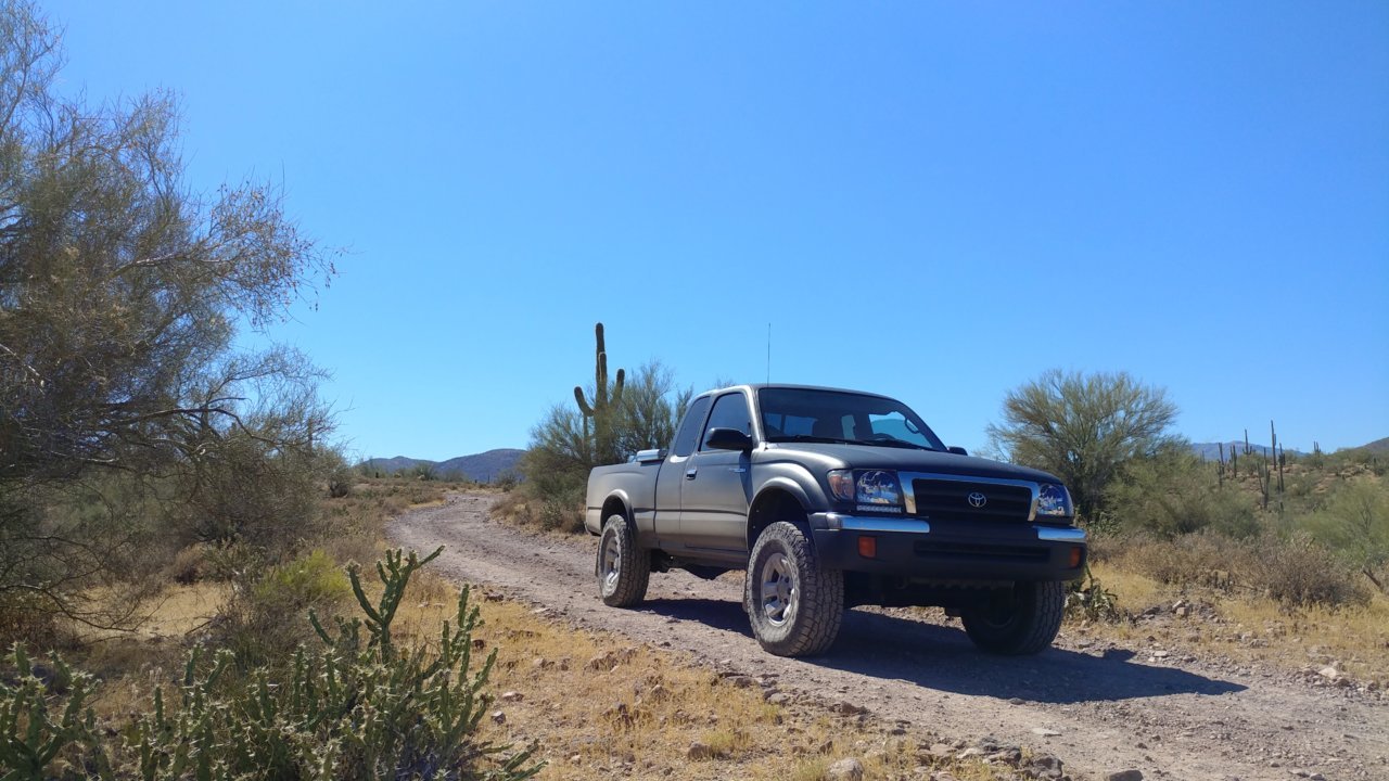

    Figured I should start something even though I'm 8 years in and trying to be done.
    Current Build Highlights:
    - 35x12.5 rear, 35x10.5 front Kenda Klever R/Ts on 17" 3rd gen wheels
    - ADS front coilovers w/clickers
    - Built Right Uniball UCAs
    - Bilstein 5100s in rear + OME Dakar leafs
    - Navy blue Raptor Lined body w/black accents
    - Hood vent over turbo area
    - LCA & SR Poly bushings
    - Twin (modified) Ford Focus K03 turbochargers in parallel, one for each exhaust bank. Single bridged wastegate.
    - Custom interior incl. mass-backed black carpet, fabric dashboard, overhead acoustic foam, vent gauge pod & A-pillar pods, insulation-stuffed dash & panels, matching blue seat belts, nylon door openers

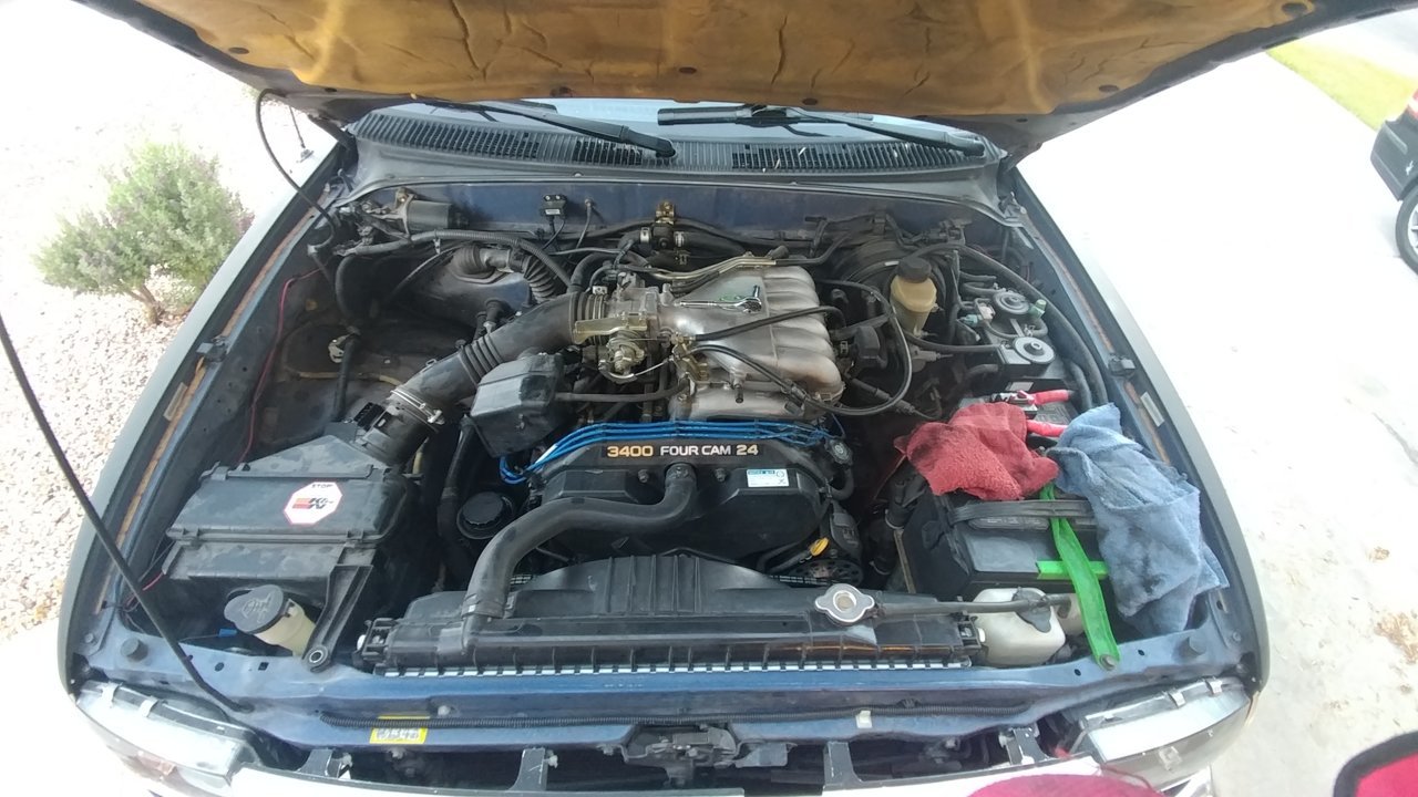

    I bought my first vehicle ever, my 1999 Tacoma Prerunner SR5 Doublecab at 68,000 miles from an old man out in Phoenix, AZ, when I was 19. I lost my data backups so here's roughly what it looked like (minus the weatherguards):
    I come from a family with no car experience other than oil changes, and told myself that was going to change.
    There were a few issues off the bat from a truck that had been sitting so long in the desert, so dirty I got replacing the TPS, resealing the charcoal canister, replacing the O2 sensors and catalytic converter, and probably some other things I'm forgetting.
    Poor fuel economy led me to a journey of an itch I couldn't scratch, involving changing all fluids, seafoaming through the brake booster hose, and just a general tune-up over the first couple years.
    Realized I could get some cheap but good suspension upgrades with Bilstein 5100s + OME so that's what I did, and I learned a lot from that 8 hour nightmare!
    Throughout this experience I started to get neurotic about sounds, noises, and rattles, as I simultaneously gathered some minimum wage cash for my first sound system. This all quickly lead to a complete dissection of the interior: asphalt paper and open cell foam on the floor, full on 1-2" acoustic foam adhered to the ceiling, denim insulation in the dash and side panels - pretty much anywhere it would fit and not get wet, multiple attempts at sealing the door panels better and with much thicker MDF, doubling up on door and window seals, and putting cloth and insulation underlay on the dash and A pillars. The result was probably the quietest 1st gen interior out there. FYI, the biggest source of wind noise are the front windows - to fix this you really need thicker glass, or some way to bolster the seals (drip line inside the seals is not enough).
    (pic was corrupted) Also pictured is the double lightbar & mirror combo I made (removed later).
    Next I became obsessed with cars with a flat finish, and I knew my paint needed work, so I did the only thing I could afford: buy a harbor freight paint gun, compressor, and a few cans of Rustoleum, and go to town. Wow, it looked great!...for a while.

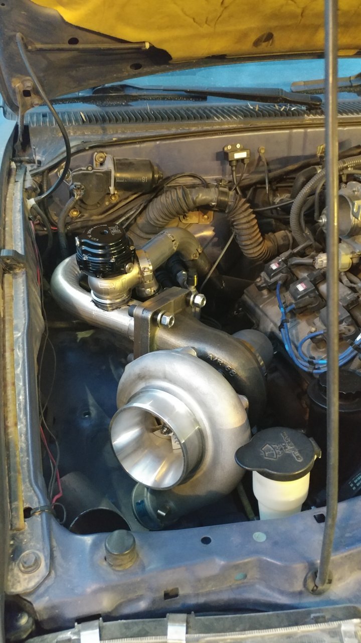

    Then was my first turbo build using a $150 flux cored welder (still in college):

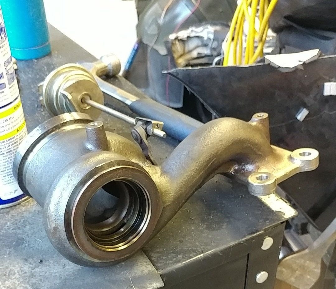

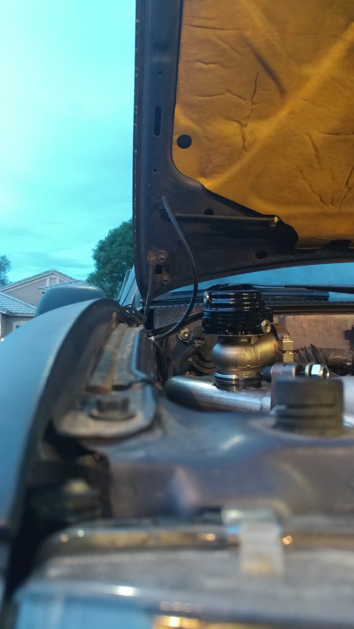

    Wastegate clearance:

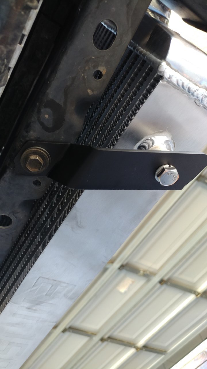

    Intercooler mounting:

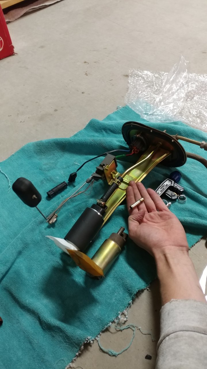

    Fuel pump upgrade:

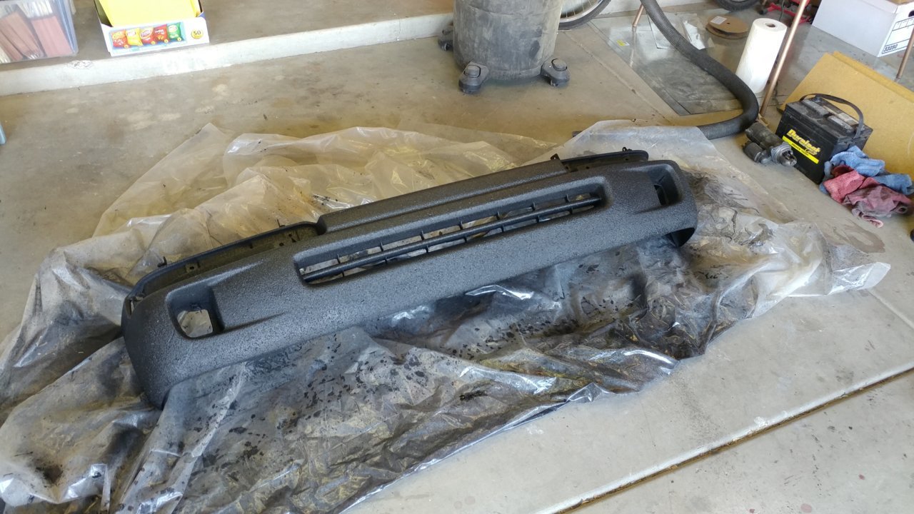

    Front bumper raptor lined (has held up really well to this day):

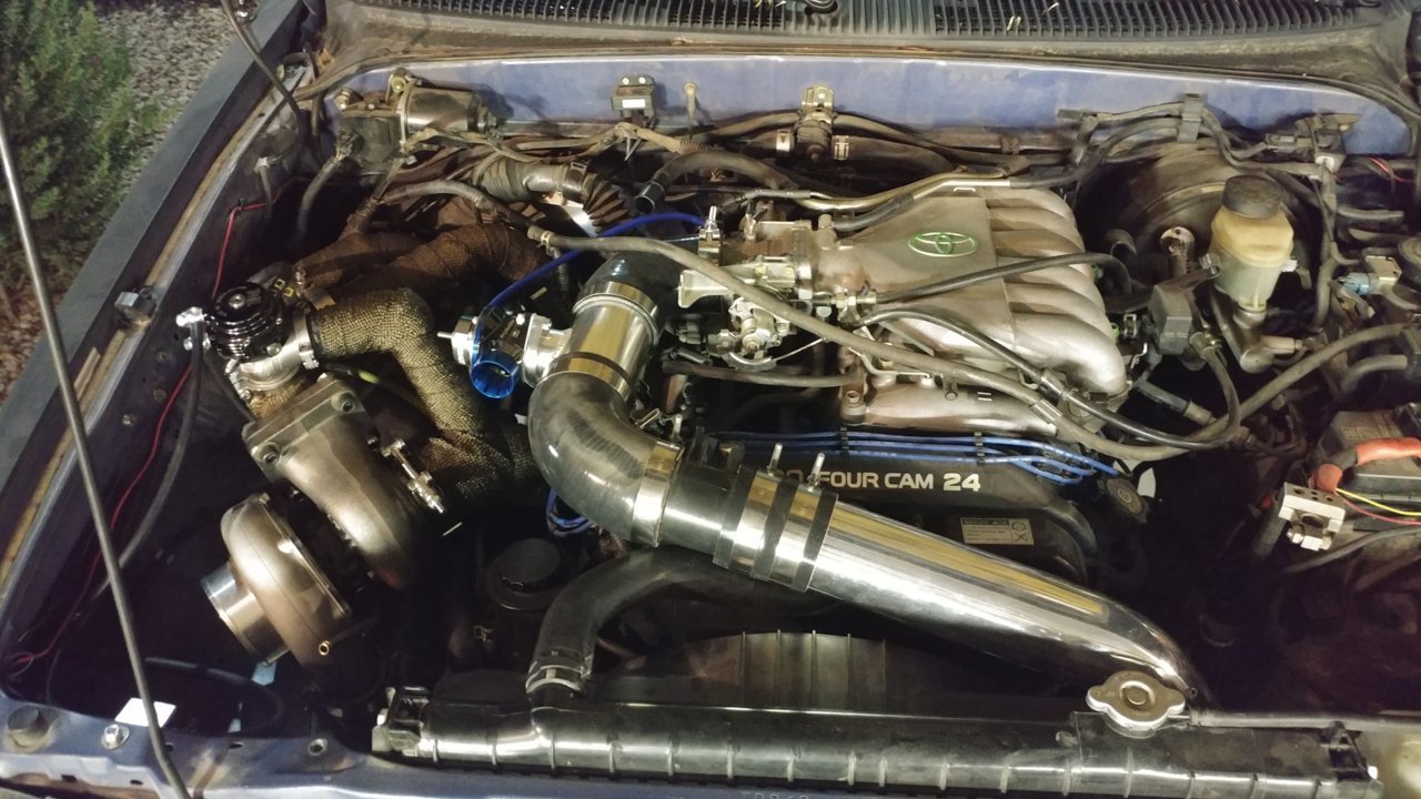

    Only issue was I barely hit boost until I was on the highway, and the Split Second piggyback was not helping me in closed loop, which was a constant struggle to fix. All in all, a good first attempt and I ran this set-up for about 2 years before deciding to redo it.

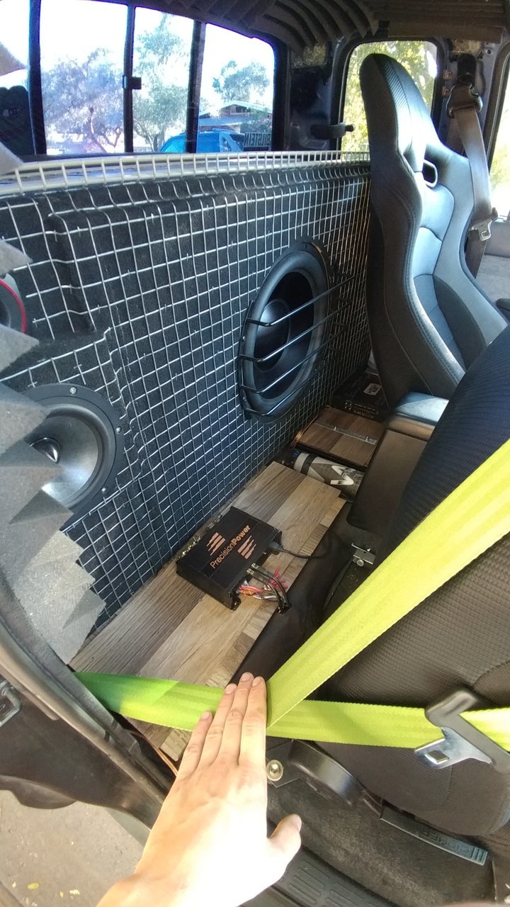

    Meanwhile, I convinced myself I needed racing seats with bolsters to keep me planted on turns, but I couldn't be bothered to pay an extra $100+ for custom brackets, so I made it work with some time and somewhat sketchy tube and bar steel. Couple that with being obsessed with sound for a while and you get this:

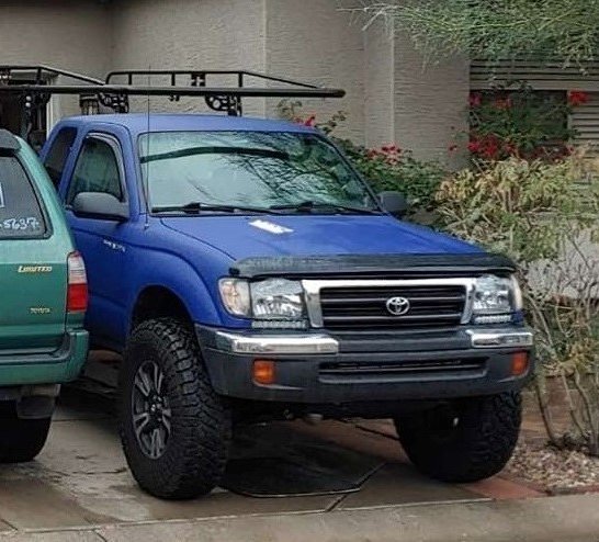

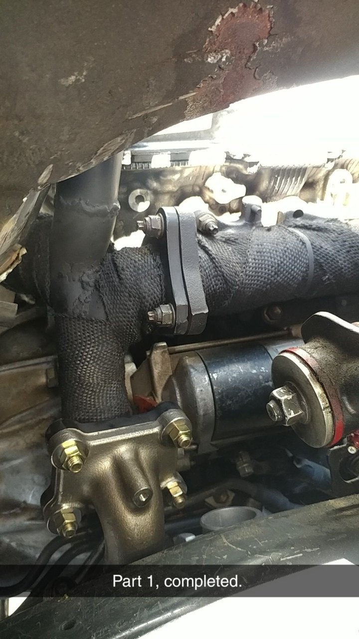

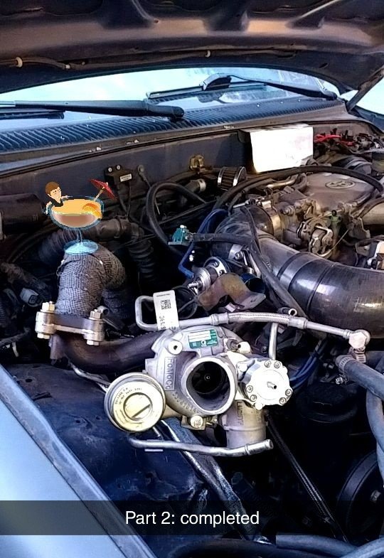

    Phase 2 .... spoilers it's all Snapchat memories

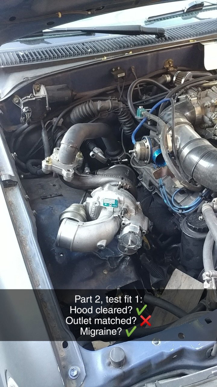

    Summary: Scrapped big turbo, went two small boy turbos from Focus STs. Tried for a low mount and an upper mount. Low mount was a nightmare.

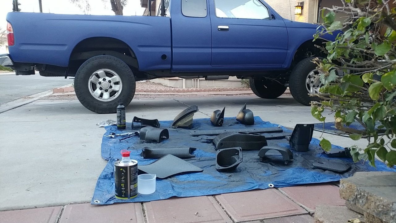

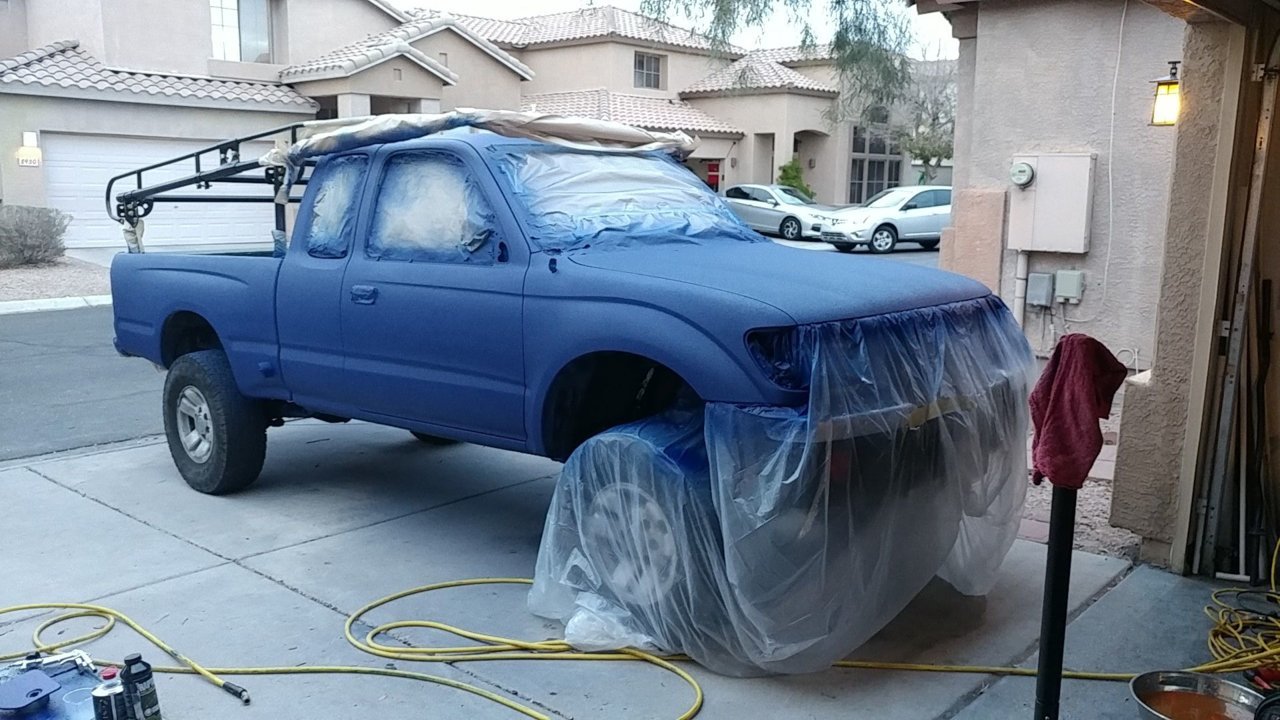

    Truck Raptor lined w/navy blue tint to preserve color cohesion with factory body
    Black raptor on the little bits

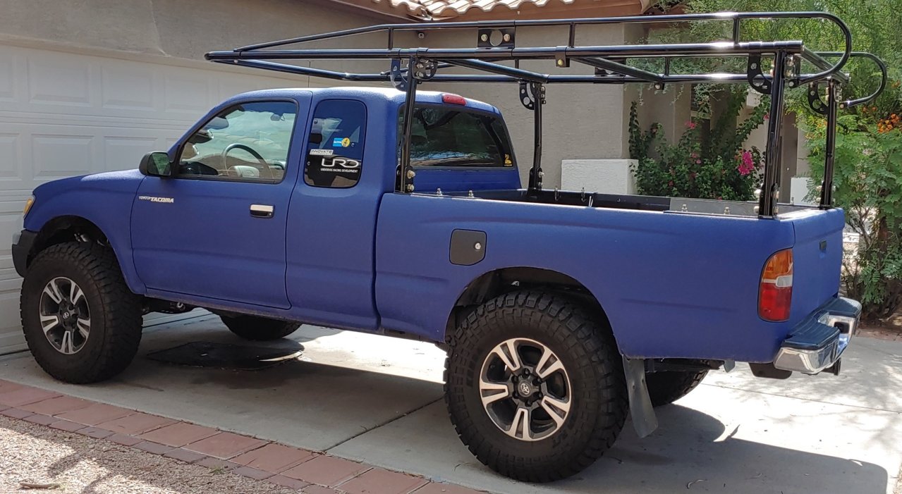

    This is how it currently sits, minus the truck rack which was sold:

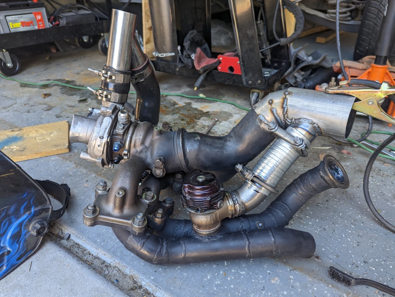

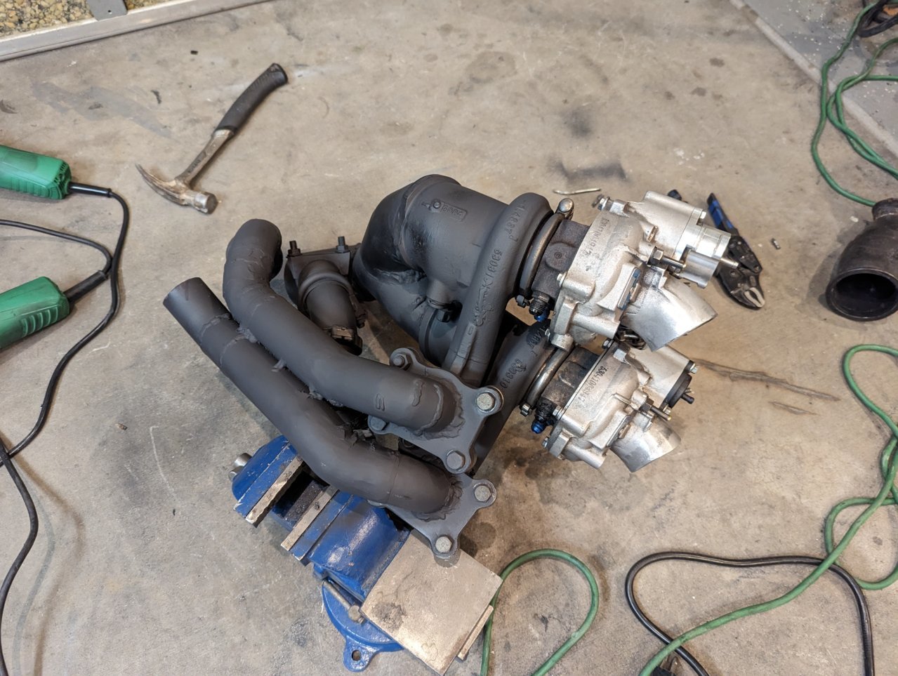

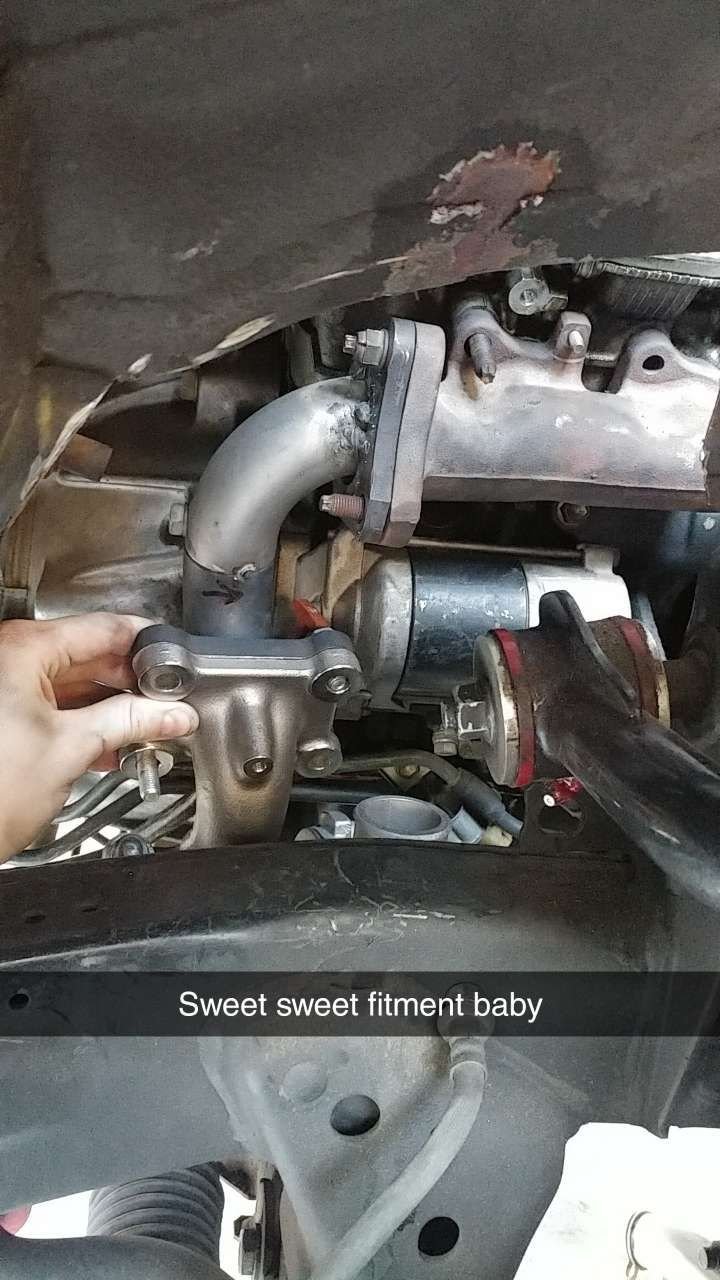

    Yesterday added the wastegate tube
    But the angle ended up being too shallow so I had to patch it up and try again
    All that's left is the left exhaust bank connection
    unstpible and Das it mang like this.
  5. Mar 5, 2023 at 2:00 PM
    treyus30
    treyus30 [OP] 70% complete 70% of the time
    Jun 24, 2015
    #158054
    8,248
    Trey
    Mesa / AJ, AZ
    '99 5VZ-FE Twin K03s w/Haltech
    Historic plates and 2 bar

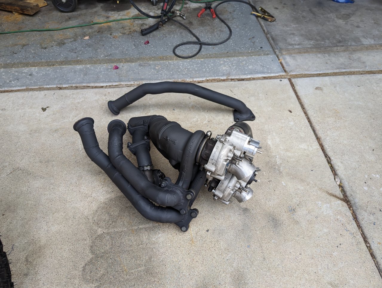

    After much fanageling, all 6 points now align. What a monster!
    Tight fit.
    MIG butt welding sucks and is ugly so once the ceramic paint is cured I'll probably add an exhaust wrap. It ended up cracking in some places where I ground it down.

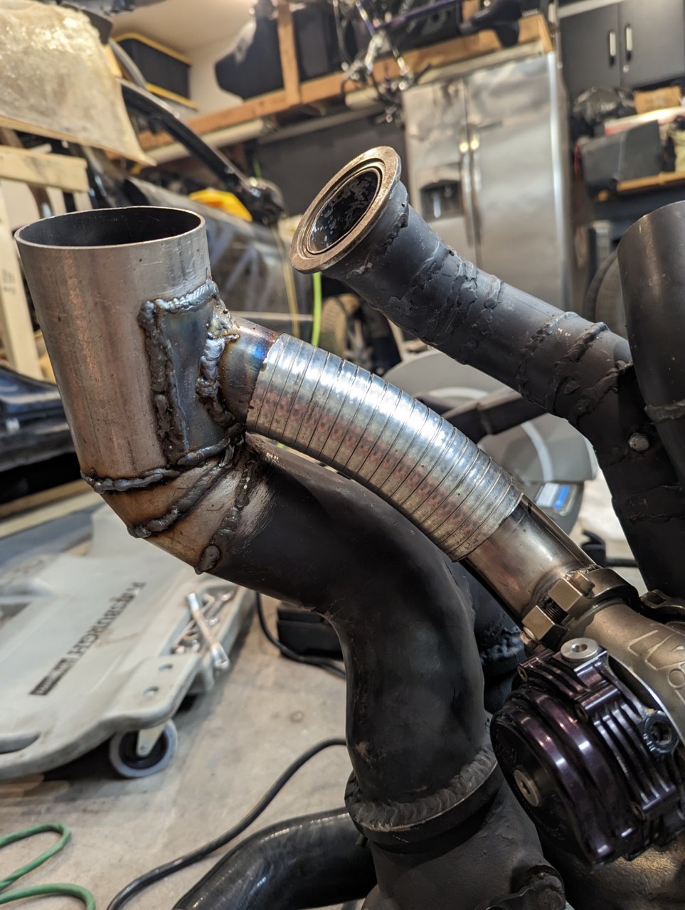

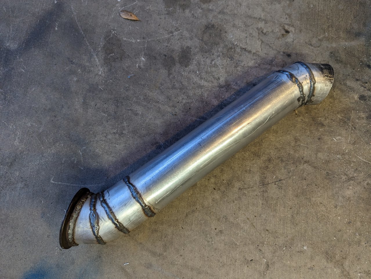

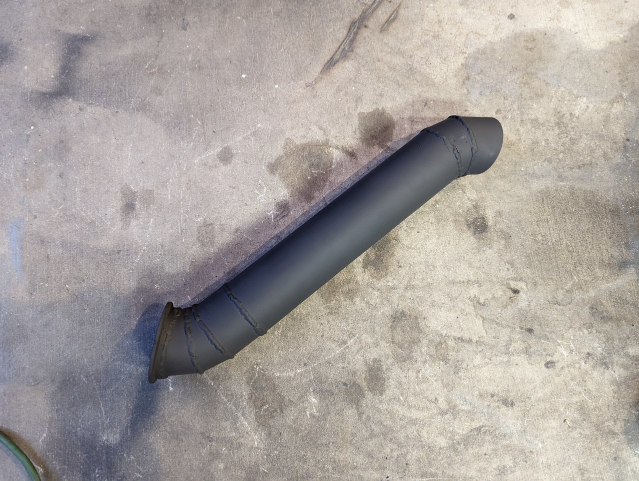

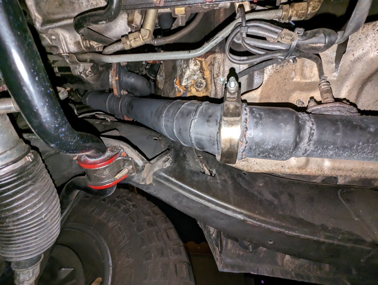

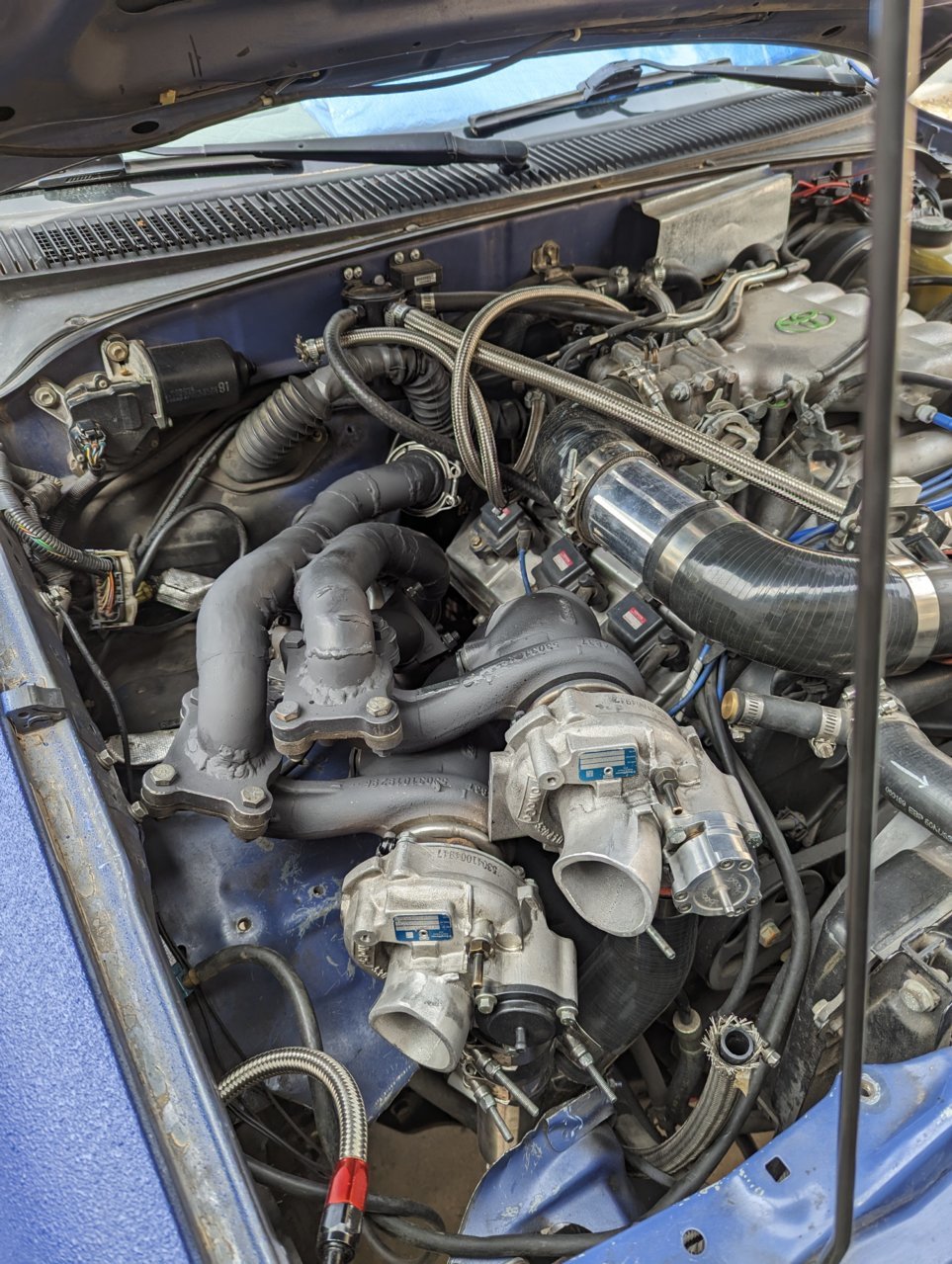

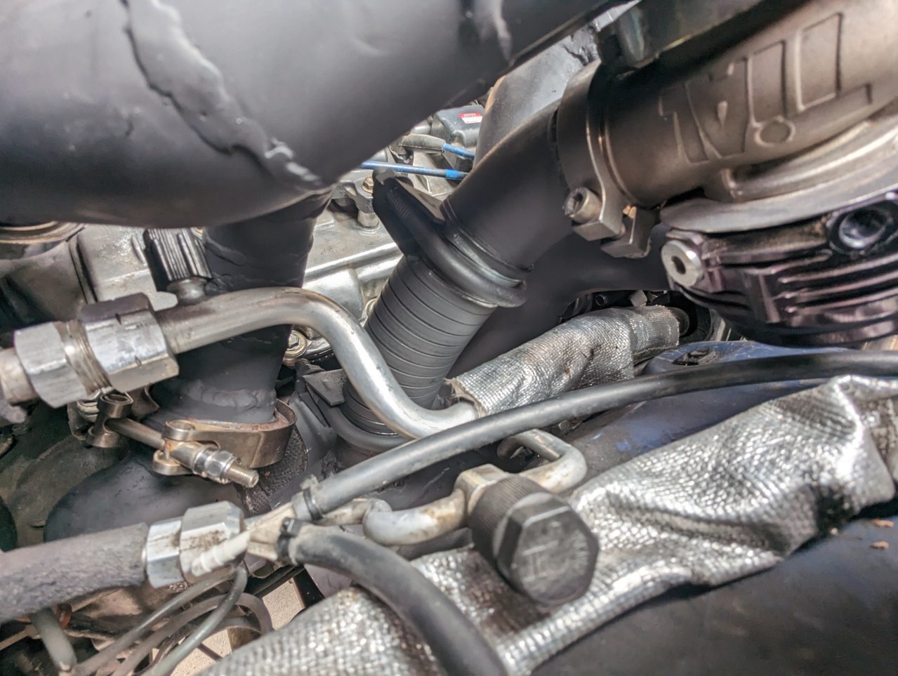

    Made the primary downpipe tonight
    Ignore the welds on the right - those are from long ago with my old flux core
    Almost done with the rest of the plumbing as well, just need to drop the oil pan once more to weld another bung in then start up!
    2nd air filter is gonna be tricky though, but can start up w/o it.

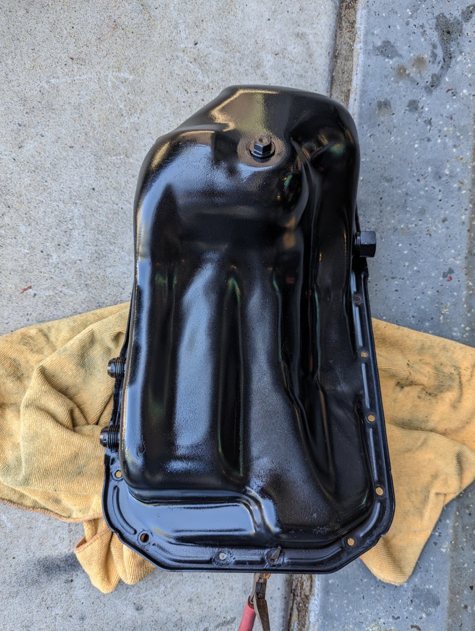

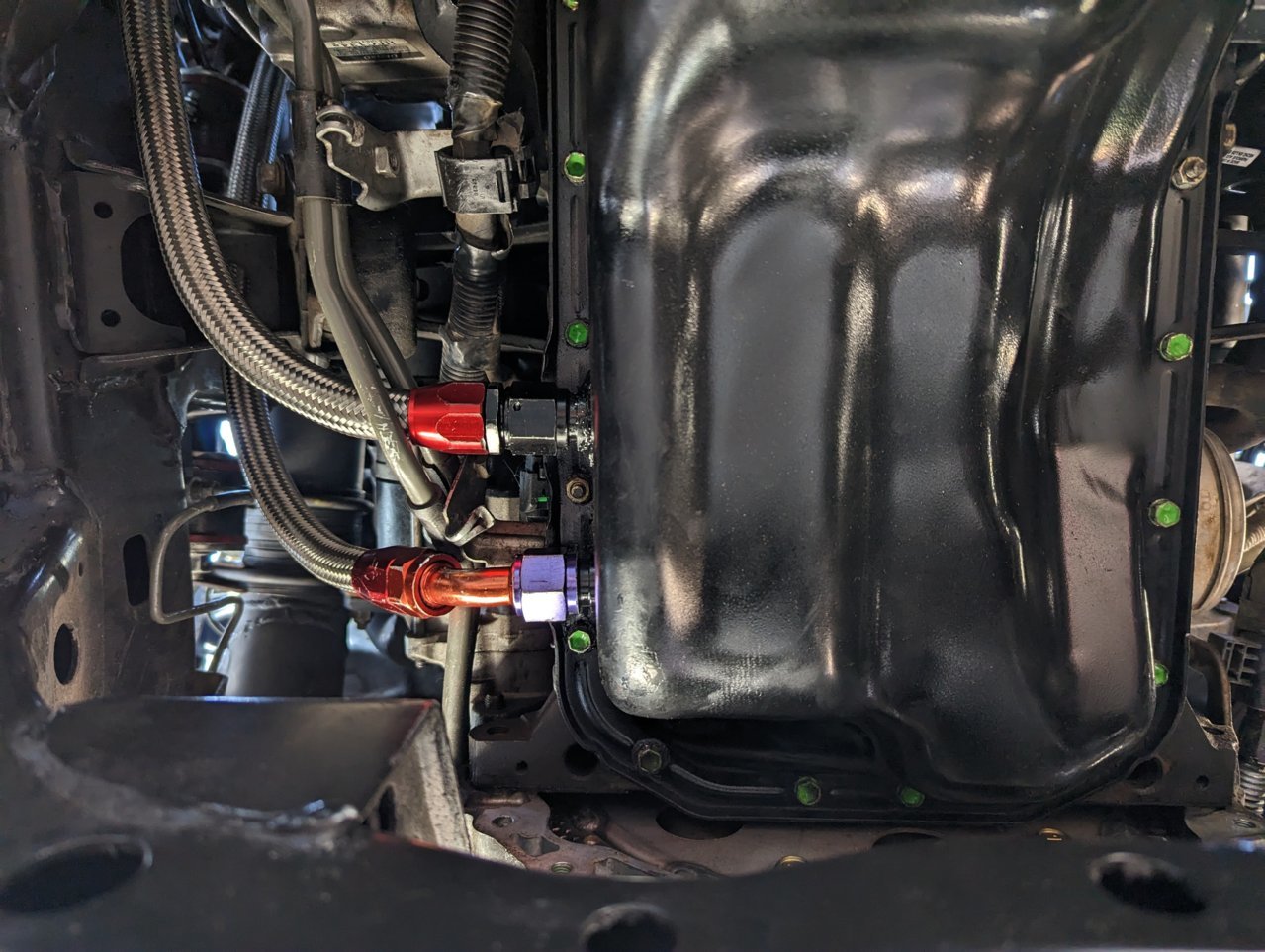

    Dropped the oil pan (again) and installed another bung on the same side as the first one, and plugged the other side (3 now). Then adjusted the 10AN return fittings & lines.
    And it runs!!
    But it leaks coolant from the intake valley :( guess it's time for another teardown. Oh well, I had new injectors to install anyway.
    The final challenge will be getting a filter to fit on the rightmost turbo, as I simply cannot wedge the one I have in that spot.

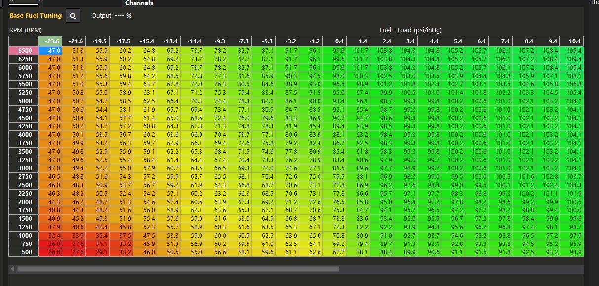

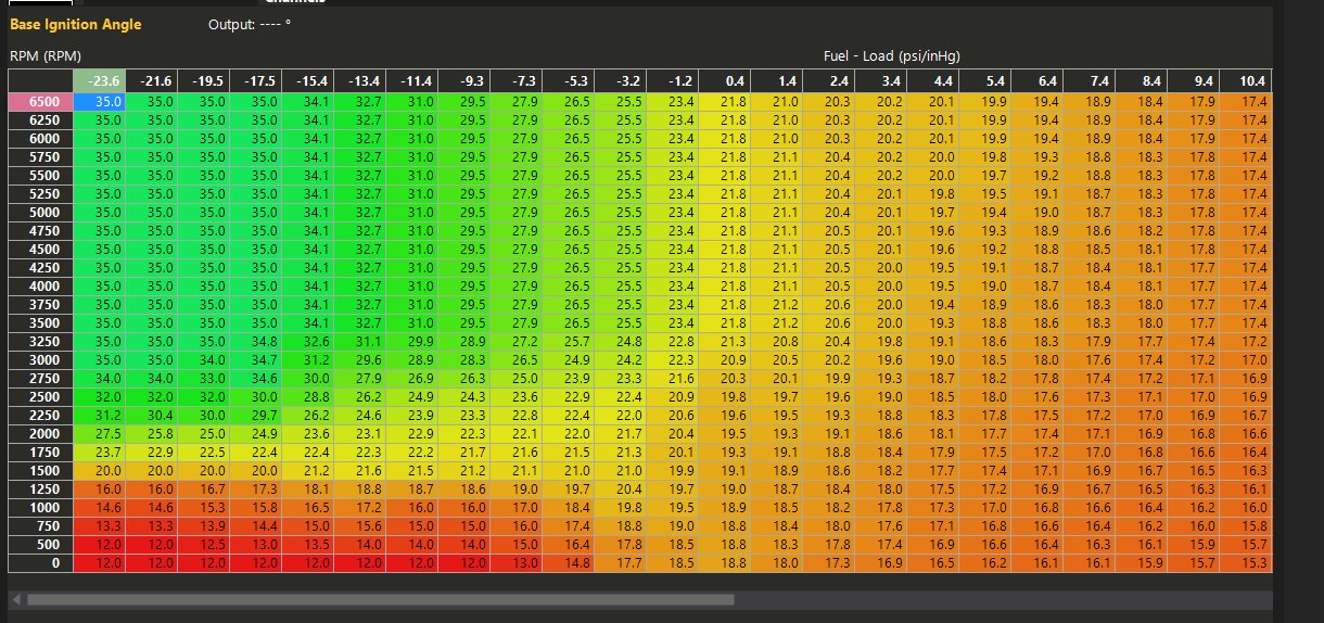

    Truck starts and starting to dial everything in from test drives...
    Going to have some issues dialing in ignition timing though since these knock sensors are so unreadable. I still can't figure out even what frequency knock occurs at :confused:
    Just all about more driving and locking those LTFTs in from here out I think. Then maybe I can fork out for a dyno tune on the timing...
    Tbh though the idle vacuum to atmospheric regions seem mostly trivial. I hit effective WOT (0PSI in the manifold) at 10-15% throttle at 2500RPM on this thing.

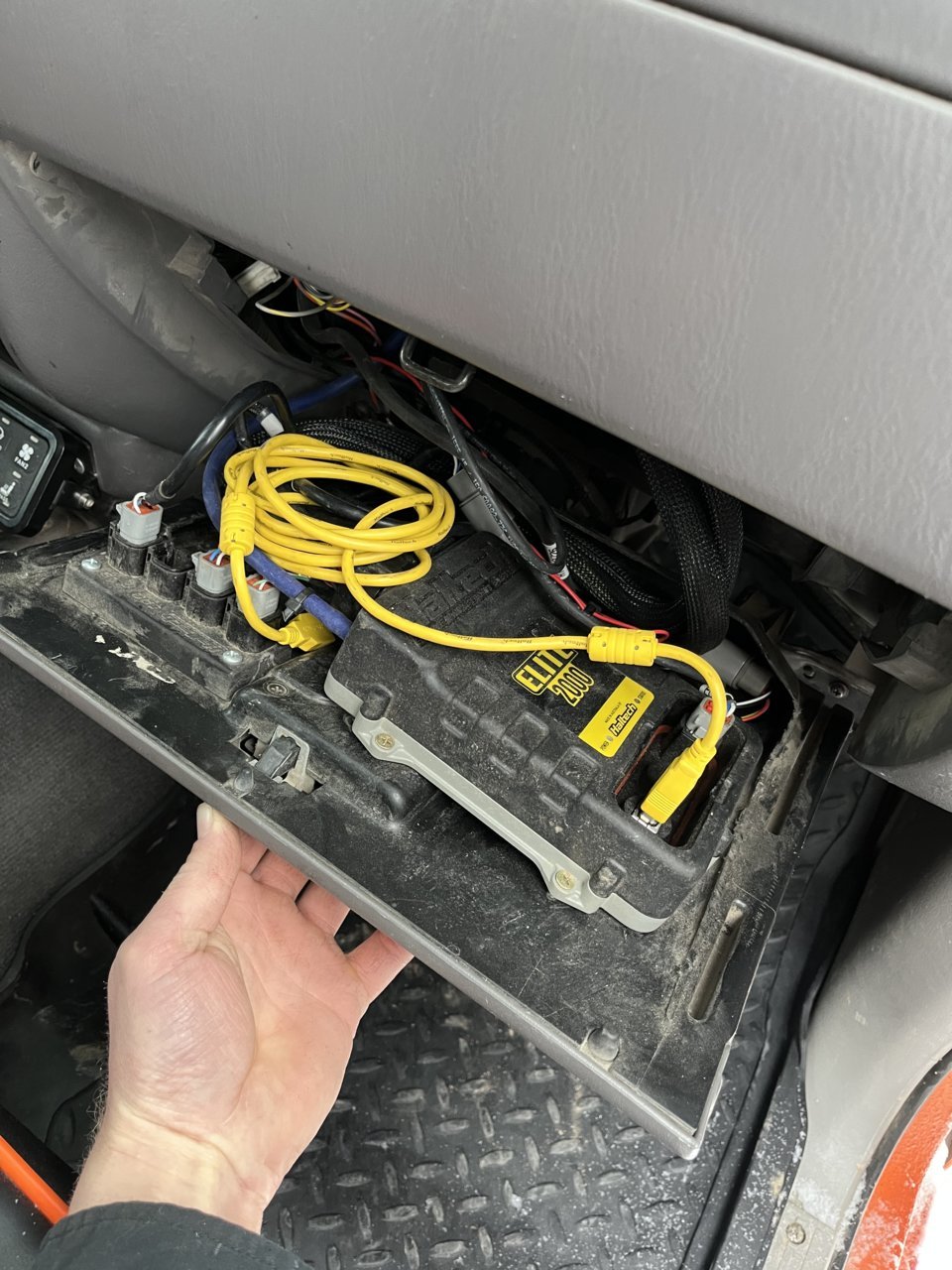

    I am running Haltec too. Mine is a 2000. I got it all tucked in the jockey box.
