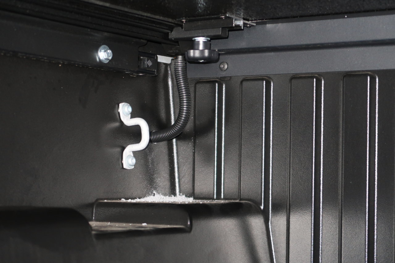

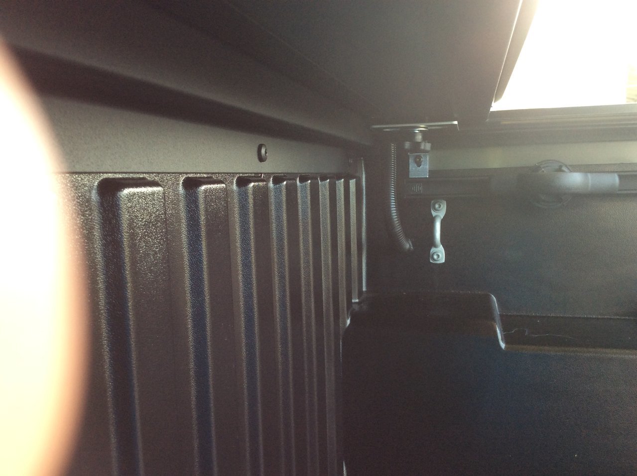

    IMG_0024.jpg IMG_0025.jpg Don't know if you did this yet but I used a PVC grey hose coupler from HD, forget if it was 1/2" or 3/4', ground down the ribs a little to fit the 5/8 hose that came wit the Bakflip Mx4 and drilled the sides of bed and put some silicone and stuck it in the holes, works great....not in the way! Solid, now just gotta seal the top frame rails, leaks a little under the rubber on bed rail, it's got the design ribs the seal don't sit flat.

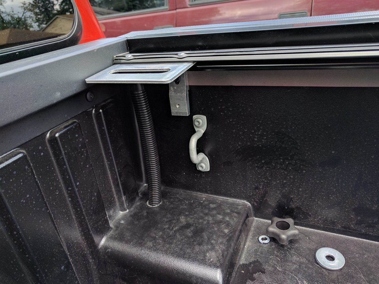

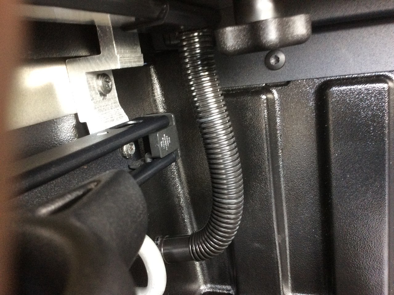

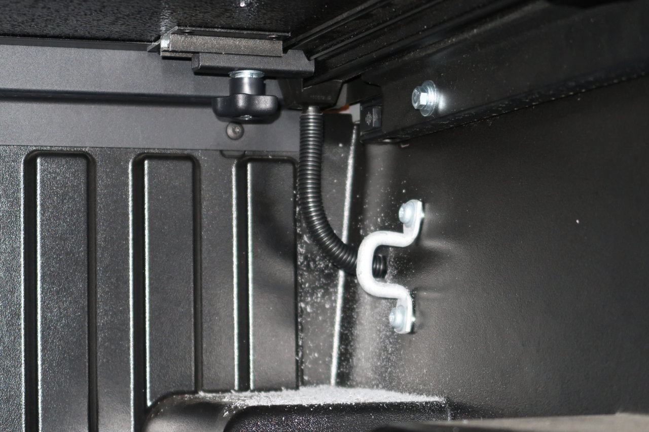

    Older thread I know. I wanted to thank you for this. I like this location to keep hoses out of the way of gear and draining in the tire wells. I did it today.

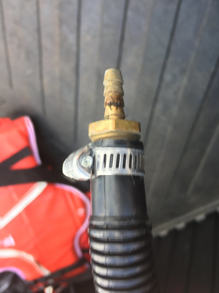

    The size of the tube is 5/8” OUTSIDE DIAMETER X 1/2” INSIDE DIAMETER - I bought a new silicone tube for increased longevity over the plastic corrugated tube — the barbed brass plug reducer that fits inside the drain holes with out drilling the holes bigger is a 5/16” - needs to be hammered in with a rubber mallet but it fits snug once in there
