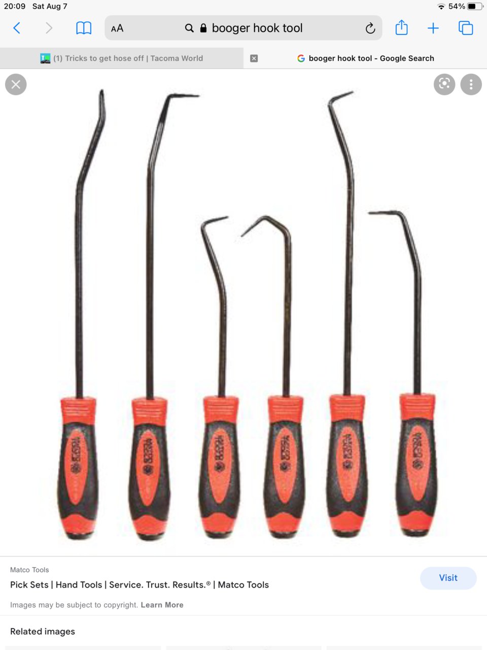

    I’ve had good results using a “booger hook” (cotter key removal tool) when trying to separate hoses from the fittings. The rubber and plastic really like to bond over time.
    Example-
    Evostaco likes this.

    ^^ a hose pick set is nice. If you can get the end of the hose pulled up a bit spray a little shot of brake cleaner in there and work it around.
    Brake cleaner is great as a temporary lubricant, it dries up quickly and doesn't leave any residue. Works good for slipping a stubborn hose clamp into position on a dry hose

    Ahh, forgot about those, I call em hookers.
