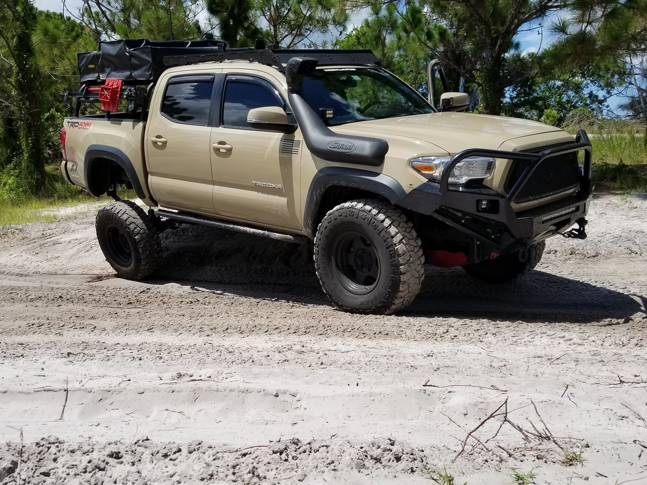

    How she sits today
    Current Parts List:
    Suspension -
    Front: ADS Extended Travel Coilovers with Resi
    Total Chaos UCA's
    Rear: Chevy 63" leaf springs (3+1 pack with overload removed) with shock relocation and Bilstein 5125 14"
    Wheels / Tires -
    SCS SR8’s 16x8
    35s (315/75R16) Dick Cepek Extreme Country
    Grill-
    TRD Pro
    Intake-
    ARB Safari Snorkel
    AFE Dry Filter (Drop in)
    Performance-
    Orange Virus Tune
    4.88s
    URD Stage 2 Clutch
    URD TORQUE-U HD Flywheel
    Armor-
    SFAB sliders (welded on)
    @allenfab custom front bumper
    SOS Offroad HC Rear bumper
    @Mobtown Offroad full skids
    Gear
    Uniden Bearcat 880 CB
    Firestik 4' Antenna
    C4fab antenna mount
    60" Hi-Lift
    Smittybilt X20 w/Synthetic Rope
    Factor55 Flatlink
    Rough Country 20" Light Bar in bumper
    Rough Country LED Pods and CBI Ditch Light brackets
    Instant Air supply 10lb CO2 Bottle
    COMING SOON
    Nothing. Absolutely nothing.
    SAS Parts List
    Parts List for Chevy 63 Swap
    Overall, I spent about $900 in parts and another $400 in labor to do this swap.
    RuffStuff R1653 Long Curved Shock Tabs (PAIR)
    RuffStuff Ideal 63" Chevy Spring Swap Kit
    RuffStuff Frame Outriggers
    Low Range Off Road Ford Upper Front Shock Mount Tower
    63" Chevy Leaf Springs
    Bumpstop Extenders
    Bilstein 5125 (33-185576)

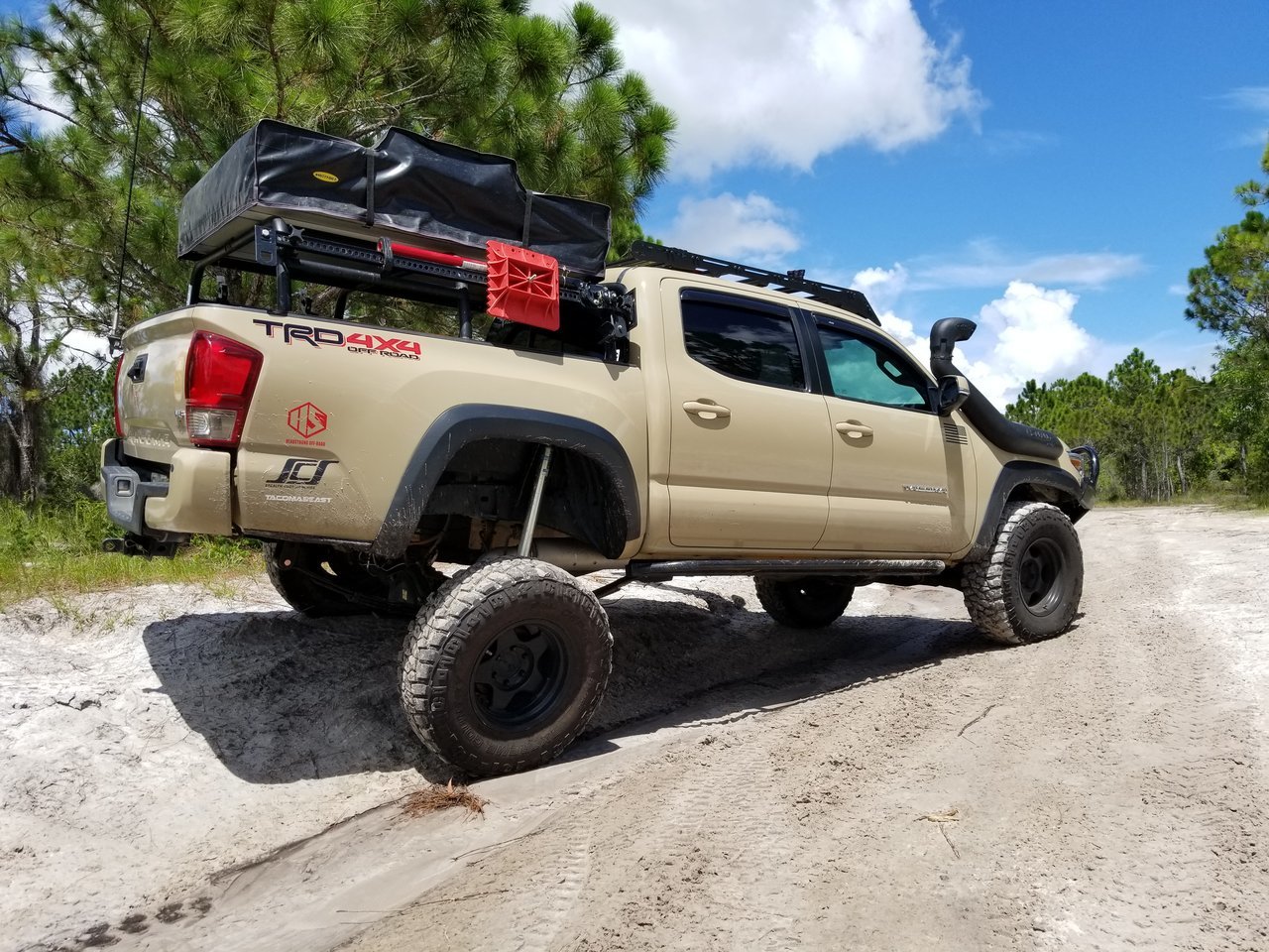

    63 Swap in progress. All stock components were cut off and new spring hangers and shock towers were welded in.
    20170715_092209.jpg 20170715_092220.jpg 20170715_100051.jpg 20170715_112404.jpg

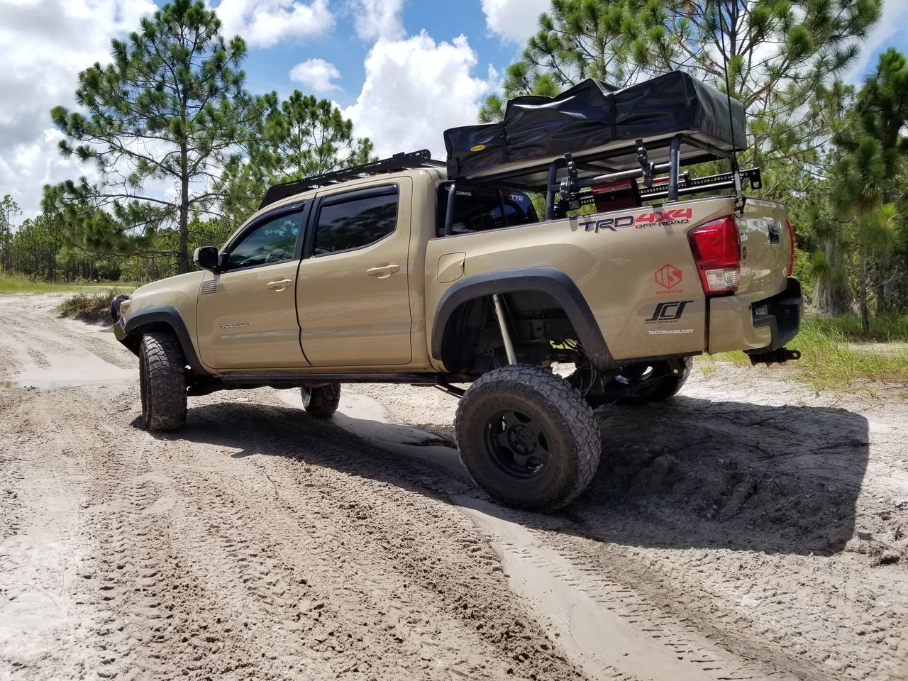

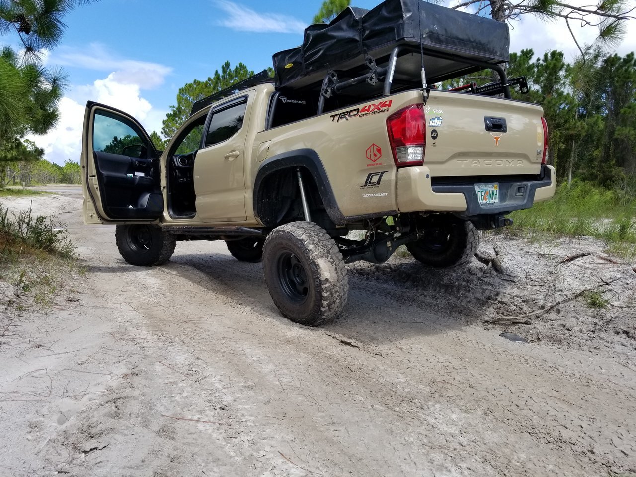

  11. Jul 16, 2017 at 12:19 PM
    Trident904
    Trident904 [OP] Touching Drum Sets
    Jun 13, 2014
    #131875
    5,089
    Brian
    Treasure Coast, Florida
    17 4Runner TRD OR
    Modded it so much it turned into a 4Runner
    Just a little flex. Need bigger hills down here. Loving the 63s so far.
    20170716_145702.jpg 20170716_145844.jpg 20170716_145956.jpg 20170716_150017.jpg

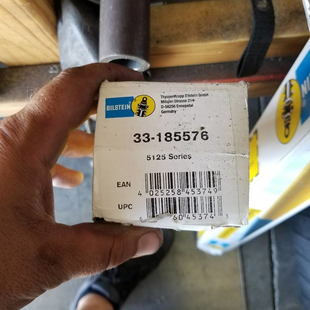

    Need to find some fab shops in the panhandle area....shock relocation is so enticing.
    What rear shock did you end up with?
    ChadsPride and Trident904[OP] like this.
  13. Jul 16, 2017 at 12:55 PM
    Trident904
    Jun 13, 2014
    #131875
    5,089
    Brian
    17 4Runner TRD OR
    Bilstein 5125s 14"
