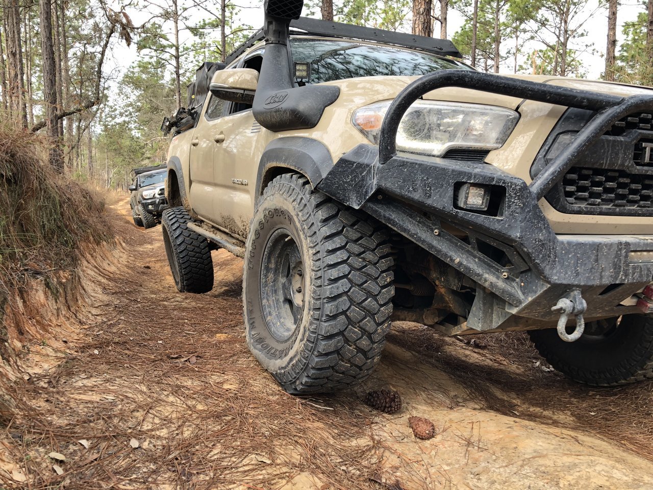

    Stuffing is limited by my wheelers superbumps up front. This is full stuff.
