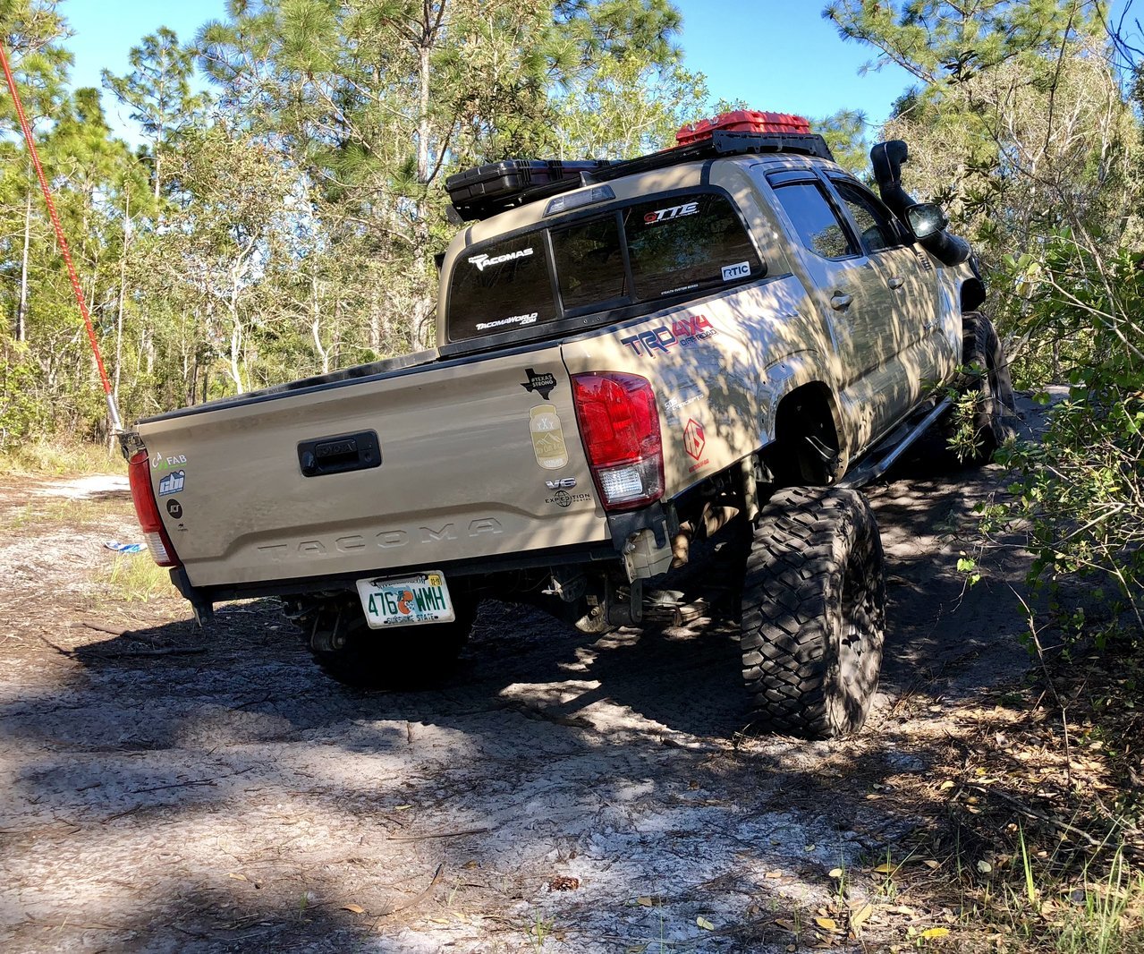

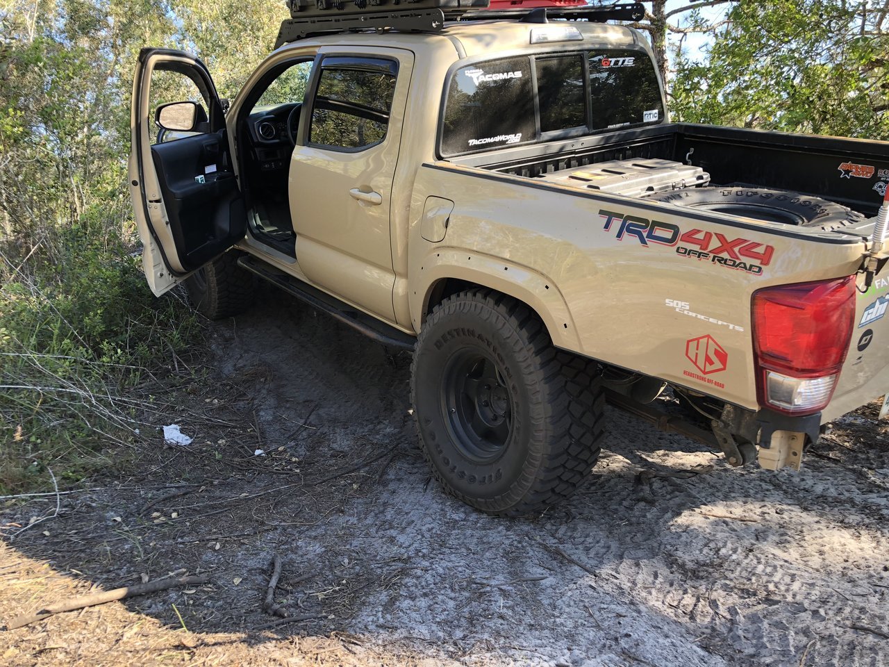

    Went to my local wheeling spot today and came across a city cop who had buried the rear wheels of his crown Vic in the soft sugar sand. He flagged me down asked if I had a recovery strap, I did, and I got him unstuck. He then proceeded to trespass me because the land is private. Dick move? maybe. Should I have been back there? No. I probably should have left him stuck.

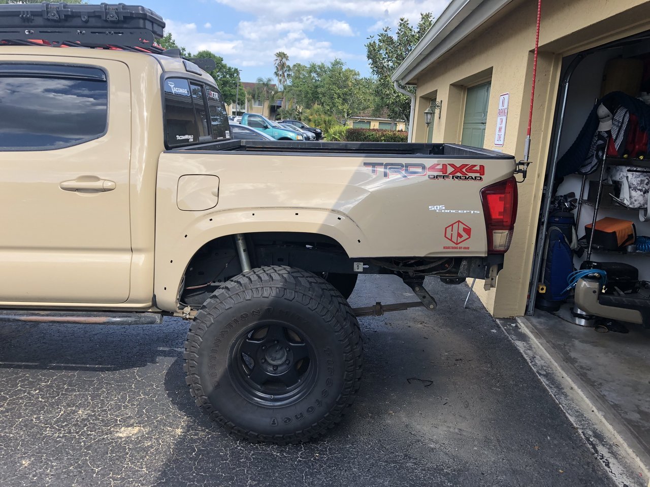

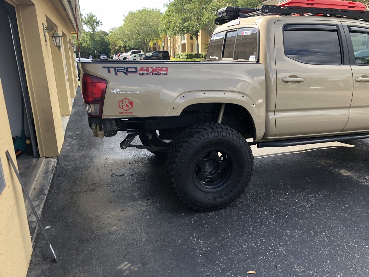

    Patiently waiting to see this new bumper. How much lift did you get out of the 63 swap (never got a clear idea after a quick search) and can you determine how much you lose after you install the bumper?
  9. Mar 20, 2018 at 7:02 AM
    #329
    Trident904
    Trident904 [OP] Touching Drum Sets
    Jun 13, 2014
    #131875
    5,089
    Brian
    Treasure Coast, Florida
    17 4Runner TRD OR
    Modded it so much it turned into a 4Runner
    I got a total of around 4" with the swap, the bumper and new bed rack will put me down around 3.5" total lift. These chevy springs hold some weight.

    I want a 63 swap, but I don't need a 4" rear lift :annoyed:
  13. Mar 20, 2018 at 7:45 AM
    #333
    Trident904
    Jun 13, 2014
    #131875
    5,089
    Brian
    17 4Runner TRD OR
    Shorter shackles fix that. I'm on 5" shackles.

    I’m running 2 leaf right now just to speed up the break in process. When I removed the 3rd leaf, the ass end lowered 2”. Over the past few weeks, it’s lowered another inch. My front and back are perfectly level. This weekend I plan to weld new shackle hangers right in front of the ones that are already on the truck. This should get my shackles at the right position. Then I’ll add the 3rd leaf back in.
