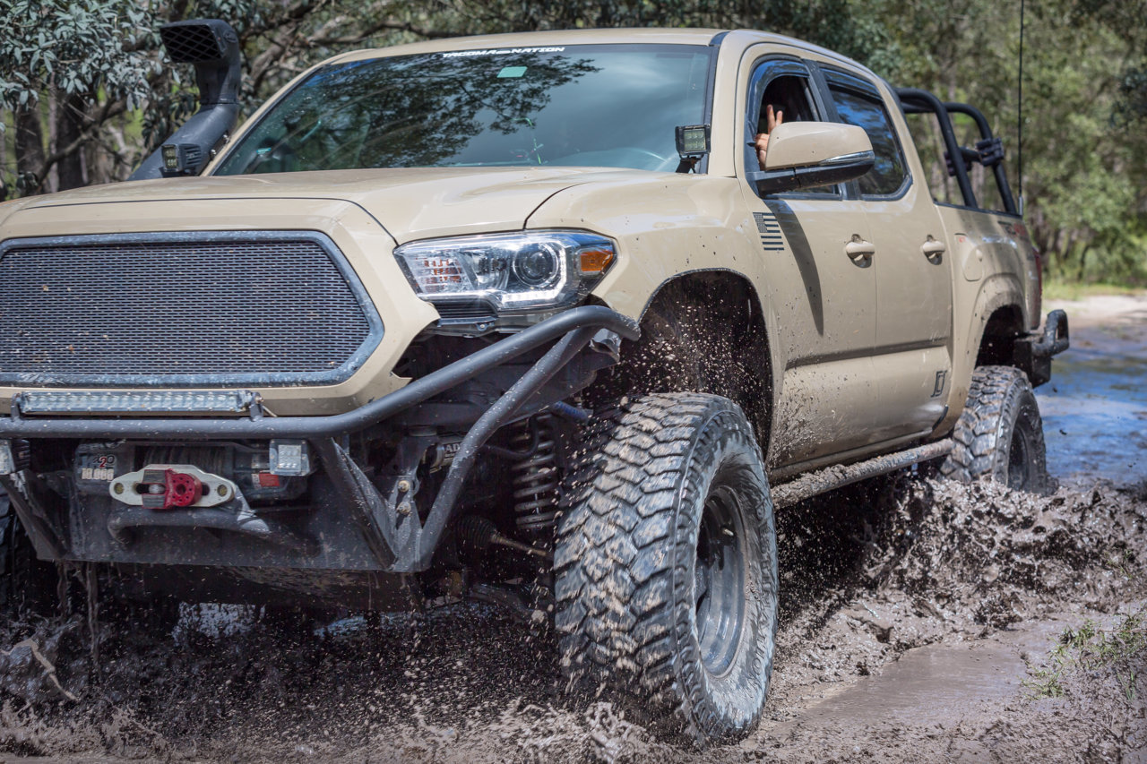

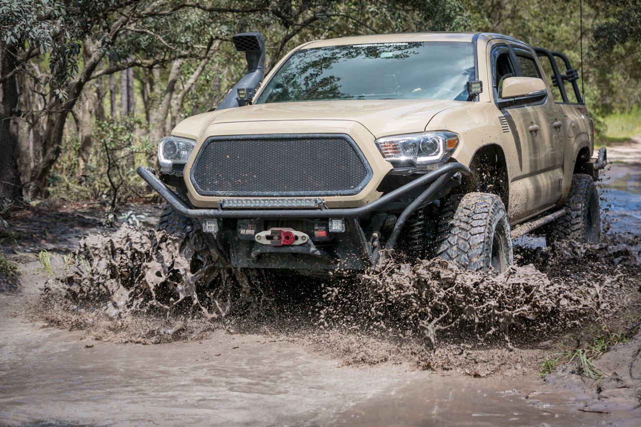

  17. Sep 14, 2018 at 6:43 PM
    #537
    Trident904
    Trident904 [OP] Touching Drum Sets
    Jun 13, 2014
    #131875
    5,089
    Brian
    Treasure Coast, Florida
    17 4Runner TRD OR
    Modded it so much it turned into a 4Runner
    A couple more pics from the recent Citrus run.
    That @allenfab front bumper though!
    144B955B-D86C-4646-BB9D-831BDDE2C559.jpg D0A7EA18-DC52-4B30-A6BF-462040D8CCAE.jpg

  18. Oct 10, 2018 at 7:21 PM
    #538
    ScottyR
    ScottyR Well-Known Member
    Dec 7, 2015
    #171708
    628
    Vancouver BC
    2016 DCLB TRD Sport
    how did you manage this!? my 285s are ripping my fender off atm hahaha

  20. Oct 11, 2018 at 6:36 AM
    #540
    Trident904
    Jun 13, 2014
    #131875
    5,089
    Brian
    17 4Runner TRD OR
    Solid CMC, UCA’s and caster as far forward as you can go. You have to find an alignment shop that understands that you aren’t stock and can comprehend that the stock alignment settings aren’t going to work.
    Also need to be on a true 3” of lift, not the 2” that all the setups get you. Coilovers are your friend.
