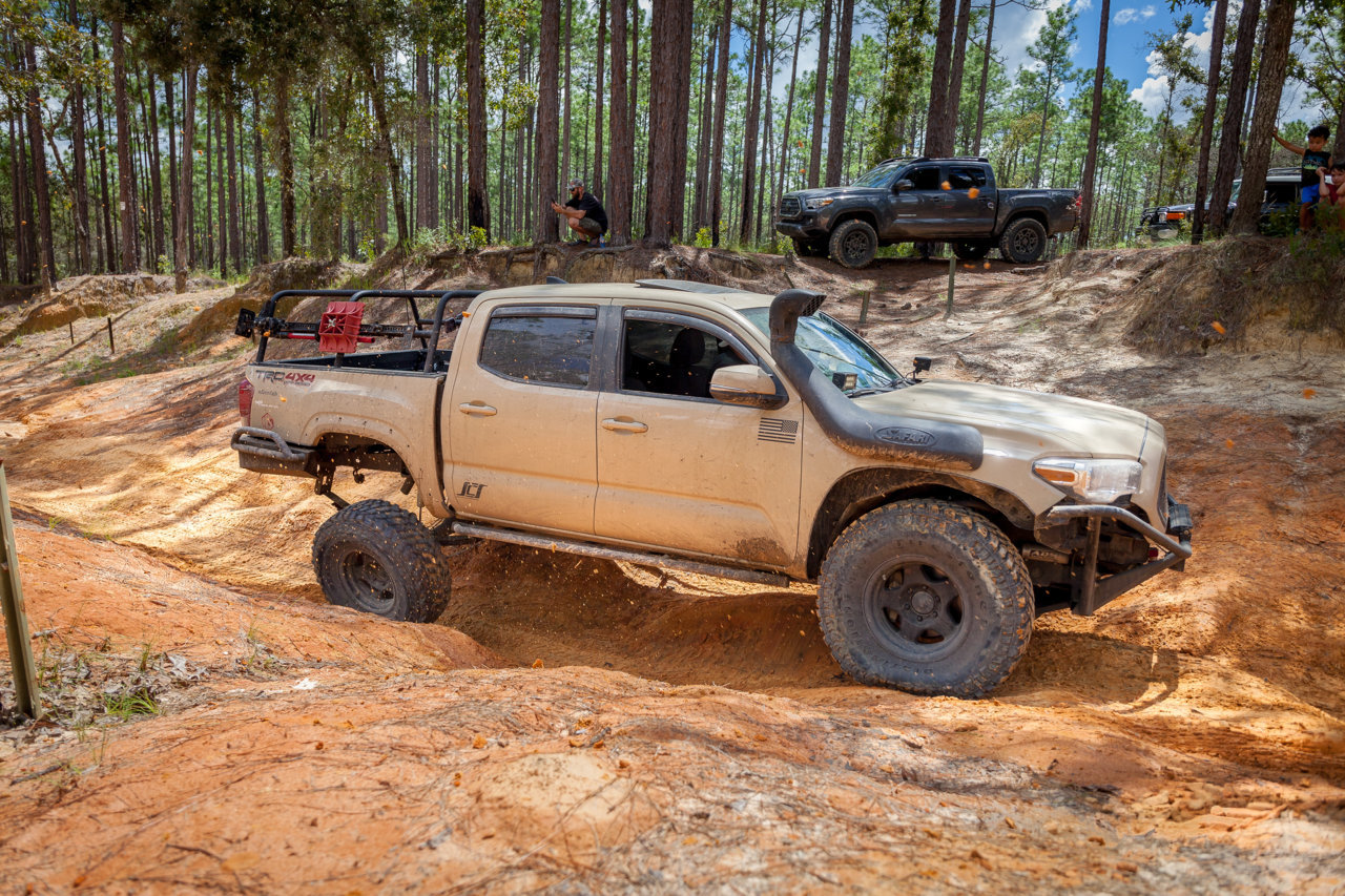

    Well, in order to fit 35’s, which I have, a true 3” is required. And, when properly lifting a truck, bumpstops are part of doing it right. I have wheelers super bumps up front with 1/4” spacer added to them and I have never bottomed out. The pic below is full stuff and full bump.
    You’ll note that there is no contact in the wheel well. Also, my fenders are trimmed for upcoming SAS and 37’s.

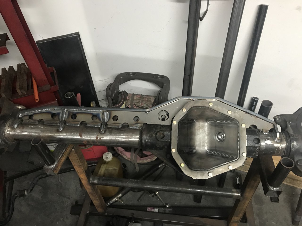

    1997 t4r has super duty axles, 5.13s locked front and rear. 3 link front with 14" kings. Rear 63s.
    That front axle is heavy. Super heavy
