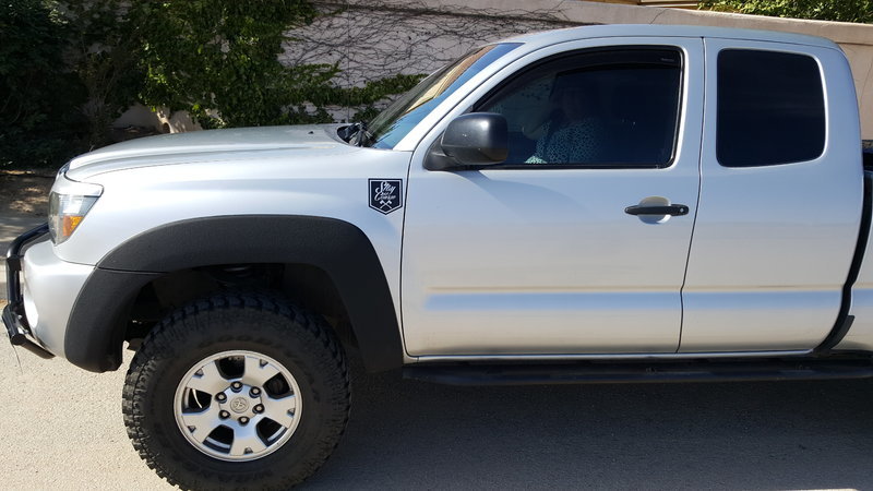

    Eibach 620s here on 5100s set at zero.....1/4" lean spacer on drivers side.
    Rear 5100s, tsb leafpack, overload taken out, icon progressive aal.
    Fwiw, 4400lbs on a scale.
    Half a tank of gas, sliders, full toolbox, and myself in it.
