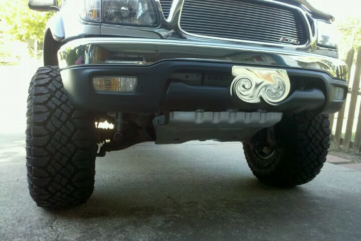

    This is why I went with a 3" lift. 14 1/2 inches of ground clearance from skid plate to the ground.
    I like to look of 6" lifts but me personally would never do a drop bracket lift. If I were to lift my truck any higher Solid axle swap would be the route I would go
