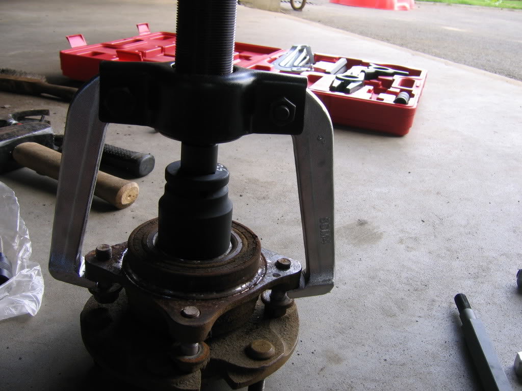

    Hmmm youve stumped me. Maybe rust on the splined axle shaft.

    Ouch! Anything that comes in it's own case is pricey..:) what about just a 4 inch 3 jaw puller from an auto parts store. I don't think I will mushroom the end of the axle, do you?

    gonna tear it apart again in the am. Gonna go buy a puller anyway. good to have it. I will try "tapping", then advance as needed.

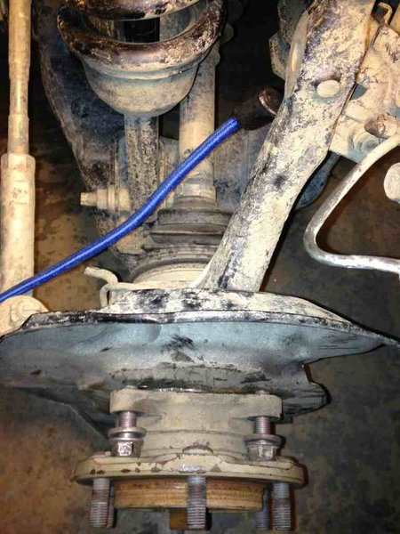

    I ran into the SAME problem while trying to replace my axle seal on the front diff last week.
    Took me 3 hours of prying and hammering to get one hub off the spindle...but after calling my mechanic friend for advice, I was able to do it. He advised me to loosen the 4 bolts all the way, thread the axle nut onto the axle itself until the nut is flush with the face of the axle (to prevent the bearing/hub from flying off when it breaks loose) take a big hammer, and keep hitting the end of the axle nut....HARD. Like he said you need like 3 feet of space to whap that thing good.
    I was able to pop it out about 1/4 inch, like you said, but it was stuck from there. After 2-3 blows to the axle nut, it popped off the spindle. No damage to the axle nut whatsoever. Hope that helps!

    Some pics at where I was stuck.

    Wow. On a 2010 you had that much trouble??
    Rust?

    Yup. It was rusted pretty good.

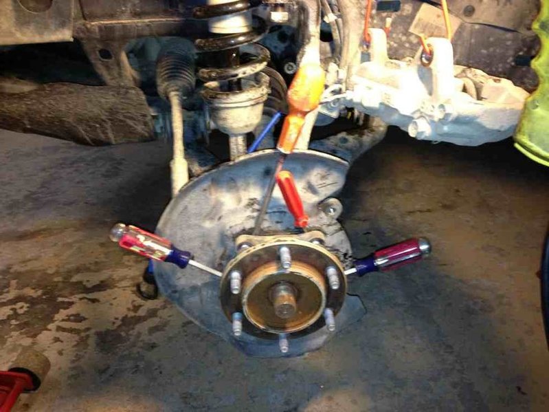

    Ok, so after 5 hrs sleep, at it again! Thanks for the advice! The picture of all the screwdrivers was me last night... Let's try this again..

    Exactly like both of you had said! Rusted splines. And after wedging my 2 chisles, put the axle nut on, and 4 whacks later, THE ASSEMBLY IS OFF!!
