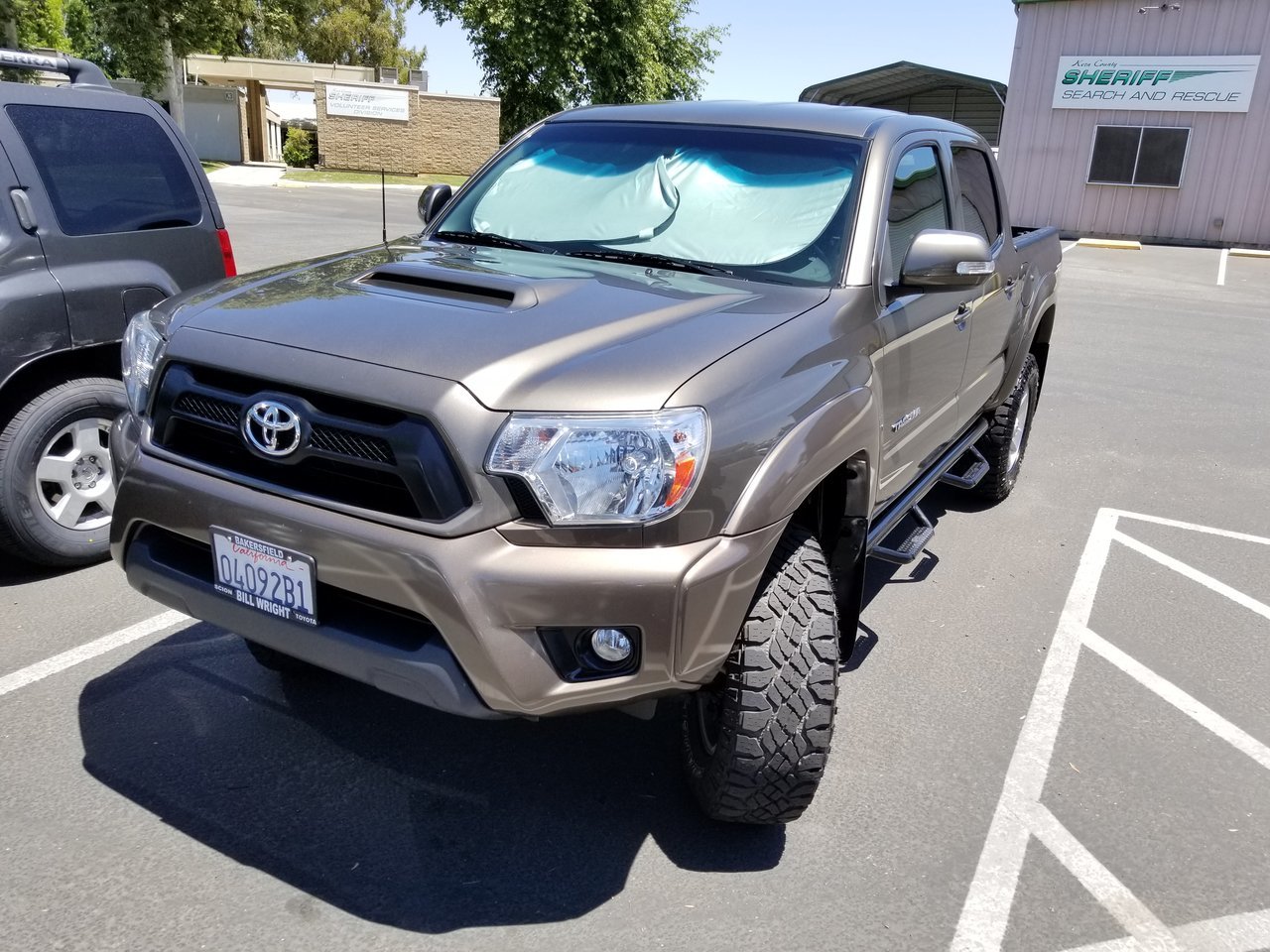

    Here is my truck polished with it. Like glass.

    This is a 2012 truck that lives outside also.

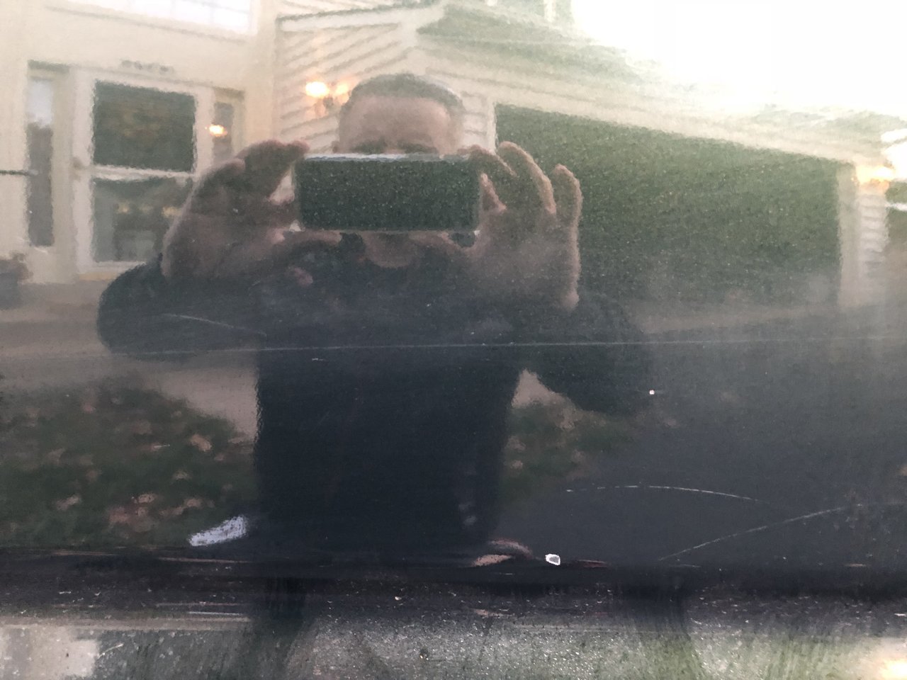

    Kinda hard to see but here it is.

    OP, I don't want to be a downer but it looks to me like you might have burned through the clear coat. I did the same thing on my truck on a rear quarter panel and tried the same polishing techniques. The fix was a repaint of the rear quarter panel.

    Thats what I was worried had happened. I hate to put on more polish if i'm just going to dig myself deeper... Thoughts?
