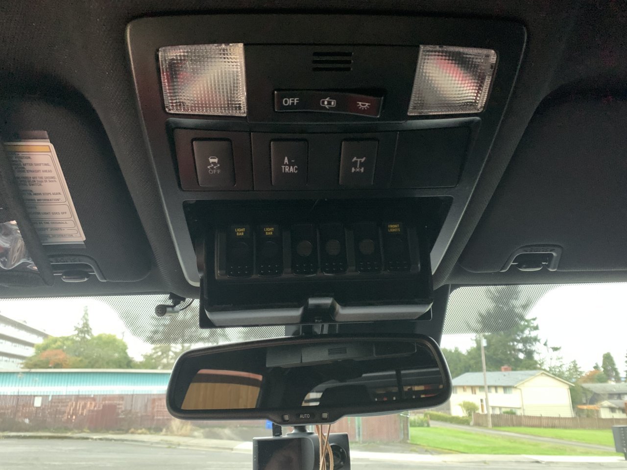

    Great write up! I’ve had the 6 Shooter for almost 8 months now, and finally got around to hardwiring the magnetic switch dock after the RF remote lost connection.
    I put the switches in the sun glass holder. Ran the wire over the headliner and down the driver A pillar.
    I was able to successfully hardwire to 12v, as I was able to reset the RF remote to the controller. However, the backlight isn’t working as it should. I dock the remote, and the toggles flash brightly for a second, then dim, then go dark until a toggle is rocked. Might have a loose wire. I’ll be contacting them tomorrow to troubleshoot.
    Overall I’m happy with the setup!

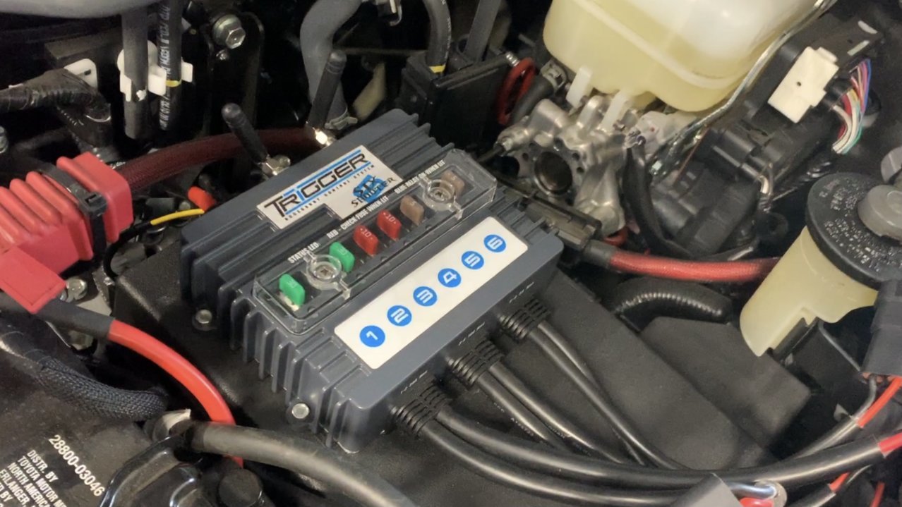

    Followed this step by step to hook up RF switch and for some reason now my exterior lights work intermittently. It would turn on for 2 secs and shut off. Disconnected and reconnected my battery cables and lights worked normal. Then mins later my lights don’t turn on at all...anyone else experience this?
  12. Nov 27, 2020 at 4:29 PM
    #32
    pc3coyote
    pc3coyote [OP] www.pc3coyote.com
    Sep 28, 2014
    #139276
    1,645
    Paul
    SoCal
    17 BBP Sport DCSB 4x4
    this happened to mine, yours is likely stuck on the low voltage cutoff feature. check the app to make sure the low voltage cutoff isn’t set at too high of a voltage level. a hard reset fixed mine. there are instructions here: https://triggercontroller.com/trigger-controller-support/. their tech support over the phone is also very helpful if needed!
    to hard reset:
    1. Disconnect your 6 SHOOTER from power using either positive (red) or ground (black) cables. Make sure the yellow wire is receiving power during this procedure
    2. Hold down 2 and 5 on the control box while reconnecting to power, you may need a helper for this. Circuit 6 will flash 3-4 times and then remain solid
    3. Release buttons 2 and 5
    4. Your Trigger 6 Shooter has been reset
