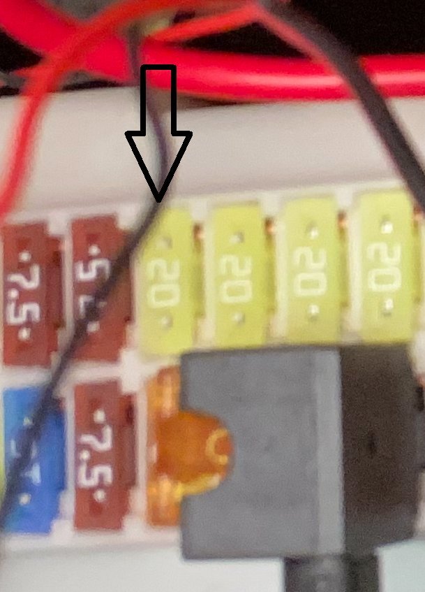

    What fuse and fuse location did you use for your yellow wire is a 2-10A fuse good?

    I routed it to the fuse box in the cab. Not sure which one I chose, it was while ago, but make sure it's a fuse that is only hot when the truck is running.

    Can anyone confirm which interior fuse they have tapped for the yellow wire. I tapped the s/roof as indicated by the OP, however it is always hot.
    Edit: was going off OPs diagram, re read the post and saw they tapped the Wiper fuse. Works like a charm. For the price, I think the trigger controller is a solid switch panel option. My biggest complain is that the switch panel itself feels very cheaply made, and the buttons do not feel solid imo.

    Glad you sorted it out, this helps. I forget what fuse I tapped but whatever it was it ended up being full time powered. I have never had any battery issues but maybe I will male the switch once things warm up. As for the switch did you ever download the app? Its a bit nicer although I like having a switch and agree the trigger one could be way better.

    I dont drive my truck everyday, so didnt want to take a chance with the controller having full time power. The wiper fuse seems to work well so far cuts power when the car is off.

    Any chance you have a picture of which fuse is the wipers? I know there is a diagram on the fuse box cover but I'm not out there lol
