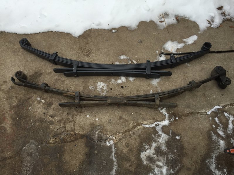

    It was a good day for the truck. Finally got the Dakars installed. Took me a little under 4 hours by myself in the driveway. A good 75% of that was breaking bolts loose. After soaking in PB blaster for a month it was still a struggle. 2 broken sockets, one chipped tooth and a fat lip later though, what a difference...
    Gave me about 3" more lift over the Toytec AAL and stock 3 leaf pack. I'm sure that will settle A bit. The billies are definitely the limiting factor in my rear travel now. Time for longer shocks and extended brake lines.

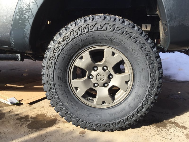

    Trigger also got new shoes. Cooper ST Maxx 285/75-16. Really happy with these tires after seeing them in person. Will be a great compromise between an off-road tire and a daily driver .

    Nice truck! You'll love the ST Maxx, I saw your photos over in the Maxx thread. You'll wanna get longer rear shocks for sure and make sure to get the stainless steel extended lines as well. That will also help with pedal feel.

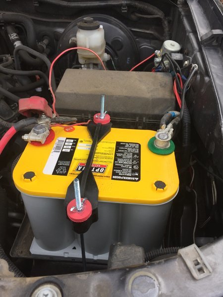

    Been meaning to upgrade the battery since I added the winch. Finally got around to it today. Optima yellow top.
    Now time to add a fuse block to clean up the wiring.
