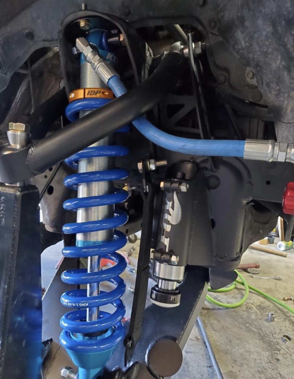

    35’s ready to go on along with the kit ! Hopefully this weekend !
    Pulled these out of a pile at work they’re decent. Gonna Mount them up and see if the little 3.4 will push them fast enough for if I’m gonna be sticking with 33’s
  9. Sep 25, 2020 at 6:01 PM
    #29
    Trigo
    Trigo [OP] Because fuck you that's why...
    Dec 21, 2011
    #69160
    7,053
    Rodrigo
    San Diego
    1st gen

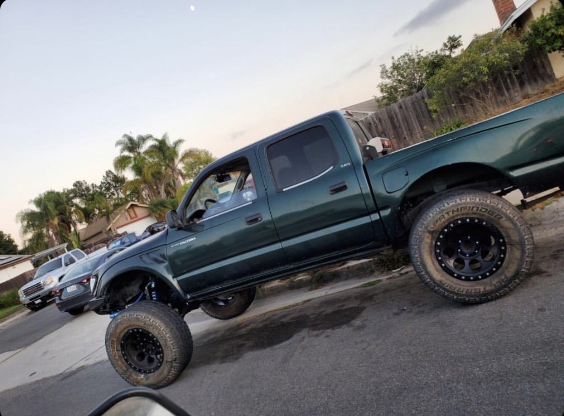

    Kit goes on this weekend. Mounted up the 35’s today for lulz they actually fit a lot better than I thought, sometimes I forget how high my truck sits with the lift spindles lol

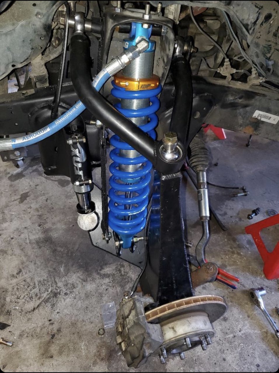

    Needs different coils but after having the kit and shocks sitting for months it’s just nice to see it all come together !
    LukeCC likes this.

    Definitely bro leaning a bit
  15. Sep 27, 2020 at 8:18 PM
    #35
    Trigo
    Dec 21, 2011
    #69160
    7,053
    Rodrigo
    San Diego
    1st gen
    Definitely need lighter coils ASAP lol fortunately the trucks not my daily so it’ll get sorted out quickly.

    Was that kit meant for longer shocks with custom coil mounts?
  17. Sep 28, 2020 at 10:23 AM
    #37
    Trigo
    Dec 21, 2011
    #69160
    7,053
    Rodrigo
    San Diego
    1st gen
    These are the shocks solo specifies in their kit I just forgot to inform them that I was gonna be running their spindles cuz I’m an idiot so they didn’t change the spring rate accordingly.
    Dalandser[QUOTED] likes this.

    Ah gotcha - when I read 5.5 over I was thinking like JD race kit but you’ve got a 3.5 with the spindles adding track width. What rate are the springs? Looks like you could fit an 18” spring possibly. If they’re not scratched you could trade them into King for the right ones.

    what’s rate do you have vs what you think it should’ve been to accommodate the solo spindle lift?

    Standard is 600 I believe. 500 from King or 450 / 550 from another brand would probably be the right spring rate.
