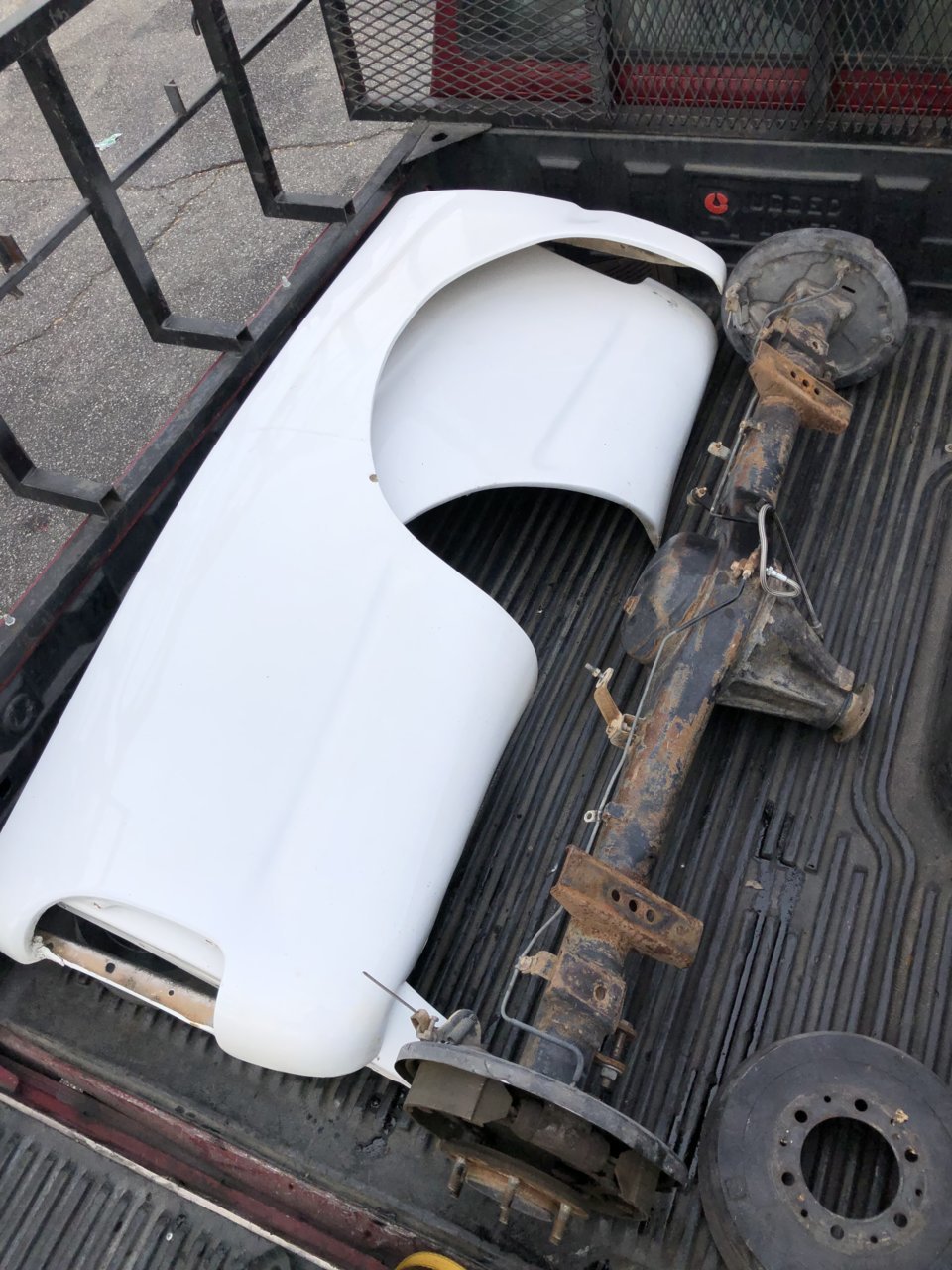

    Scored a solid deal on a tundra axle and spare bedsides thanks to @FlapJack935 !
    If I would’ve realized you were selling those bypasses too I would’ve grab them while I was at it I just saw the DR thread and I was like fuuuuuuuck haha

    can always ship them!

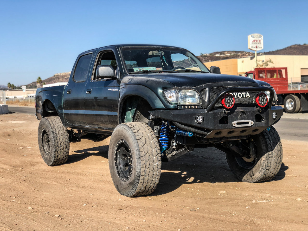

    Finished up the tundra axle swap today at work since it was slow !

    Love the stance, awesome truck. Do you know if it's possible to change the wheel bearings on the SOLO spindles, or do we have to have them service them?
