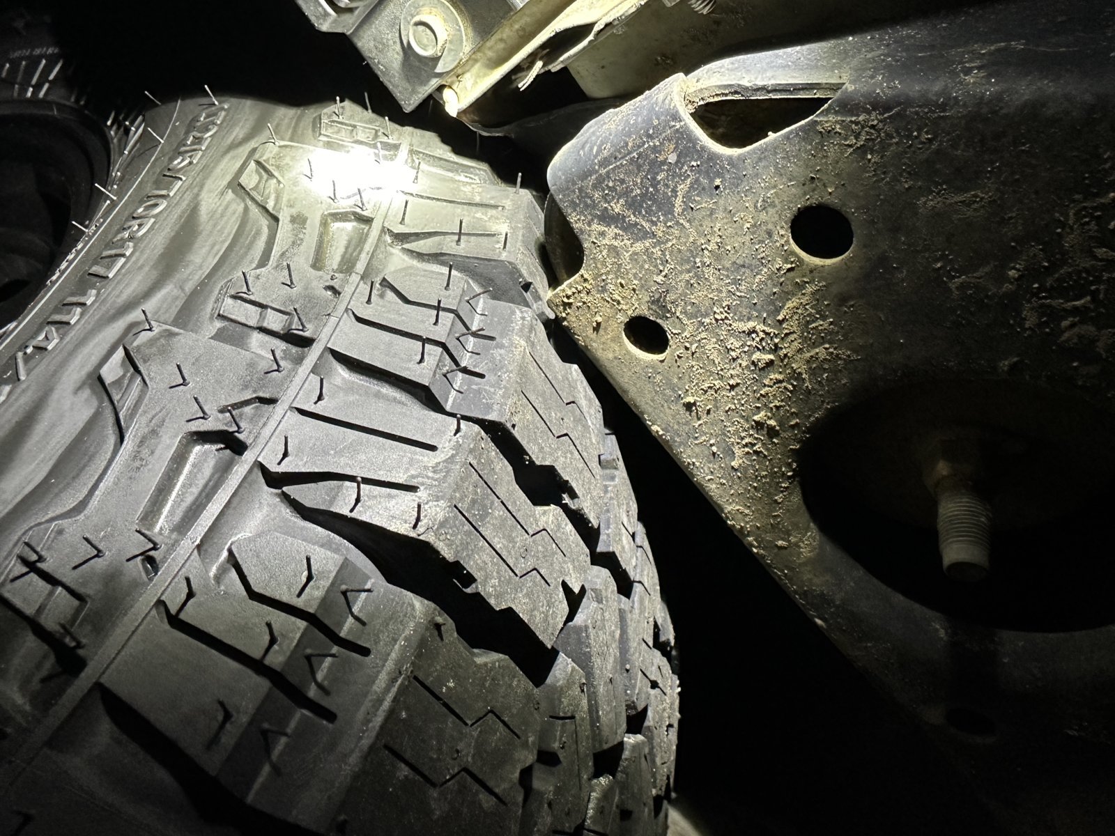

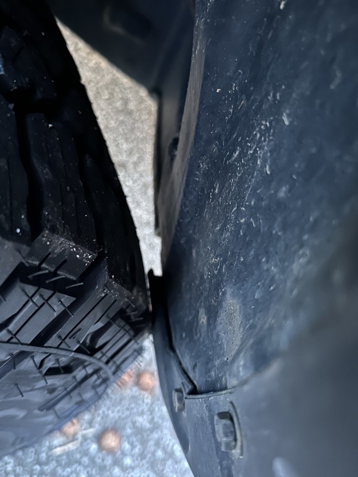

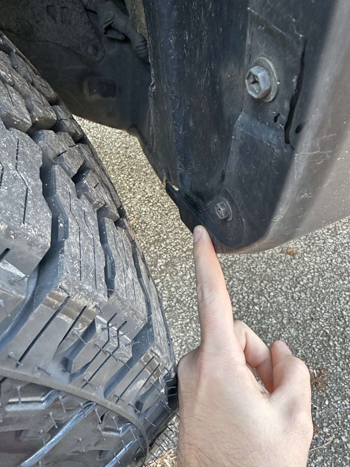

    Hey, yall
    got some new wheels / tires today. I’m on a 2.5” lift, and while I thought there would be no rub, I am sadly.
    Went with the Method 316’s (zero offset) + the Falken Peak AT4w’s
    Ive never trimmed nor do I have any experience with the cab/body mount chop. I was told that the folks that do alignments can somehow move things forward a touch? I’m curious if it’s worth doing that or, from my photo here, it’s not too hard to just trim back this plastic?
    It seems to rub when approaching full lockout but doesn’t rub at full lockout.. if that matters.
    Any thoughts are appreciated. For what it’s worth, I was running stock TRD wheels with Nitto Ridge Grapplers, at 265/75/16 with no issues at all previously.

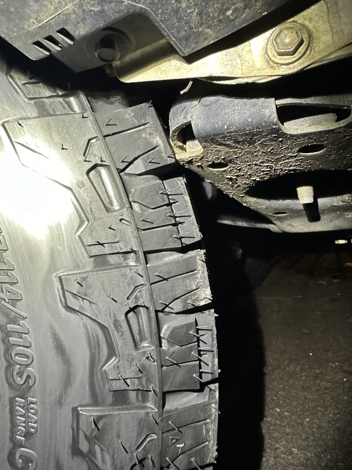

    So, and I continue to feel like an idiot, I think I am also indeed rubbing at complete lockout on the body mount. Though I didn’t hear anything, I had the Mrs do full lockout and got up under. While it seems to look clear, from under it appears to touch.
    Super bummed.. and unsure if an alignment can get them forward, or if maybe I’ll have to size down.

    Probably not. It looks like you don't need an inch though. I would think if you could get that LCA all the way forward, you would clear.

    I think you could get them to fit but it would be close with the UCAs you have. Once you max the LCAs out, you'll probably be out of camber spec

    So, if I trim the plastic, it’ll clear that no problem. However, if it slightly rubs the body mount, is that okay? Mind you, that would be at full lockout.
