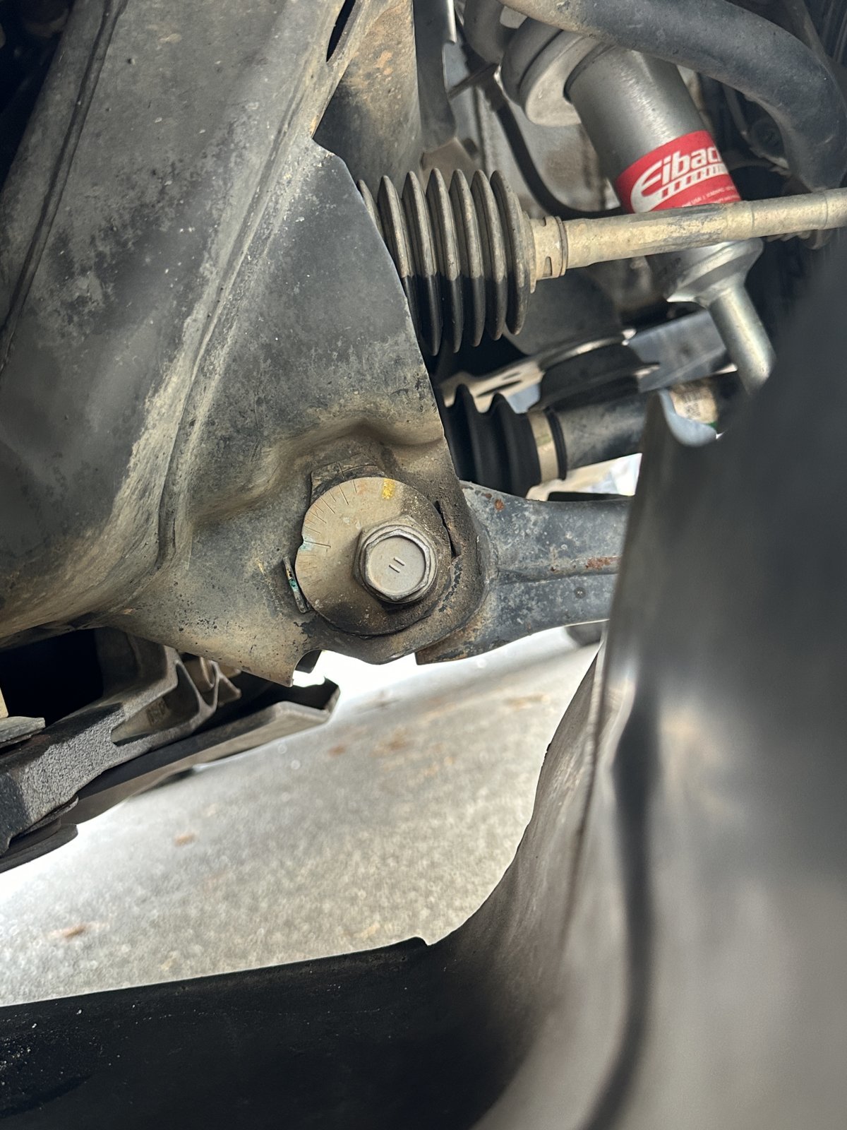

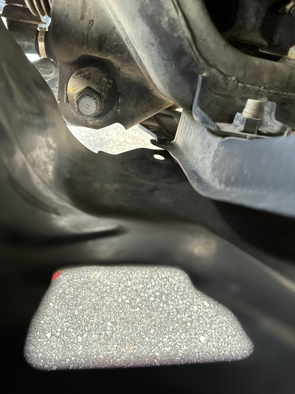

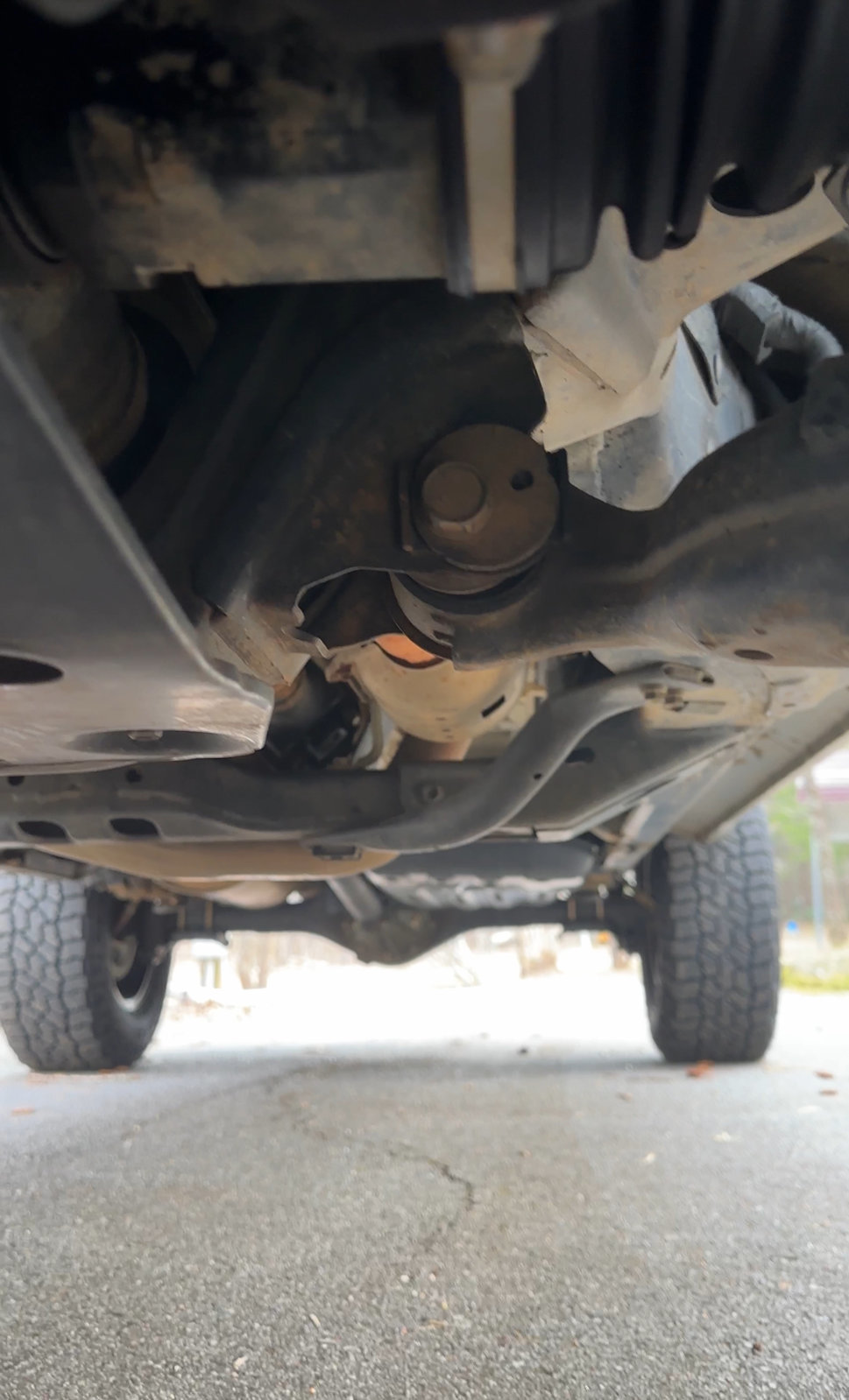

    These pictures. Are the Pass-R, Dr-R, Dr-Fr, Pass-Fr?

    I'll just add to this thread since I already posted up the pictures in the 275 thread. Trust me, I was in the no CMC boat probably 2 days before I decided that was going to be happening to my truck. Like everyone else in this thread has already said, it really isn't that serious or difficult. I am by far not a seasoned welder (actually been at it less than a month lol) and I did my own CMC and cut out my own plates. Also yes it was painful to cut up my 9 month old truck with less than 10k on it, but you know those 275/70s are worth the tiny pain since they look so good :thumbsup:

    Yep, sorry for the poor quality.

    If that's the case then you absolutely can get more caster. Those rear ones are 180* out from the position they should be in

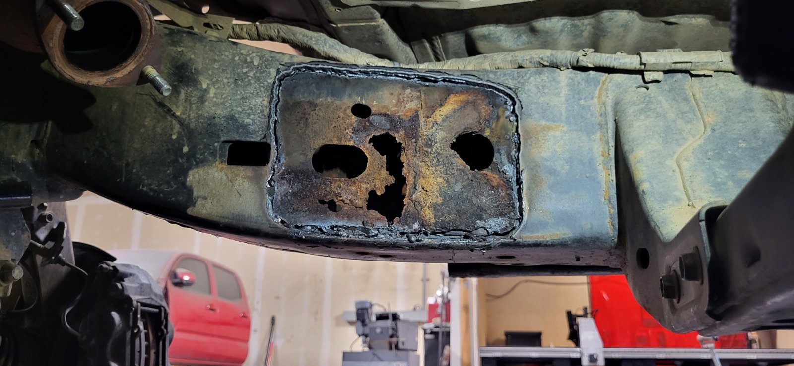

    3 tons of fun
    :anonymous:
    I ran mine hacked open without plates for years and used to be in the camp that plating was a waste of time that serves no function. I have no doubt that running them open funneled water and snow into the frame contributing to this delightful mess that had to be cut out and patched, directly opposite the cab mount on the passenger side frame rail.
    I have since changed my point of view on plating the cab mounts. It's not necessary, but it's worthwhile to do at some point to avoid this.

    So, front ones okay, essentially flip the rear? Just want to know when I go in Monday so I can at least try to explain it better lol.
    I thought I was maxed out, from my limited understanding of what I was looking at.

    I'll use your first picture which is a picture of the front of the driver's side rear cam (eccentric)
    The cam bolt is offset within the two end circles (the pieces with the graduation marks are on) Once you loosen the bolt going through the cam, you can turn the other cam side (the other side of the cams not shown in any of your pictures, where it looks like the end of the bolt is sticking out) which turn the cams against the thick metal tabs on both sides of the cam circle. As you turn the back of the cam (again, not pictured) the cam moves that LCA leg inward via the LCA bushing, shortening the arm or pushing the arm outward, lengthening the arm. As you do this, you change both caster and camber. The rear LCA bushing has more of an affect on caster than the front one, and the front bushing has more of an affect on camber than the rear one. To lessen confusion, I'm not going to explain why this is.
    So, back to the first picture, notice where the bolt head is. It is inboard, towards the body, meaning the bushing is drawn inboard. That circle cut-out in the cam, that is at about 10 oclock means it is almost maxed out inward (shortened) (if that circle cut-out was at 9 oclock the rear arm of the LCA would be at it shortest) You want those cut out circles to be inboard and the bolt heads out board, which would make the rear arm of the LCA it's longest. Once this is done, then you start adjusting the front ones until camber comes into spec and hopefully get it a tiny bit of positive camber since the camber spec range favors positive camber (-.03* to +1.2*) With a 2.5" lift and stock UCAs, I don't think this will happen though
    By looking at all four of you cams, in essence, you are the opposite of what you want for max caster as you rear LCA arms are almost at their max shortness and your front cams are more on the long side, with the driver's side a little longer than the passenger side.
    If you want, you can see the affect yourself. Just mark the rear cam position, loosen the bolt, and turn the side that looks like the bolt is sticking out. If I remember right, it is a 21mm. You would want to jack up the side your on a little (but not all the way off the ground) or else you'll be fighting against the weight of the truck. Also, the cam only needs to be turned 180* with the cut out circle and graduation marks going from 9 oclock to 3 oclock position staying up top. You can turn 360 but it's redundant.
    One more thing, when you turn the cam after loosening the bolt, it should move freely. If it seems stuck you may have a seized cam (the bolt seizes to the inner sleeve of the bushing) If this happens STOP as you will turn the cam circles into the tabs and flatten them out.
    Hope this helps and wasn't too confusing.

    Wow. This is perfect! Really gives me an idea of how to approach the situation, when I talk to the tech, and that’s all I need!
    Can’t thank you enough.
