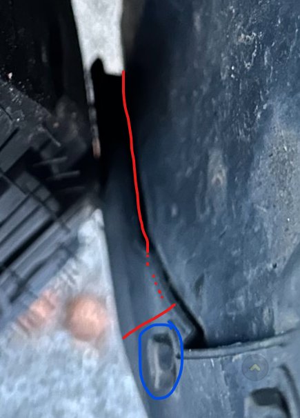

    Just going to CMC and get it over with.
  7. Feb 26, 2024 at 6:36 PM
    #67
    Tacompa
    Tacompa Well-Known Member
    Mar 10, 2019
    #286094
    238
    San Jose, CA
    2019 Toyota Tacoma OR DCSB 4x4
    I just put 285/70/17 K03s and it was rubbing in the same area as you, especially when making right and left turns into slight dips (like into a drive way). You will need to do some minor trimming. After trimming the red area with a multitool the rubbing stopped. FYI, my driver side one cracked a bit at the bolt in blue and the fender flare towards the bottom where it adheres to the painted fender has come off the double stick tape. I still plan to do a CMC for the added off road clearnce but at least the minor trimming prevents any further damage to the fender flares.
    Running ICON UCA; chamber = 0.3 and caster = 3.6 for both sides.
