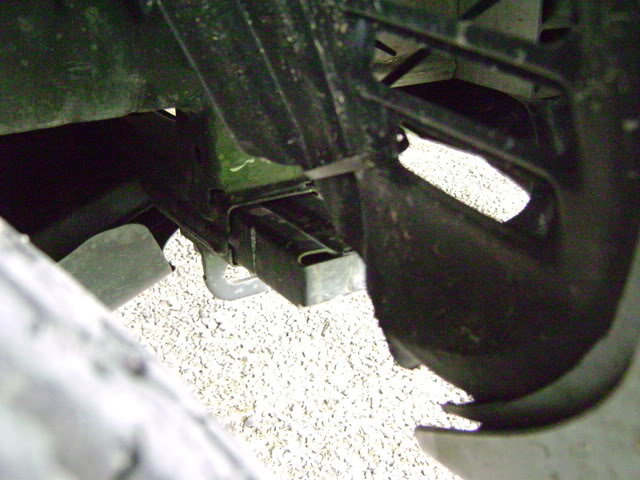

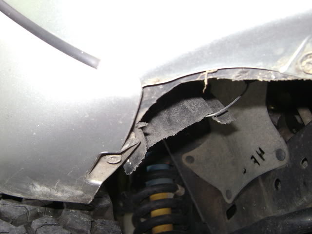

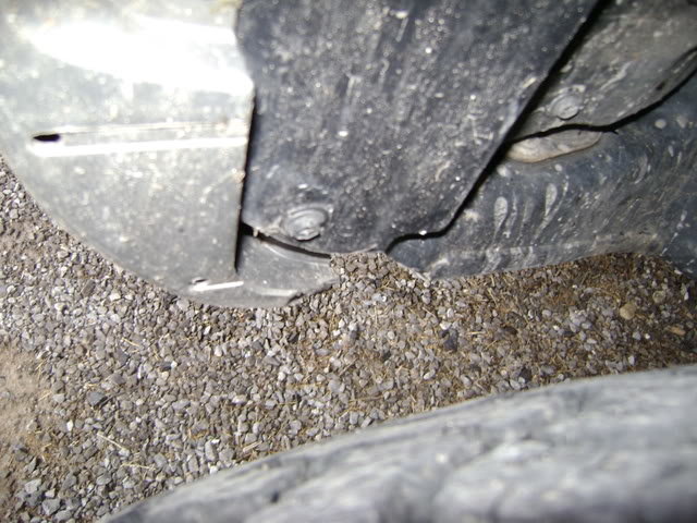

    You could do some trimming first. Every tire will be slightly taller/shorter.
    You could do all this cutting with a razor knife.
    First off I removed the big square nub in front.
    Where I cut and zip tied to make sure it wouldn't rub.
    Here is the little bit I had to trim near the firewall. Drive a little and cut.
    I don't disagree with chris but that damn nub will make a helluva noise, mine did.
    Hope that helped.
