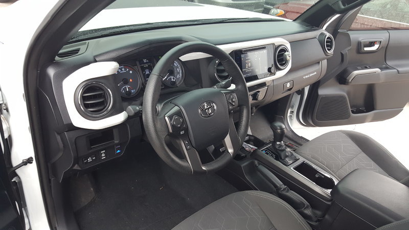

  18. Jan 16, 2017 at 2:13 PM
    #18
    VangaSTL
    VangaSTL [OP] Well-Known Member
    Oct 27, 2015
    #167889
    3,602
    Garrick
    St. Louis, MO
    2016 TRD Sport 4x4
    Here is what I have done so far, It's the trim around the radio unit and guage cluster. I'm having them professionally painted so its not rattle canned. It's very clean looking and color matched to the exterior. I think it looks great so no I don't regret it at all. Besided I've owned the truck now for over a year. The "new" effect is wearing off and its time to change some things up :thumbsup:
