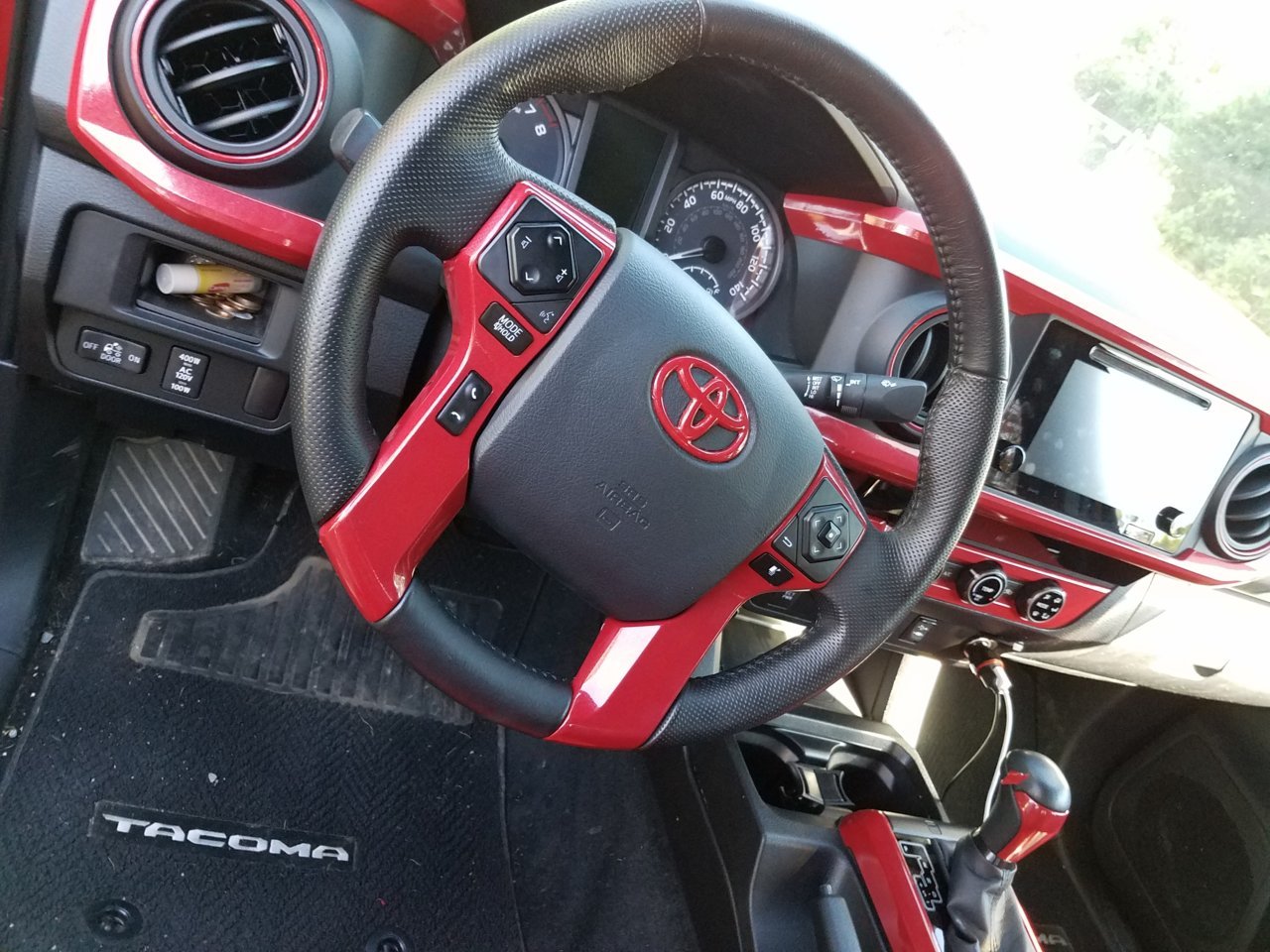

    I wrapped my trim in vinyl. It's not 100% perfect but I'm pleased with how it turned out
    This thread was immensely helpful in getting things torn apart

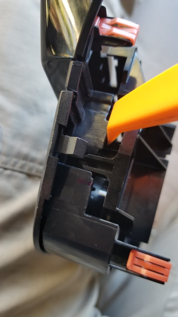

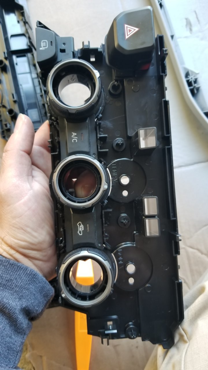

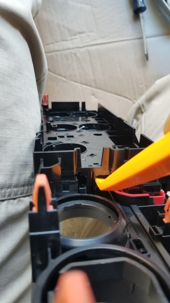

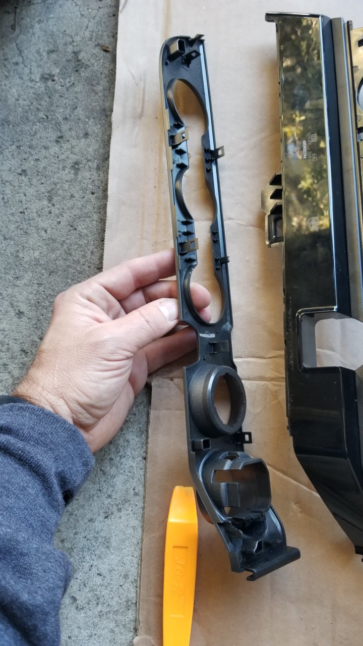

    The mystery everyone is wondering... How do you get the HVAC panel apart. Stumbled me for a couple hours. I pried it gently at the points I have my soft tool and it popped apart..

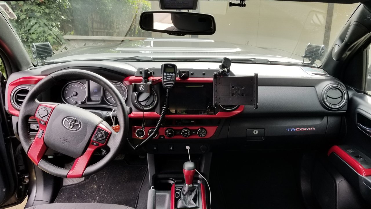

    Here's the finished product on my truck
