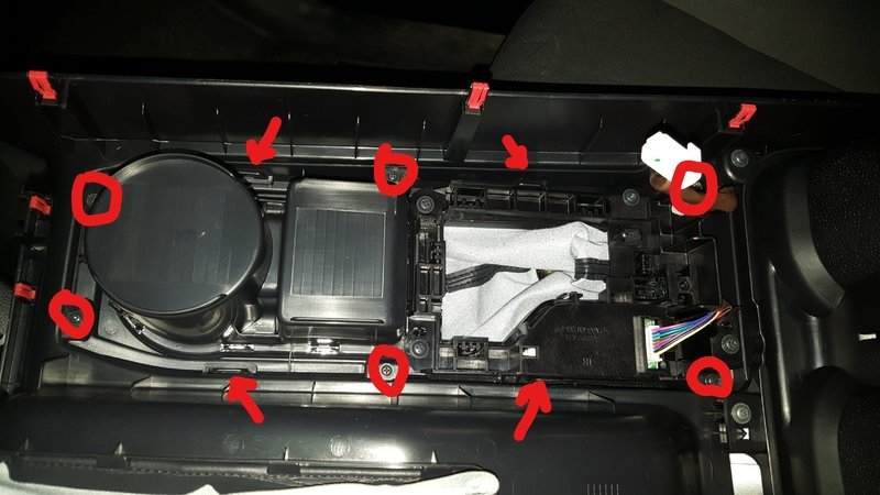

    OK, so for anyone interested, I'd like to share my findings on how to remove the center console trim and steering wheel trim. First I'd like to credit @gpb and @SgtAJV for their help.
    FIRST, IT IS ALWAYS RECOMMENDED TO DISCONNECT THE NEGATIVE TERMINAL OF THE BATTERY
    Center Console:

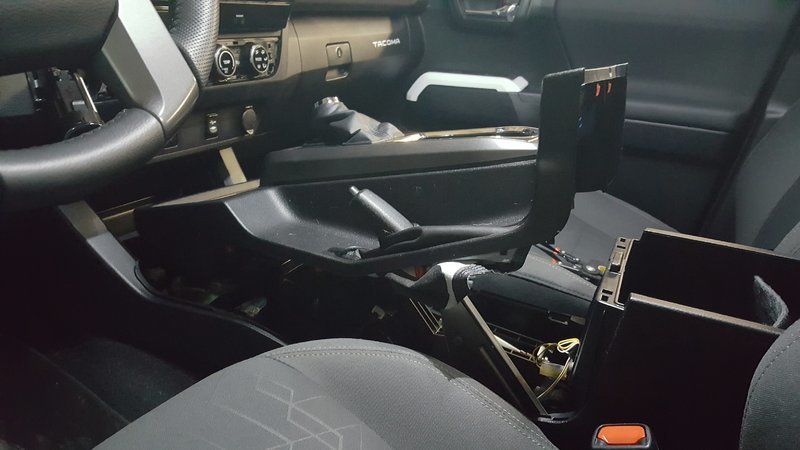

    Unfortunately the trim piece does NOT just pop off like the center dash trim. You have to remove the whole upper assembly. First you have to remove the shift know and then the assembly is just held down with plastic tabs so I started by the qi wireless charging pad and used a trim tool to pry it straight up. I then worked my way back. Make sure the arm rest is unlatched and in the open position.

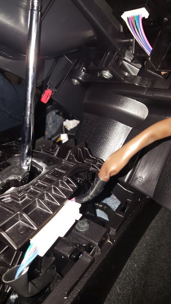

    On the passenger side next to the gear shift, there is some wiring that needs to be unclipped.

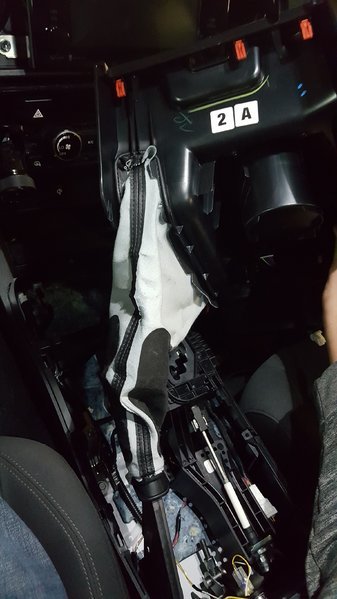

    The gear shift boot just slides off the chrome gear stick but the parking brake doesn't, I just inverted the boot to give me the most amount of play.

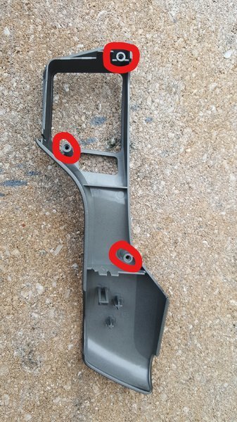

    On the under side of the assembly, there are 6 screws (circled) and 4 tabs (arrows) that hold the trim piece in place. Undo these and the trim piece comes right off.

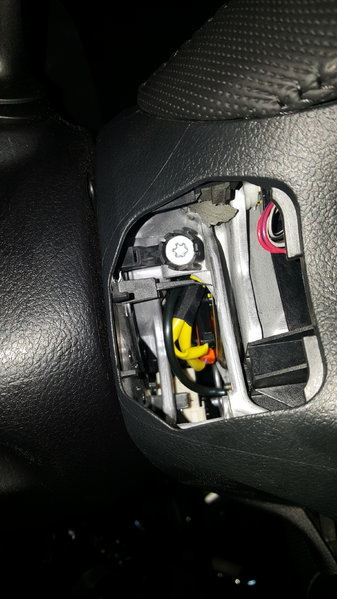

    On either side of the steering wheel, there are 2 access caps. These just pop off and inside each side is a single T30 torx screw. Undo these. Don't worry they don't fall out, they are held in even when unscrewed all the way.

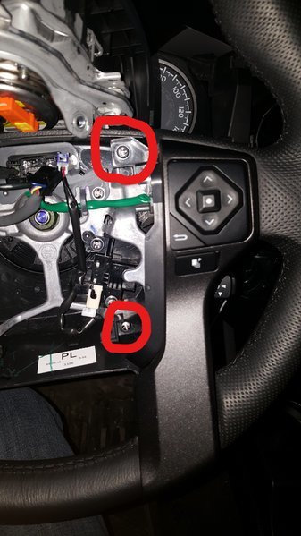

    Now the steering wheel cover/airbag assembly lift right out. There are 2 screws that hold each control assembly to the steering wheel. These need to be undone.
    Once lifted out, there are 3 screws that hold the trim to the control assembly. Undo these but be careful because the assembly falls apart very easily and there are some plastic spacers that act as extensions for the buttons to hit the circuit board. Be careful not to lose any of these.

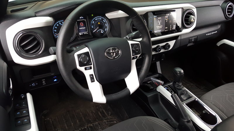

    I thought I would share with everyone the finished product. Thanks again for those who helped me out.

    The shop did a great job on those for you! Makes them look not as cheap.

    After it was all said and done it cost me $220

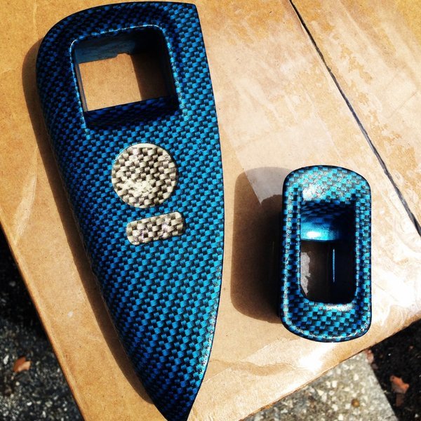

    I wonder if bbp would look weird, that white looks great, might have to copy you on my bbp taco.
    Maybe blue carbon fibre hydrodip! Any thoughts?

    TBH I'm not a huge fan of carbon fiber, I think it looks a little gawdy. BBP would look super clean. I would recommend thinking about it long and hard before painting. Its a permanent modification. I would do a little bit at a time to see how you like it. I also wouldn't do too much. A little bit goes a long way. Even mine is borderline too much. My painter started suggesting other pieces to paint and I told him to shut up because I think anymore and it would look overdone

    I'll second Vanga's comment about the carbon fiber look. If it's the real deal I think it's not too bad (a bit early 2000's though) but the print just seems kinda tacky. But as always, it's really whatever does it for you!
