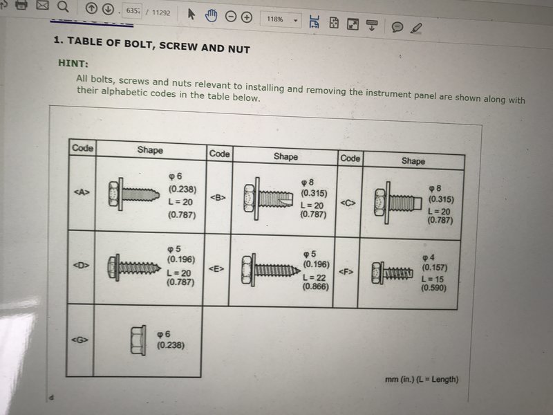

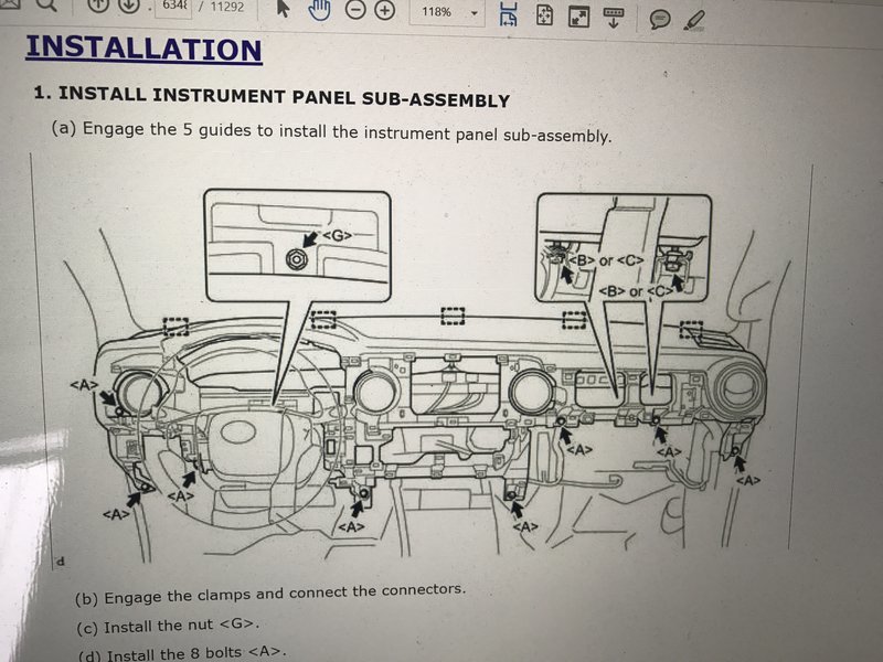

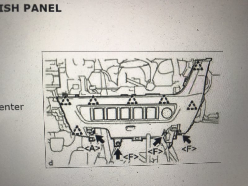

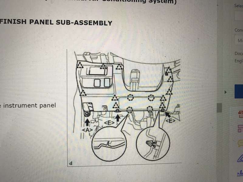

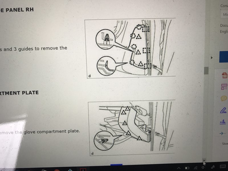

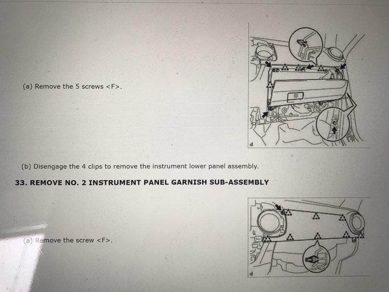

    Thought this may help!

    I will update with the rest later, including passenger hvac if there is one.

    Is that anything behind the Garnish on step 33?

    Not really, but i didnt want to bugger anything up so i just kept removing trim till i was comfortable to install my peice.
    You could get away with loosening glovebox, and panel below. Removing centre console/shifter trim and the peice under the steering wheel. Which i broke a clip on and am very upset about. I also could not get the glovebox completley out for the life of me. I think there were 2 hidden nuts up and behind.
    Like i said, i will post with more info later i could even create a trim removal pdf with all the fsm pages for trim removal.
