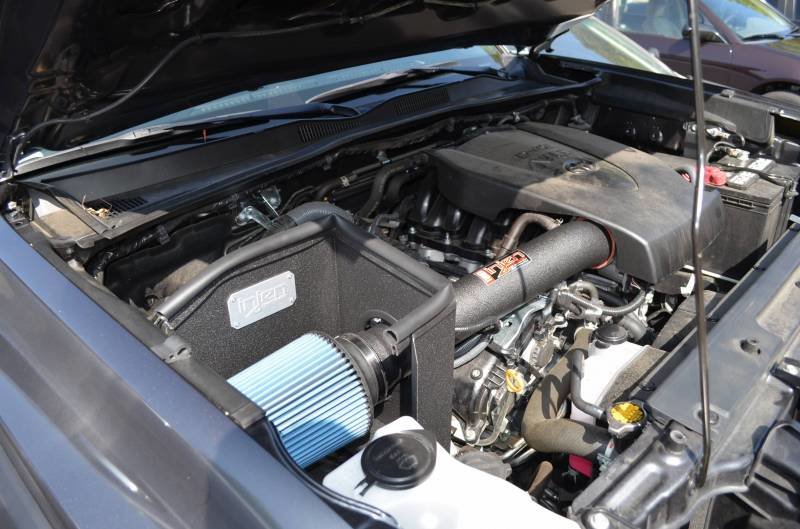

    To start I have trimmed fenders to accommodate 35's that I did over the summer, now that winter is here an we have rain/snow storms regularly I am starting to get more concerned about water getting into my intake. I make shifted my stock fender liners to somewhat work but it's still concerning. Of course with trimmed fenders you lose the fender liner that protects water/debris from entering the side orifice on the inner fender for the intake.

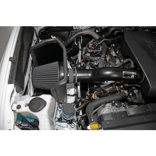

    I've seen a few post here about some folks going about with routing their intake tubes into the cowl but I think a simple CAI setup and blocking off the intake orifice seemed like a cleaner setup. I came across a response in a post here (#15) from @90yota who used a K&N CAI an blocked off the fender intake hole with some plexiglass? and drilled some small holes in it for some airflow, which I thought was a pretty good idea and I want to do something similar.
    I have preference to use a dry filter over an oiled one an came across a few options including the K&N Blackhawk Dryflow CAI and the Injen PF CAI an I wanted to get some thoughts and/or feedback on them. There is a little bit of info here on the K&N Blackhawk, some good some bad, but I couldn't find anything on the Injen PF. Anyone have experience with Injen or anything good or even bad to say about them?
    I also noticed the K&N has a filter that has a 6" inside flange diameter vs the Injen has a 3.5" so seems a little bit more restrictive but still seems on par with the factory intake tubing size. Injen also offers hydroshield covers for their filters which is nice but I'm sure I could find one for the K&N as well.
    Also I am not looking for any gains here for HP, TQ or MPG's. Merely just looking for a clean solution for the intake due to my trimmed fenders. I would prefer to keep utilizing the stock intake but it has obvious draw backs with trimmed fenders and I'm not a huge fan on the cowl mod intakes but maybe that is a better option than the CAI's?

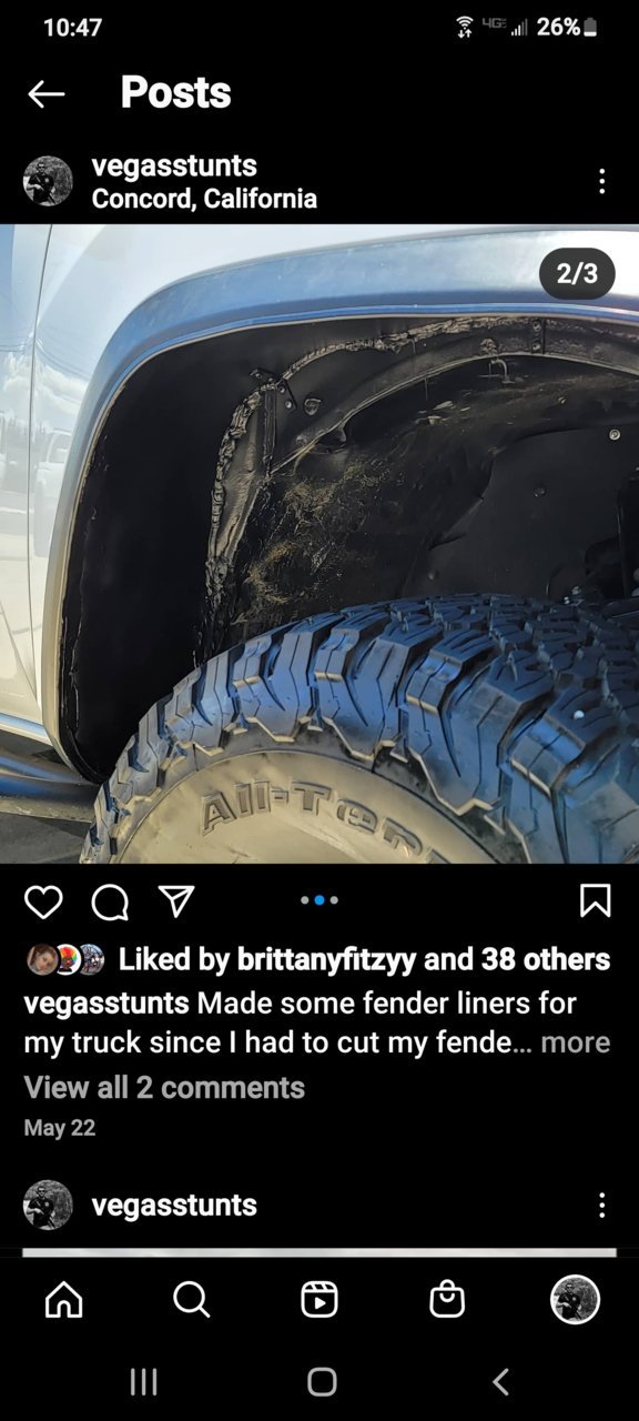

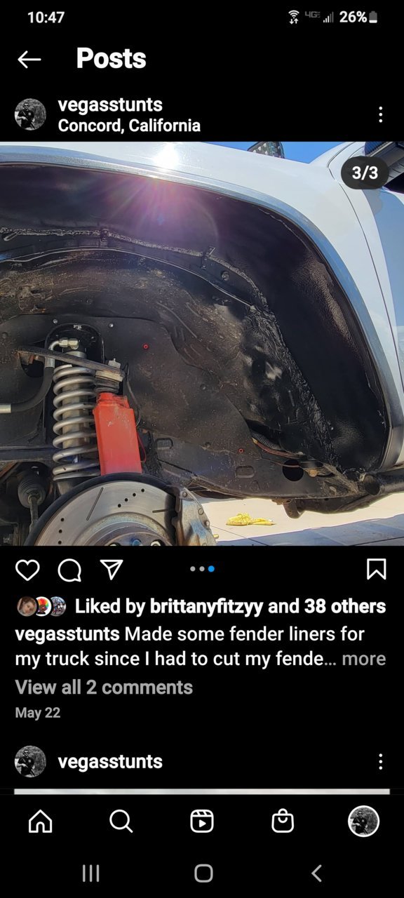

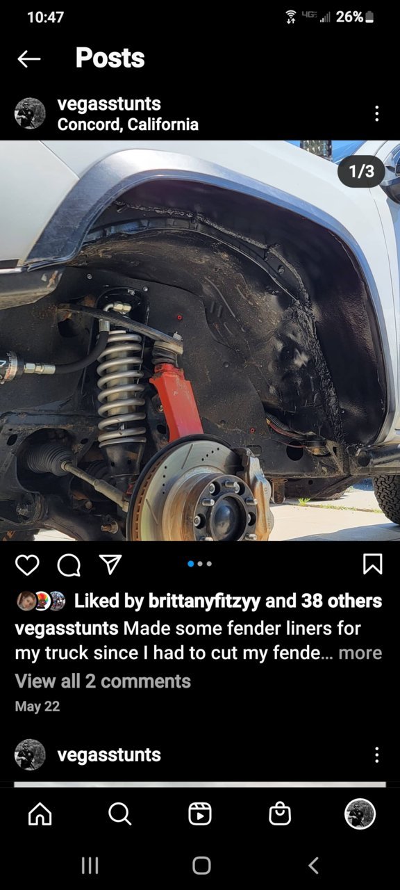

    Some home made inner fenders. Took a little ingenuity but wasn't hard. Sorry fkr my insta screen shots. Only place i had the pics saved. Screenshot_20211223-224735_Instagram.jpg Screenshot_20211223-224744_Instagram.jpg Screenshot_20211223-224740_Instagram.jpg

    Nice that looks good, what material did you use if you don't mind? Looks like you also put silicone around the edges of the fender side to create a seal?
    A little worrisome but looks like the post above yours did just that.

    It's a sheet of plastic used in bathroom walls. 4x8 sheet from home depot. Then some automotive seam sealer to seal it all up.

    Sweet deal thanks, will look into that. Honestly looks factory to me and get to keep the stock intake so I'll probably do something along this route instead.

    My plexiglass started to get brittle and crack after a while so I would recommend just doing metal. It was cool that it was see-through but honestly not worth it breaking all the time

    Nice I came across those after looking into aftermarket fender liners now, solid product but its looks like they're all sold out at the moment but they definitely look easy to work with.
    I couldn't see the plexiglass holding up long term, metal plate would for sure be better.
