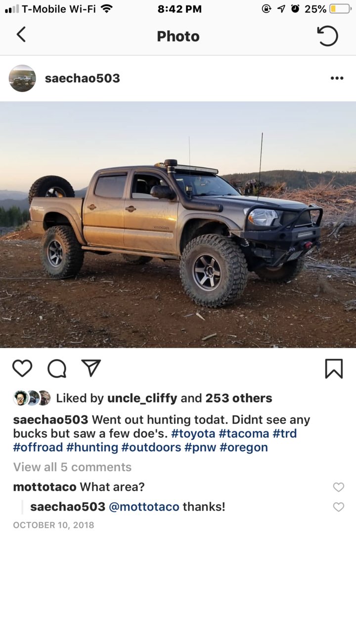

    I want to trim my fenders like this but a little lost can anyone help?

    I left tabs to reattach the inner fender liner. I took off 2 1/2 inches

    ok thanks but did you remove anything or does it come out clean if you just cut

    Just remove the inner fender plastic. Mark your cut, and have it.
    I didn't re install the flares. I just put some edge trim on the cuts, and left it. I will be doing a flexible flare when it warms up.
    Also, since you're removing the inner fender, your air intake will be exposed. Be sure to relocate that.
