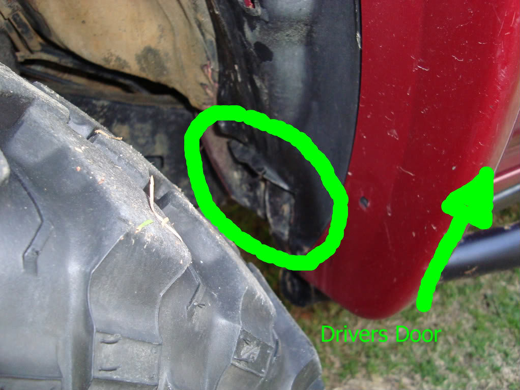

    its up to you which tires you go with
    you should be able to fit the 285/75s BUT you will probably have to do some minor trimming of plastic liner...and you MAY have to hammer down the pinch weld at the back of the fenderwell

    the trimming you'll have to do wont be noticeable...itll all pretty much be the black plastic fender liner...and the hammering of the pinch weld will be unnoticed too
    hold on i think i have a pic of when i did mine

    its not hard
    i did it without even removing the tire...
    just trim the plastic and then use something to bend the pinch weld back so that it sits flat or almost flat...spray paint black

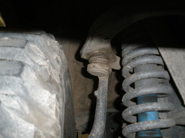

    how wide are they? whats the size? im postitive that ill be able to get them in there and i know ill have to trim in some places. the only thing im worried about is hitting the UCA's.

    Here's how clearance I have with the spacer. Wheels will eliminate the need for the spacer.
