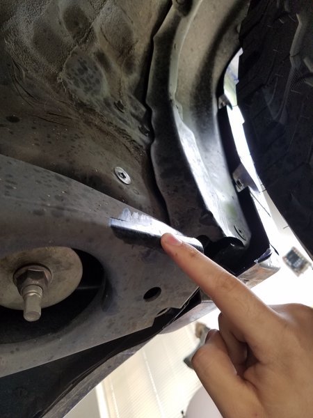

    Going to pick up some metal cutting blades for my rotozip. I was just curious if anyone has had to cut thru this part from tire rubbing...?

    I believe its called the cab mount chop or CMC on here. search that and see if you can find threads on it. its been done many many times by people on here. @scottalot just had it done this past weekend.

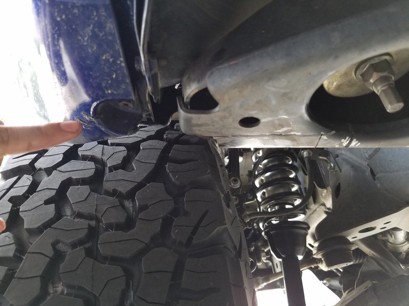

    Look up Toyota Tacoma Cab Mount Chop. Many people have to cut that part to be able to clear 33" and up tires from rubbing that spot. Best is using a cutoff wheel on your grinder. A few companies like BAMF and Pelfreybilt make plates that are CNC cut out to weld back over it to make it look factory.

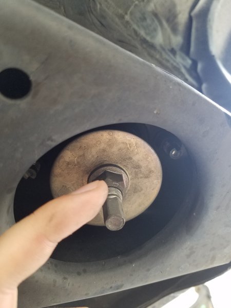

    It's not something I'll be looking at. Just wondering if was safe and I won't be damaging whatever this bolt is... if I left the metal part open after cutting

    Ill look into the metal cover just wondering if its okay to drive without it for now

    I drove without mine for a year, I think you will be fine. Mine was also hacked in half basically.

    Just remember to paint where you cut because it will rust otherwise.
