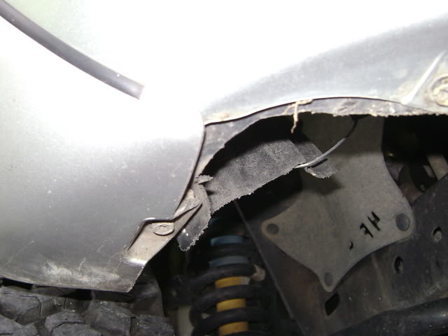

    Towards the cab I had to trim slightly. Now that I have removed the swaybar and installed new UCAs I have trimmed more.

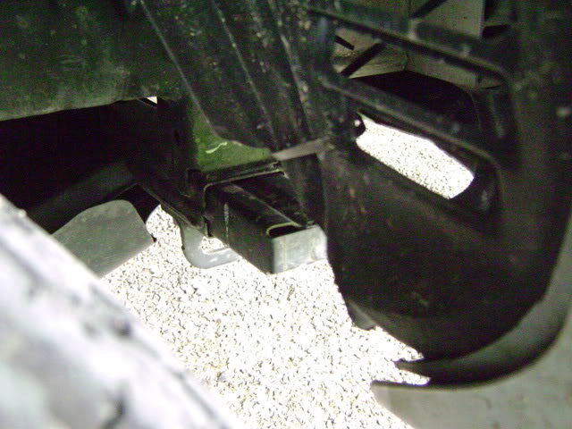

    In the front the big square nub.

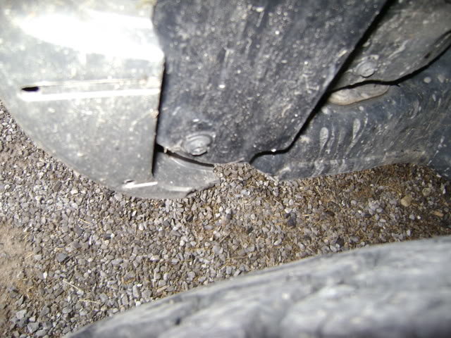

    Here I cut some and zip tied it back to make sure it doesn't move.

    Not a problem. All the trimming was done with a razor knife. I actually just trimmed some more yesterday.

    Should only take 10 minutes if you go slow as to not cut yourself. Pretty similar for all our trucks, however depending on tires (their sizes differ) some rub more than others. Turn your wheel as hard as you can to one side to see where to cut, then turn in the opposite direction and trim there.
